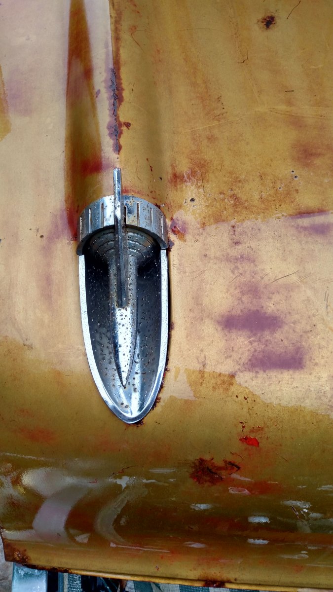

    Yeah, no help on the electrical switches. Also be informed that the rocket scoops are specific to left/right. Get em wrong and the rockets point to the outside 15280532946311079250512.jpg

    Wow thanks 57dude! Butch has also generously offered to help too ...you stateside guys are awful nice...but I do have to consider things like shipping and travel time cuz I'm on a shoestring lol! on the other hand early on I got took real bad by our main local '57 guy on a front seat I ended up having to throw away so he's not getting another penny from me:mad: if I cant find it elsewhere and need it bad enough I'd carve it outta wood before I gave him another dime...

    Ha ha good to know! i'll have to figure out which I have or buy a pair....the switches I want to buy new just because i'll be using mostly original wiring...and I had no keys so i'll get a key with it and I've heard you can take apart the door/trunk lock tumblers to fit any key

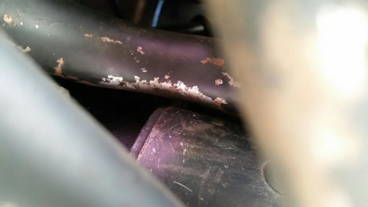

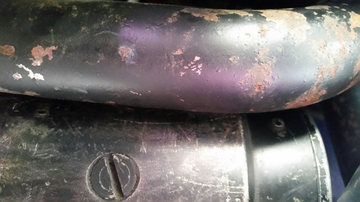

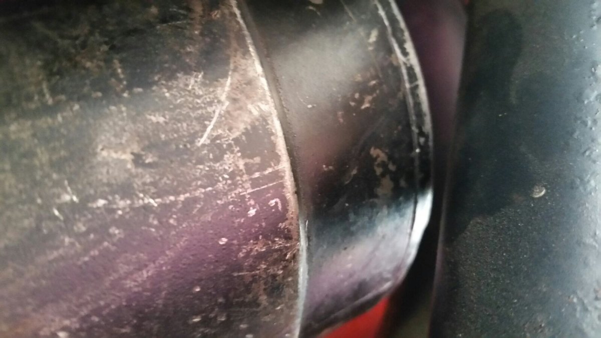

    57st.jpeg 57st1.jpeg 57st2.jpeg So I know it has been great weather for a while and no updates... I kinda lost the wind in my sails after wrestling the p***enger side header in and out of the car multiple times after realizing one of the tubes would be resting right on the starter. Big deal right? well I can only actually lift the car on blocks and jack stands so high before it gets scary A.F. so I have just enough room to wriggle in and out if I was 20 years old no problem but now...it ****s! So the problem is getting a 3' header in and out of a 1.5' space (if that) to test and refit over and over again. Did I mention that the starter also has to be removed to pull the header and vice versa?:eek::rolleyes: or the time I tried hammering it partially pulled under the car so I didnt have to unbolt everything again? jeezuz that would've made a hilarious video with my whole 2"s of swing room!! funny except at that angle nothing short of swim goggles can keep **** from falling in your eyes! I don't know how long the starter will last but I now have a thin gap around it at least:p...one tube's millimeters away from the p/g case and the centrelink seems to hit another tube at full turn so there's more fun to be had!

    i have a "hammer" head and a blunt chisel for my air chisel that i use to persuade things in hard to reach areas. small "blips" can work magic with sheet metal.
