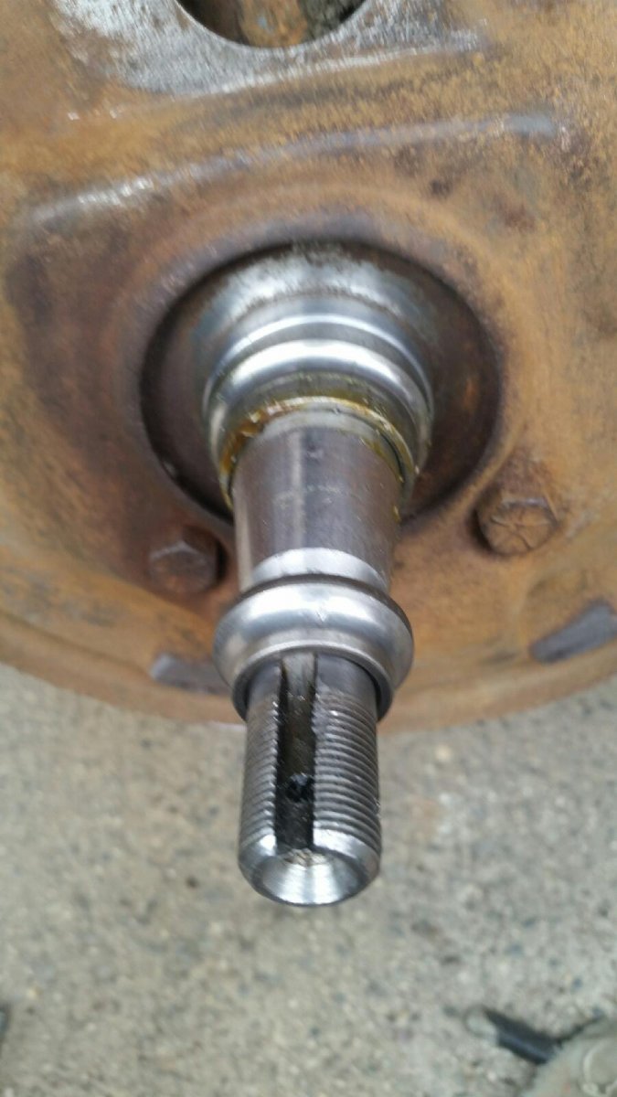

    anyone see an issue here?
    Yep some numbnut put that outer race on ***backward o_O...then cranked on it til the washer was bowl shaped:eek: yes there is also a divot in that race and I have no good extras:(

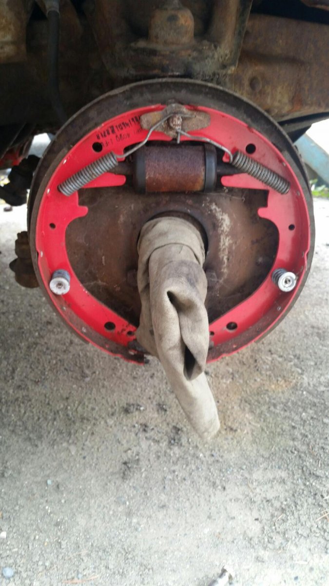

    Or here?
    Yep two short shoes on this side...two long on the other o_O :rolleyes:

    Front spindle, outer? That's what it looks like. Let us know..
    Nailhead A-V8 likes this.
  18. Nailhead A-V8
    Joined: Jun 11, 2012
    Posts: 1,480
    Nailhead A-V8
    Yes it is... the one I have has that rough spot shown in post #93 I don't really want to run it but not as much as I don't want to pull the whole ****eroo apart for new bearings and seals...yet. I will eventually or do a disc conversion but for now that and a few other little bits will put me on the road
