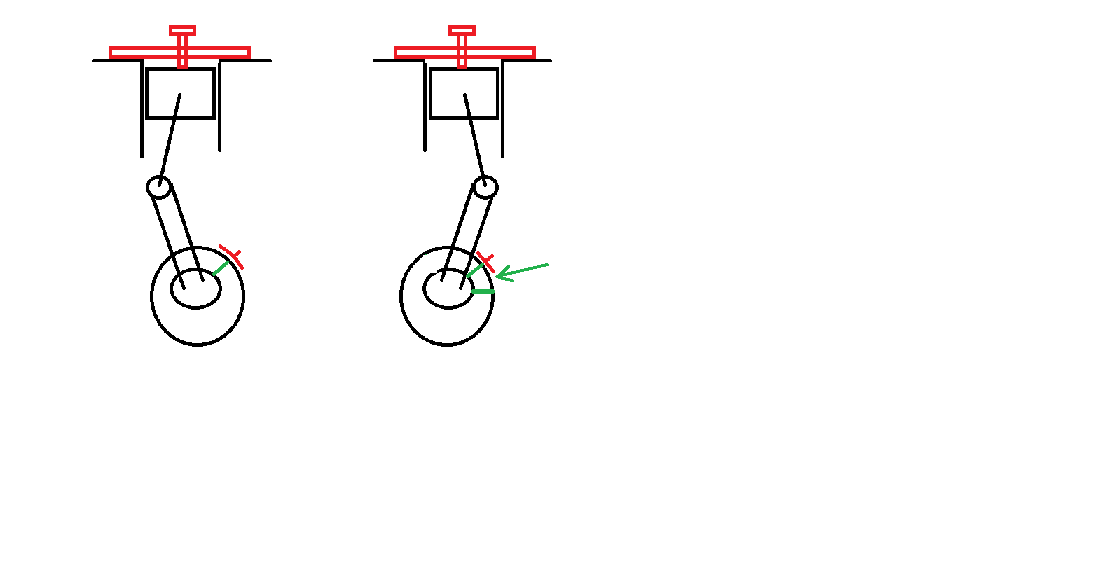

    This is what I planned to do. Rotate engine both directions until it touches stop. Mark balancer at the zero timing mark. Center between those marks is TDC. If the center point does not correspond to the line on the balancer, then align the line on balancer against timing tab zero and read degrees my true TDC mark is off and adjust tab.
