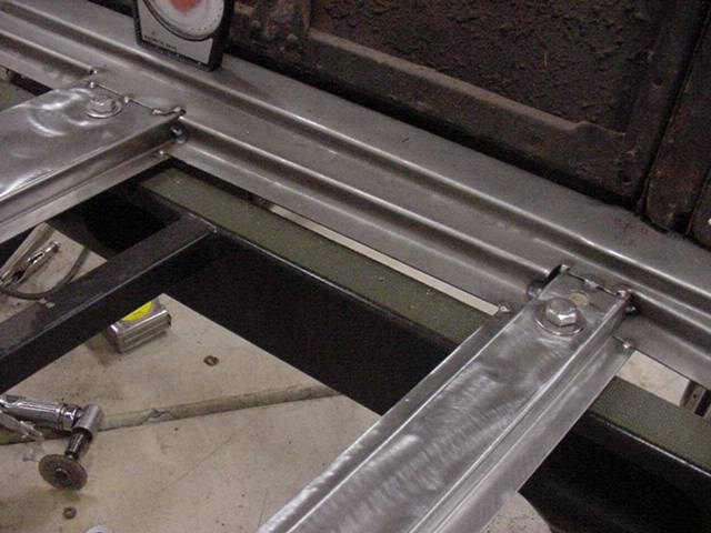

    Thanks for all the encouraging words and ideas guys. I am using a reproduction wood block kit that I bought from wescotts. The insructions say to sand the blocks down until they are flush with the bottom of the cross channels. I have not done this as of yet because the blocks are all shaped differently on the frame contact side and I am assuming there is a reason for this. The more I look at the problem though the more I think that bringing the front two cross channels down until they touch the frame would help a bunch if not solve the problem all together.
    The body will be highboy style and the body is not yet chopped (I wanted to get everything right before I started on the chop). The frame is custom built frame that was built at a local shop about 5 years ago. It measures up square and level. It has been z'd in the rear about 6" and the subrails have been modified to clear that portion of the frame. I'll try and post some pics in a bit.

    In this pic you can see the gap between the frame and sub rail cross channels.

    sounds like your cowl is tweaked.... bolt the cowl down without spacers, push and pull and get your hingeposts,striker posts, and firewall to be 90 degrees. you will want all your pillars to read the same with your inclinometer..... Ive been there.......... LUKESTER

    On my bro's Model A (28 though) the wood blocks are NOT shaved down to level with the subframe. His ORIGINAL HENRY wood blocks hold the subframe up approximately 1/4" off the frame. Don't know if Wescott is wrong or 30's are different, but it's something to consider.
    alchemy

    How about a profile shot with the whole thing in the picture taken from frame level?
    Can't tell whats going on with just details of small areas. [​IMG]
    It's possible you have it too high in the middle.
