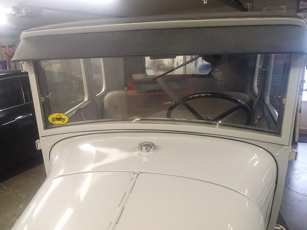

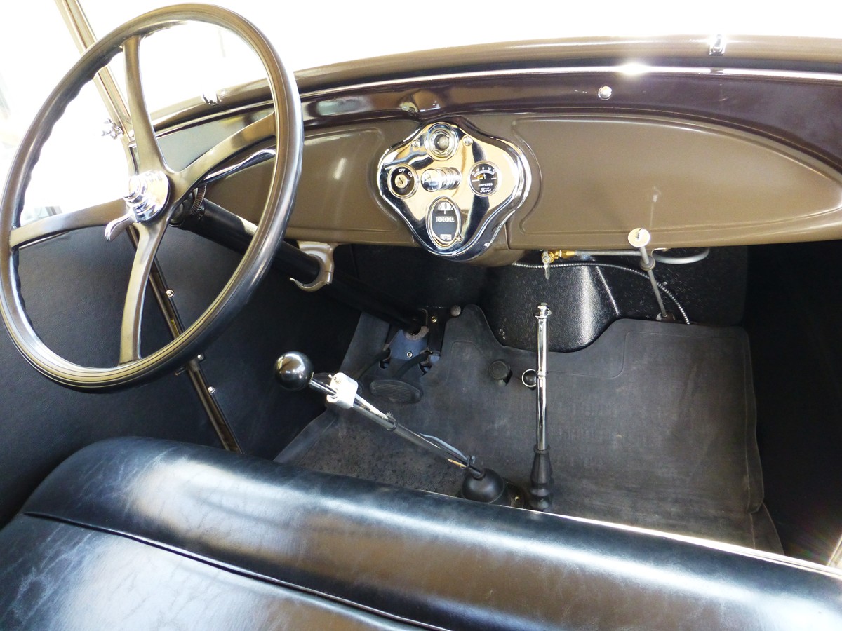

  8. Model A Gomez
    Joined: Aug 26, 2006
    Posts: 1,840
    Model A Gomez

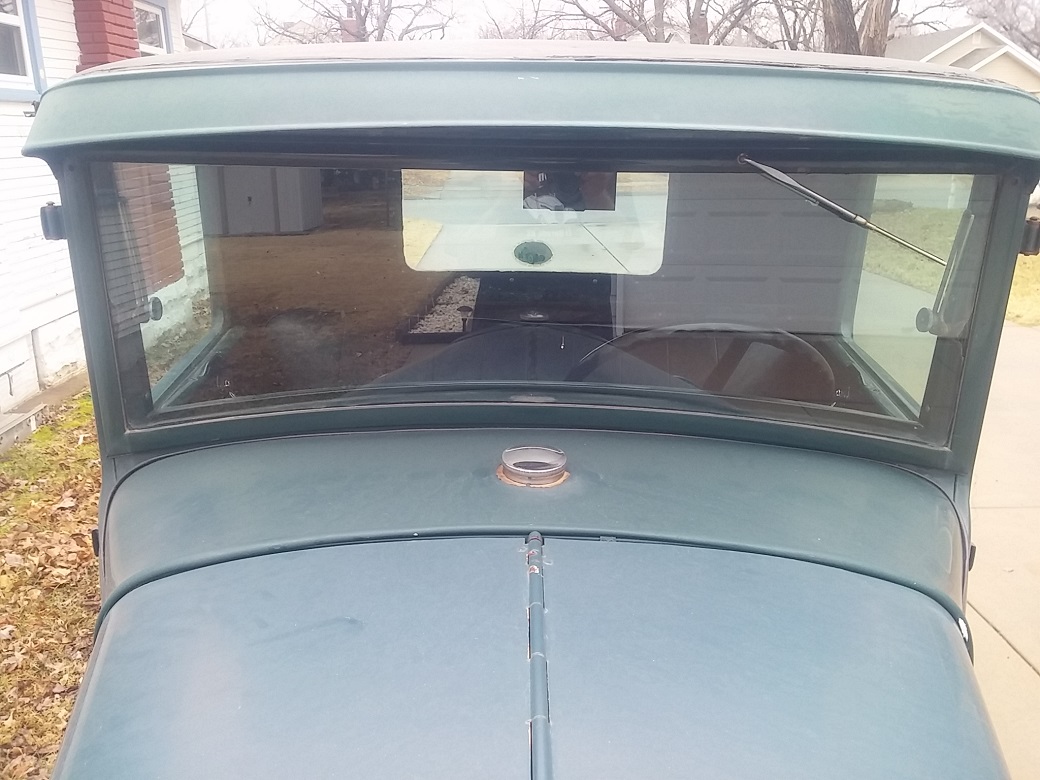

    Went to the garage and took a couple of pictures, in the picture of the green pickup you can see where the lip on the windshield is in relation to the dash rail, about 1/2" below the rail. On the primered 30 sport coupe you can see the dash rail is tight on the arched piece between the pillars and the inside in is shown the other picture. I also included a picture of my 29 coupe and the windshield is taller and won't fit a 31, but don't think the dash rail would cause a problem.

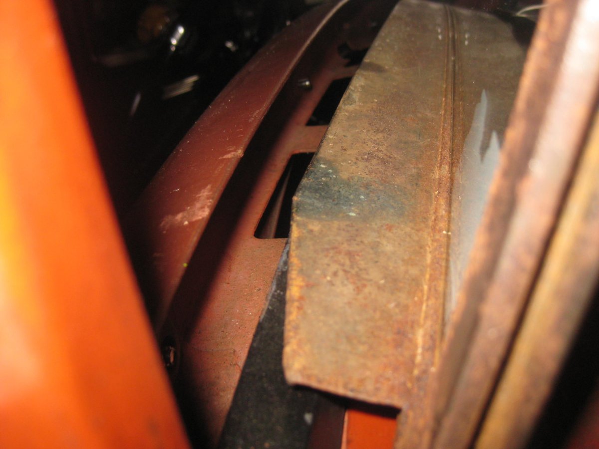

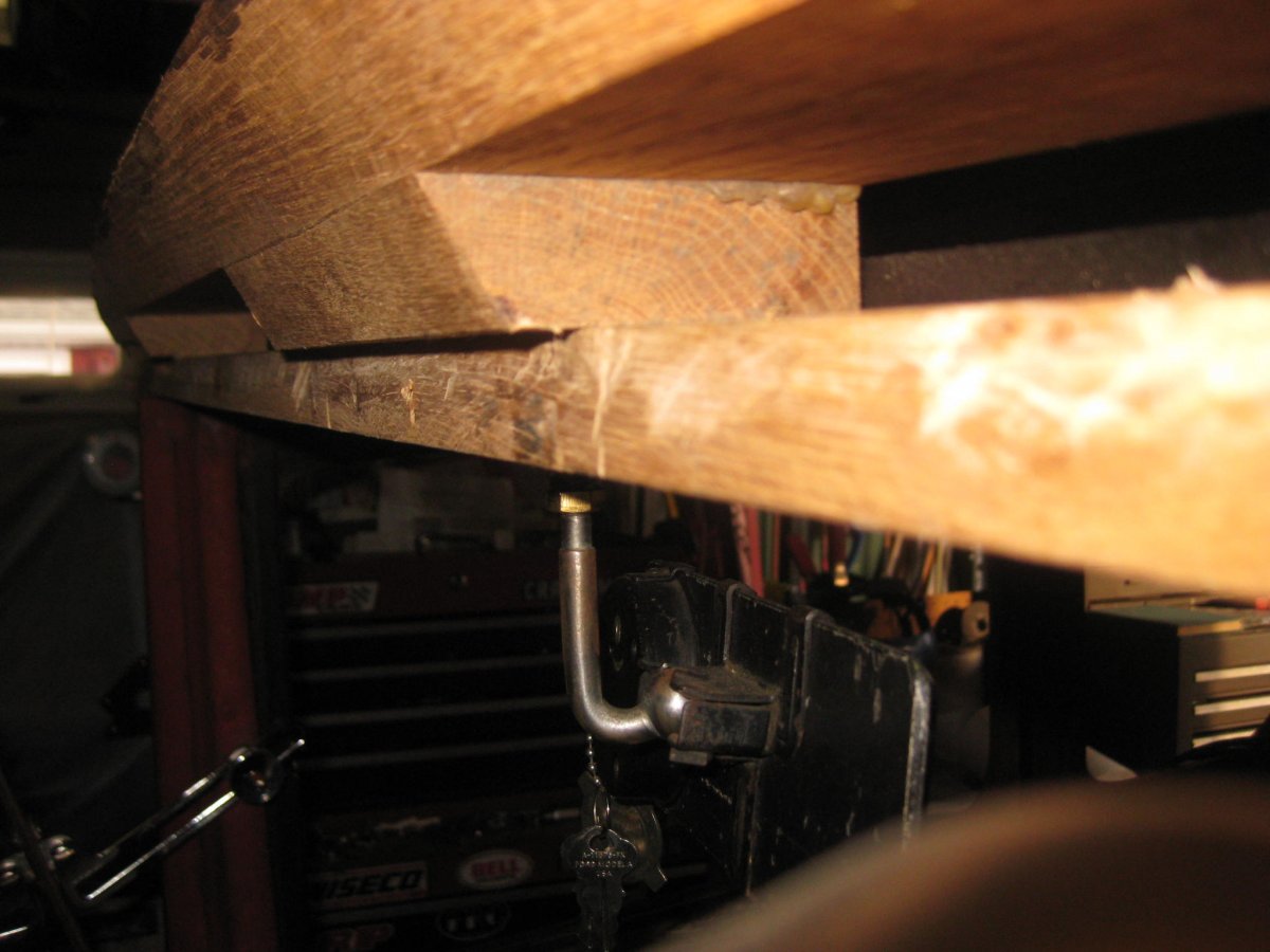

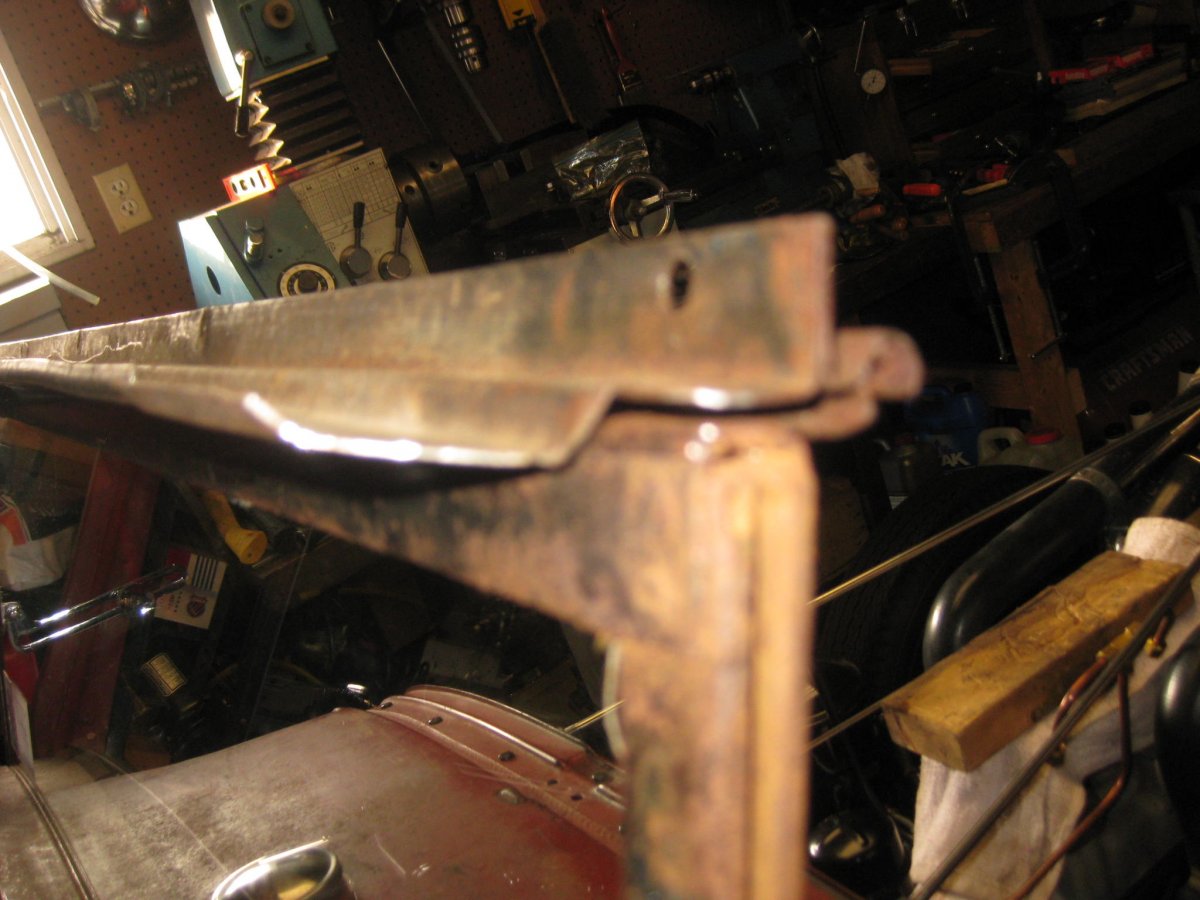

  11. drifters cc
    Joined: Feb 16, 2010
    Posts: 178
    drifters cc

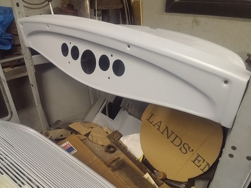

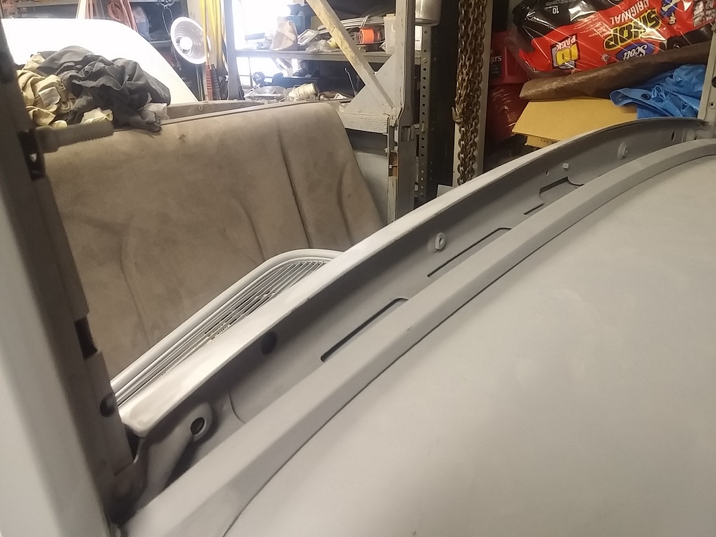

    Ok. I got some pics to show you all.
    Look at the dash: ( most likely a 1930/31 )
    Look at the wood header: ( came with a pile of parts in the car when I got it so ?)
    Look at the window: ( Probably the culprit here.)
    The window was a swapmeet find that was tagged as a 1930/31 Ford closed car.
    When the window is screwed into the header the dash and window lip "hit"
    When the window is low enough to close nicely, the top is not even close to screwing into the header.
    IMG_1772.JPG IMG_1772.JPG IMG_1773.JPG IMG_1772.JPG IMG_1773.JPG IMG_1774.JPG IMG_1774.JPG IMG_1776.JPG IMG_1778.JPG IMG_1779.JPG IMG_1781.JPG IMG_1780.JPG .
  12. alchemy
    Joined: Sep 27, 2002
    Posts: 22,707
    alchemy
    Your problem is you don't have a Model A Ford windshield frame. Pretty simple.

    No it's not, gas tank is cut out and has a 32 style dash welded to the top rail. The dash still mounts the same, the top rail screws to the arched piece between the windshield posts. If his windshield closes with the air flange below the arch piece putting the top rail shouldn't change anything unless it is hitting the mounting screws.

    wbrw32
    you did not state in your original post that you trying to make Chicken salad...who ever welded the 32 dash in screwed up..plain and simple...time for you to make necessary repairs to correct it all.

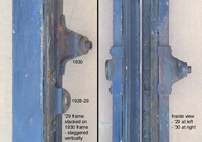

  23. RICH B
    Joined: Feb 7, 2007
    Posts: 5,960
    RICH B

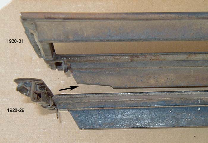

    Not that it has any real bearing on your problem exactly; but here are a couple of pictures to help ID '28-'29 ws frame in comparison to '30-'31; and I suppose to help identify a non-Ford frame. Both the hinge and the lower lip on your parts do not look Model A, and the metal cover for the header does not seem to be there.
    tb33anda3rd likes this.
  24. Canuck
    Joined: Jan 4, 2002
    Posts: 1,104
    Canuck
    The OPs picture of his windshield frame does not show a clip welded along the back side of the frame to mount the weatherstrip, (see Rich's post). His frame has a slot along the outside edge.

  26. mike bowling
    Joined: Jan 1, 2013
    Posts: 3,559
    mike bowling
    bingo- screw holes on the FRONT of the header are incorrect
    model A screws up through the metal angle across the top of the windshield POSTS and up into the wood header. There are holes already in the angle to do this.
    You have to have the swing arms DISCONECTED and open the windshield/ hinge ***embly to almost 180*. ( sometimes better with 2 people on a finished car)
    Once the windshield is in place and has the rubber (useless) weatherstrip on it, when it's CLOSED, it will hit the filler strip that's bolted to the GAS TANK, not the DASH RAIL. ( or "dash board", because there's only a dash "panel" in the center) terminology is confusing for sure!
    The dash "rail" directs air down into the car when the windshield is open.
