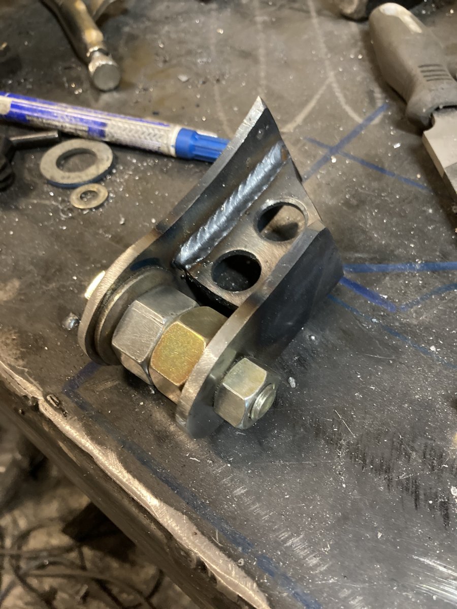

    I checked out the 10 bolt, has 4.11 which will work well with the OD, C-clip eliminators, and a limited slip of some kind. I had originally wanted a 9" but these are plenty strong and will save me some much needed cash.
    I bought a 4 link kit from welder series.
    Modified the brackets to give me some more adjustment.
    I want to run it parallel on the street, and tuned for anti squat when I take it to the track.
    After plotting graphs and calculators and research this is what I came up with..
    IMG_3310.JPG IMG_3311.JPG IMG_3313.JPG IMG_3314.JPG IMG_3316.JPG IMG_3317.JPG IMG_3318.JPG IMG_3320.JPG IMG_3321.JPG IMG_3323.JPG IMG_3325.JPG

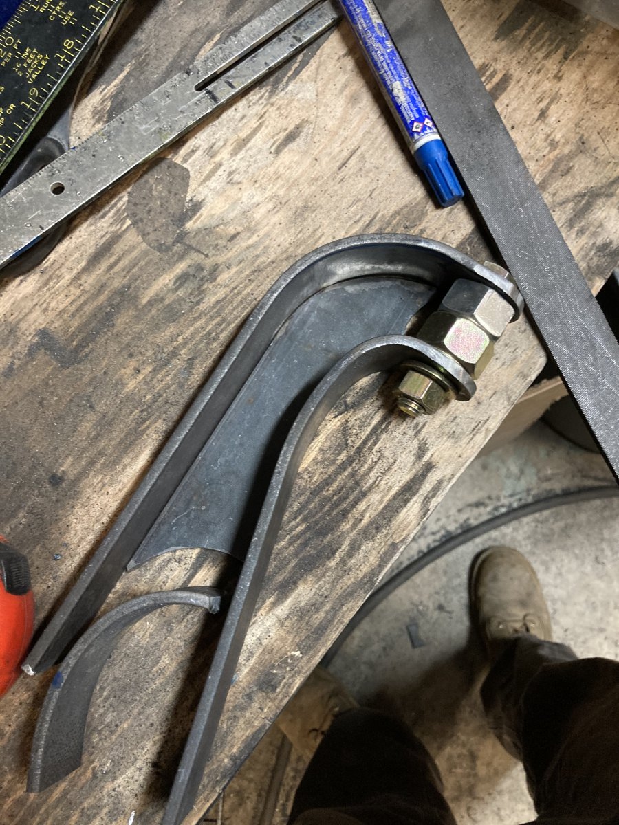

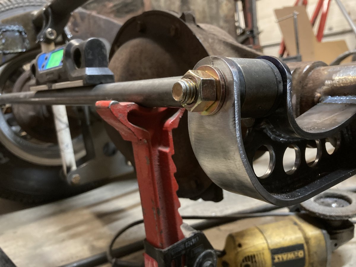

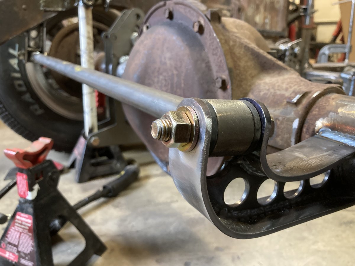

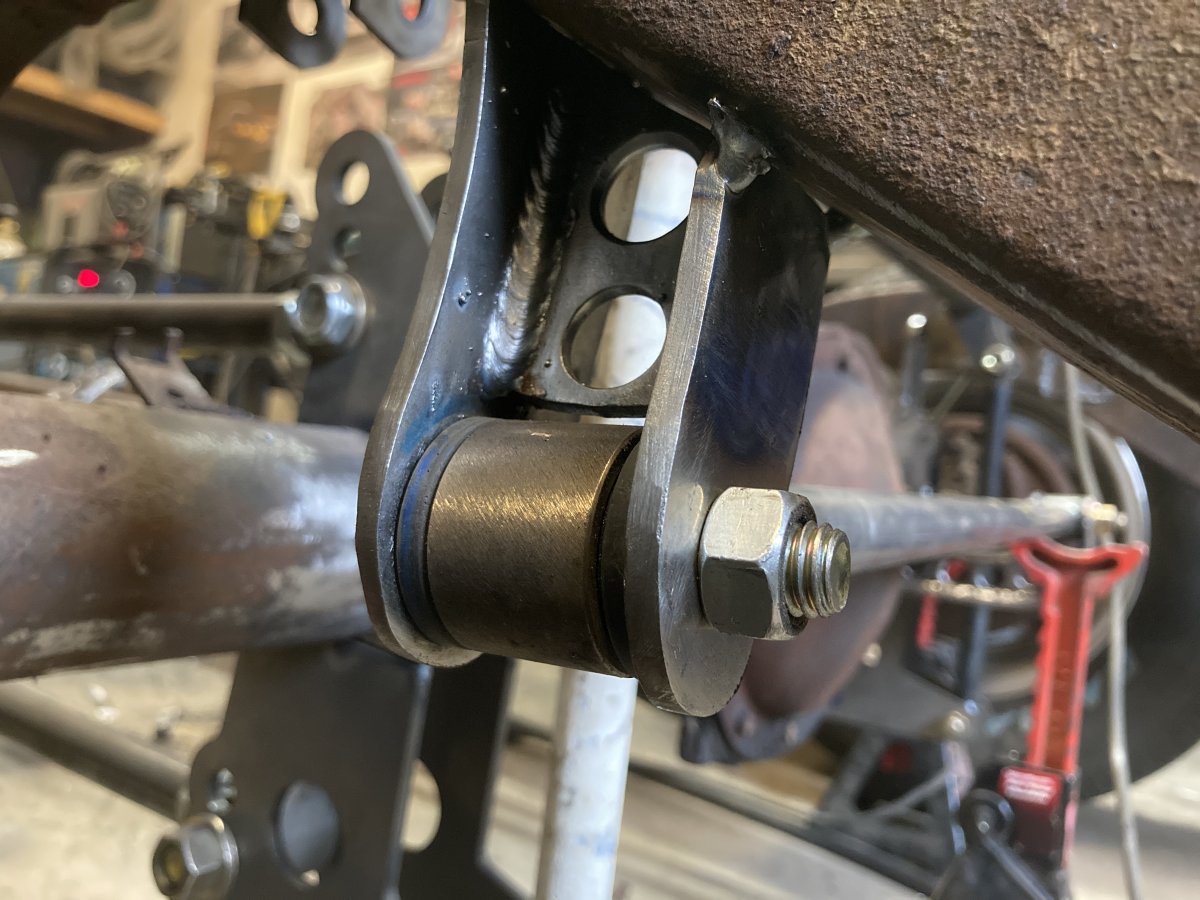

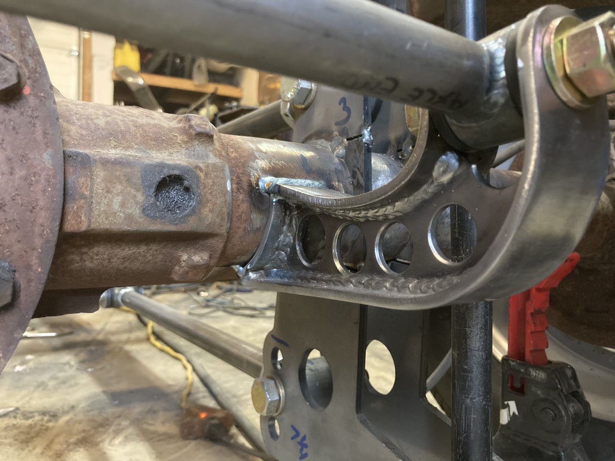

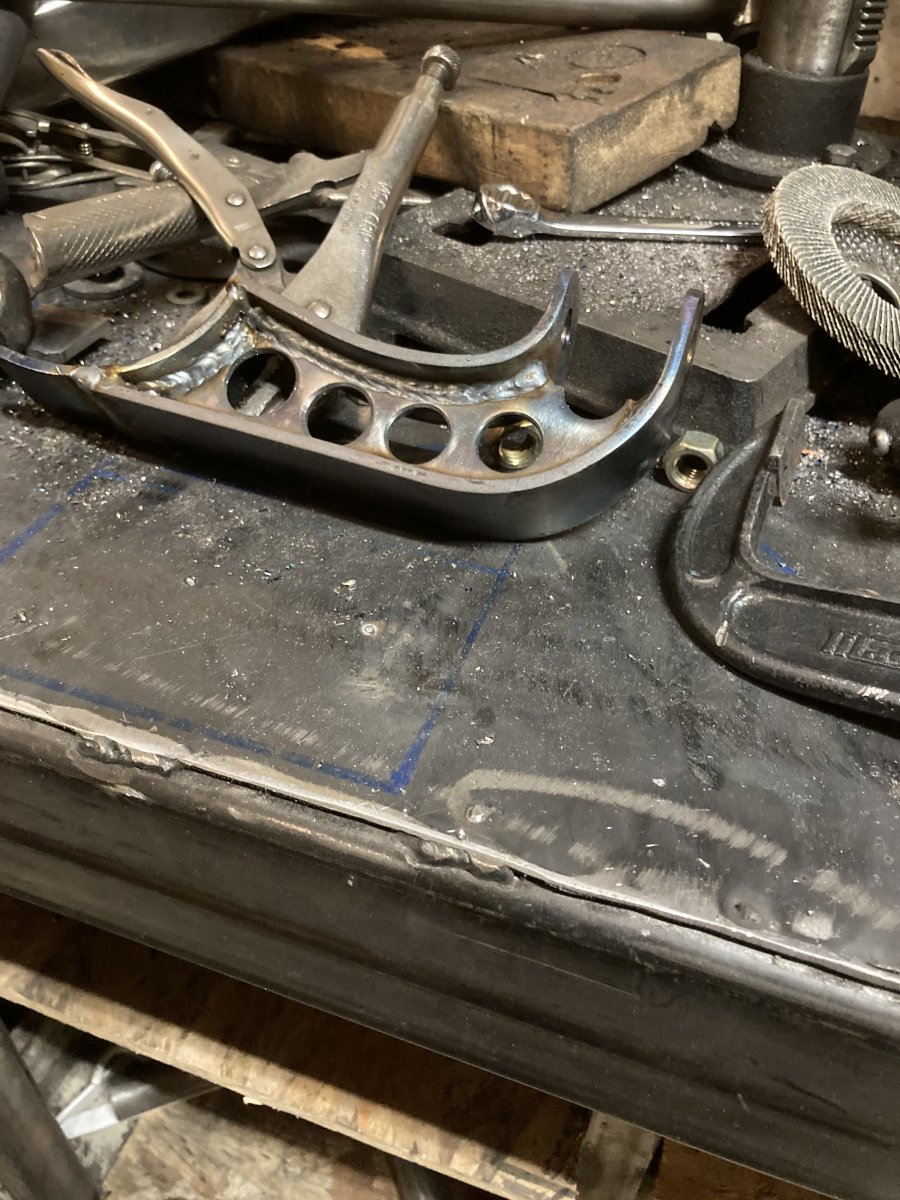

    Last post for a bit, I wasn't super happy with the trac bar, thought it'd give me lots of exhaust clearance but did not as the suspension articulated.
    Current plan is fender well headers and side dumps anyway but if too annoying I'd like to run a full 3" exhaust all the way out the back. So I came up with some different mounts for the trac bar.
    IMG_3439.JPG IMG_3442.JPG IMG_3443.JPG IMG_3444.JPG IMG_3445.JPG IMG_3447.JPG IMG_3448.JPG IMG_3450.JPG

    well,prob no prettier welds today on the hamb!-did you jig the axle hsg to avoid warpage?

    you’re making me blush lol. Sometimes they are ok, sometimes they are mediocre.
    I only have a few short welds holding the brackets on currently.. but that is the plan, figure out some way to jig it and hold it straight. Also would like to weld tubes to the housing, I’d be better off getting a shop to do it, but there isn’t anything around here for 2 or 300 miles that’d be up to the task.
    lots of guys don’t worry about it, but I did have a 9” that I welded brackets to that tried to **** off sideways, so really like to avoid that.

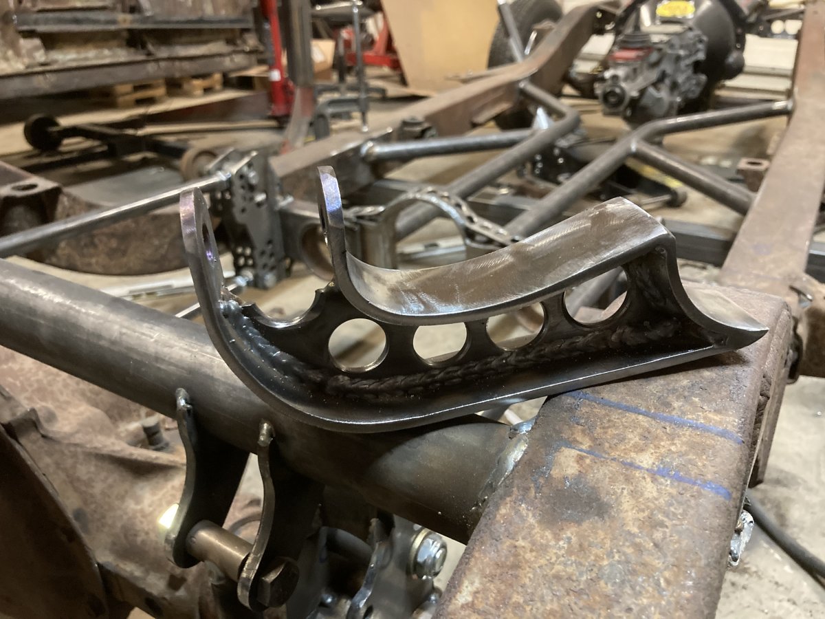

    I cut this trans mount out of 1/8" plate with the plasma
    I really wanted something professionally done, laser cut, maybe a logo in the middle. But couldn't come up with a logo that wasn't stupid lol.
    Heating an bending around the tube.
    Using these "trick tabs" from TMR to mount it to the tubing.
    Don't look close the welding is garbage on the tabs.
    IMG_3458.JPG I settles just to dimple it and call it good.
    IMG_3461.JPG If I had more room with the driveshaft I would have ran it down the whole length of the tubing.
    My thought process is this, most frame are virtually designed as two rails, held together at the front and back.
    Usually a tiny 1/4" strap holding them together in the middle rear and a small trans crossmember at the front with usually doesn't add much for tying the two rails together, basically a big square box, not the strongest shape in the world.
    I wanted something that held the two rails together a little more.
    I think it accomplishes what I wanted.
    I'm adding a driveshaft loop at the rear after floor is mounted and clearance figured.
    Below shows the support I added for around the trans.
    Its 3/16 plate, boxed with a bottom 3/16 plate as well.

    As shown above I had to heat and bend it with a small propane torch (I don't have an Oxy/act setup in the garage.)
    Actually turned out ok and gave it a bit more finished look.
    Its ok, definitely amateur level still but I think it will do. It'll be mounted with some nice bolts and maybe painted a contrast color, not sure yet. Needs a little finishing on smoothing out the sides but all takes time..

    A few more thoughts on the four link, and why I did what I did. I feel I breezed over that part to deflect from the engine so here is a bit more wordy justification of my rear setup.
    As per usual, I over ****yze everything and need to know as much as I can before making a decision, so heres some thought process.
    Ladder bars vs 4 link vs leaf springs vs whatever else.
    Now I have no thoughts that this will be a G machine or anything like that, just because it has a straight axle doesn't mean it needs to drive like ****.
    So for me I'd like when it turns the tires stay on the ground as best they can, the suspension has as much travel as I can give it, and is somewhat cushioned, not jarring or terribly harsh.
    I'm sure we all know radiused fenderwells and suspension travel don't go together... err.. well they can but look like ****. Like all things hot rodding that is a compromise, so all i'm planning on is around 2" max, probably 1.5" to bumpstops. Most on the hamb will recommend wild amounts of suspension travel but realistically a 12" or 14" coilover that fit hot rod spaces have all of 4 or 5 TOTAL travel. So I figure I will start out with 2" compression and 2" rebound, and lower it down till its uncomfortable, then back it up a little.
    I think that will be fine, I lowered my wifes Denali and its got maybe an inch and feels fine. I believe a supple set of bumpstops will be the secret to making it not noticable.
    So back to diff locating..
    Ladder bars just don't articulate, and don't offer adjustment, not a great option for my plans. I know the previous setup was a bit different that traditional hair pin ladder bars but it still hold true that ladder bars lift both tires over bumps. If I jacked up the diff previously as far outboard as possibly it just lifted everything evenly up, there was zero articulation.
    Leaf springs would have been super easy, set and forget. I'm only planning on 500-600 rear wheel horsepower, leaf springs would get me down the track to reach my 11.5 "non-roll bar" goal and ride and handle fine. Problem was, there were no mounts on the frame. Previously the guy had springs mounted inboard but for some reason took them off and welded the pockets back up. So to do inboard springs/mounts/shocks/etc, leafs were just too much money, especially for no adjust-ability and having to add a caltrac or something to control wrap.
    Also with a link suspension I get to use coil overs, which is like the easy ****on, car looks a little low the crank up a tad. Adding some weight for a cross country trip add some preload. Sitting too high for drag racing turn them down.
    I did a triangulated 4 link on my model A, that thing is awesome, it rides great, handles great, launches pretty decent.
    So I really do like that setup. The other alternative nowaday that seems to be pretty popular when researching was 3 links.
    Reasons I decided against a triangulated 4 link or a 3 link, mainly the cast center section limits the options, and the triangulated setup would also make exhaust harder to build down the road.
    I also know 4 links will limit articulation unless ran parallel. So I setup the brackets and plotting on graph paper my IC and antisquat to have it so I can run the bars parallel 98% of the time and swap it and tune it for better launches when planning on going to the track. During final ***embly I'm planning on adjusting the bars and finding what I can run for angles before it limits articulation and starts trying to twist the diff. I haven't messed with that yet, but I think there has to be a bit of angle allowed before its detrimental. Currently the parallel articulates like no tomorrow.
    That would be the bonus with a 3 link or tri, getting to set your instant center and not limiting articulation, set and forget, kinda..
    With the rear locating figured, next was to decide Heim joints vs Polyurethane vs Rubber, etc.
    Poly gets a bad rap in some circles and is hailed as the best thing ever in others.
    I really didn't want to go poly, but my end goal is the car to be the best driver it can possibly be. I'd like it quiet and a little comfortable.
    I drove my bare bones A across canada, I'm good with noisy, dirty, no interior, stinky hotrods, setting valves/timing/carbs/etc... is all good here. But I'm building this for kids to enjoy as much as me.
    So back on track, I'd like to tame as much NVH as possible.
    So Heim joints kept looking worse and worse for my application.
    Poly likes to squeak, I'm going to be adding grease zerks through the middle with p***ages in hopes they won't squeak. I really wanted the ridetech R-Joints but they are just too much for me right now, so maybe later on, or during final ***embly I'll add them. I know Herb Adams isn't a fan of poly and took that into consideration, though times do change and you look at a lot of the modern cars and a lot of what was gospel 10 years ago is proven wrong with radial slicks, turbos and "pro touring".
    When I started looking for bars/4 links/etc I found that the "welder series" pro street 4 link was the best deal out there. I priced bars and bungs and hand cutting brackets but their kit was cheaper. Keep in mind I don't have a tig welder so chromoly is out of reach for me currently, which kill some DIY kits.
    This is the one I went with, and being Canadian its nice to shop in Country if I can.
    https://welderseries.com/Four-Link-Kit-Pro-Street-p51448855

    Of Course to get the correct 4 link angles I had to cut out part of the floor.
    And since the bars ended up further than I wanted I had to notch into the brace with some 1/4" pipe I had laying around. Wish I would have went shorter bars at this point lol.
    GFVC0099.JPG Not the prettiest work ever shown on the hamb, but I'm not metal shaping guy thats for sure.

    You do great work, fab skills are awesome. I put a triangulated 4 link in a
    the A sedan I built, it handled great and repeated that on my 33 plymouth sedan. I'm going to switch it out for a set of Rjays ladder bars this winter. I can't stand the lower bar hanging down and that is as high as I can get it and I used the frame I got with the body and it has some questionable work in some places and it bothers me. On the rod ends, I'd use good CM Heim joints, I put 3/4 ones on my A, DOM tubing and I had them on my upper bars in a chevelle I built. Never had any noise, the ride was fine and I didn't have to worry about breakage.

    Good to know, always so much conflicting info. You are right about the four link hanging low, with the proper separation at the axle your lower bars hang down so much.
    not much of an issue with this car, as the lower bar doesn’t sit much below frame, and it’s a big body/factory frame setup so kinda ugly below the skirt anyway. Thought I’m trying to keep everything tucked up as much as possible.
    But was a real consideration on the A. I really didn’t want to have anything below frame, but function over form said I had to. In the end I don’t mind, you see some cars where it wasn’t even a consideration...

    On your 4 link, once the rod end jam nuts are tight, you won't get the articulation you have shown. You will only get the amount of deflection available in the bushings. If you articulate or force past that, the rod end jam nuts will slowly but surely loosen themselves to allow additional roll.
    Since you aren't rock crawling, no biggie.
