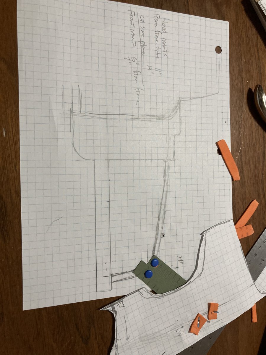

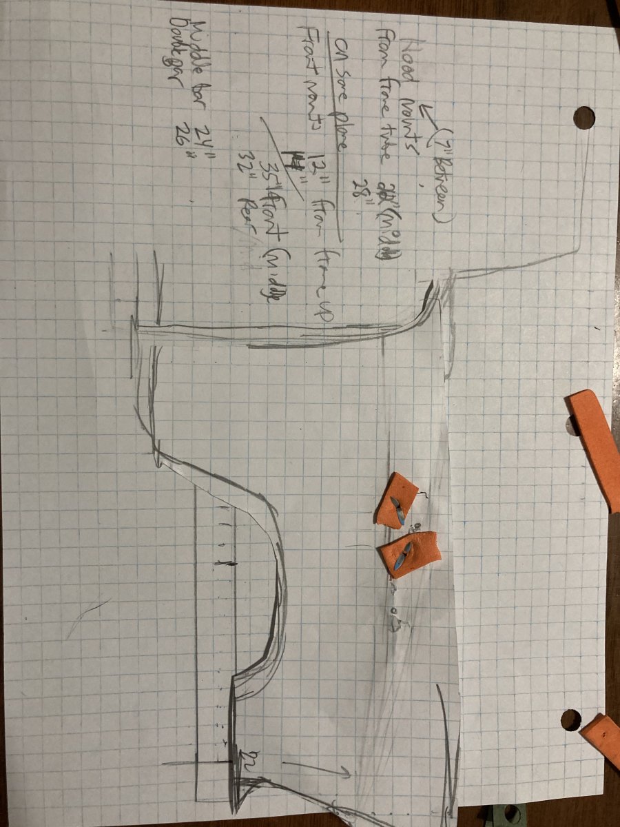

    Also in my spare time I have been anticipating the hood tilting.
    I have gone through many different setups/scenarios.
    I want the hood to come forward at the beginning on the arc, then swing normally and then rotate/pitch forward near the end of the travel.
    I'm far from an engineer and have left lots of room for options.
    I've done scale models on graph paper to get an idea of what may or may not work.

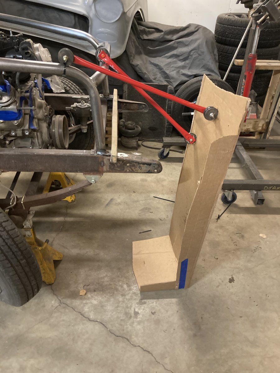

    I've made arts and crafts versions to try and see a real world arc.

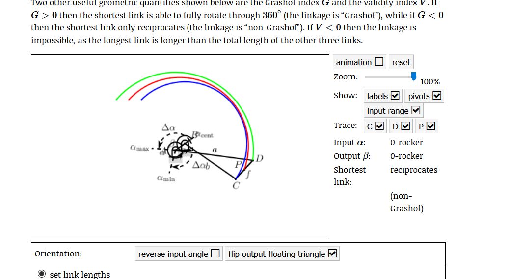

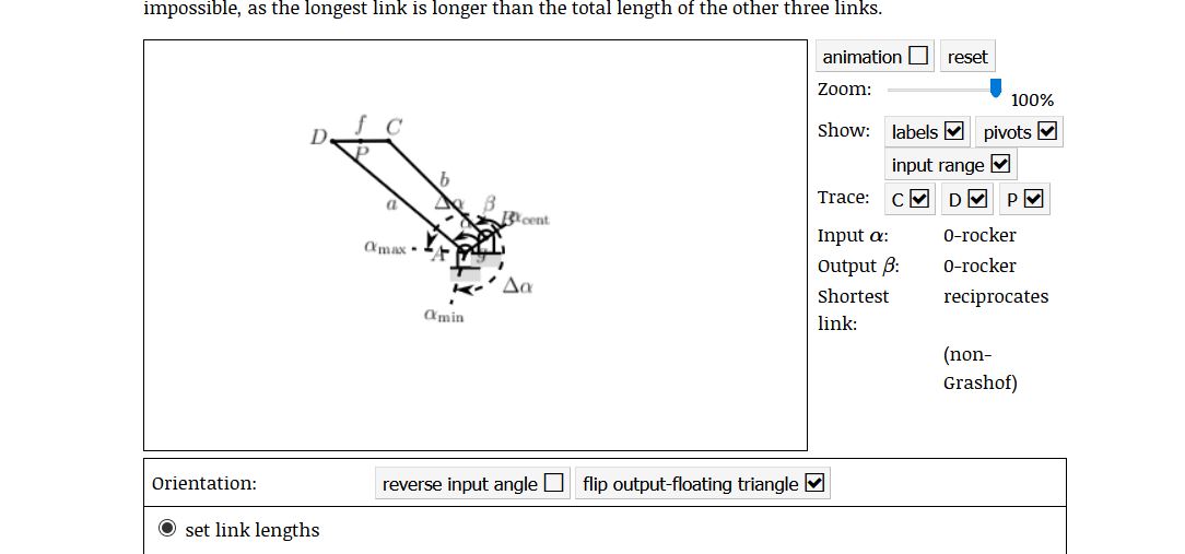

    Lately I've come across this simulator its a "non-grashof" linkage, this uses the "ground and floating links" has the 2 other links, but I picture them as hood and frame mounts.
    Really helpful in see what small changes can do.

    I believe I will go with a 3 link setup to keep the clutter down. One middle bar has the short bar, and two longer has the outside bars.
    I am going with 7/8" bars and poly bushings. I will make the mounts adjustable and just tacked in, once I get the supports welded to the internal hood frame and glued to the hood.
    This is a link to the simulator, pretty fun to play with, I've gone from long links, to short links, different angles, mounting locations, etc. Getting close to nailed down at this point, I hope.
    https://dynref.engr.illinois.edu/aml.html
