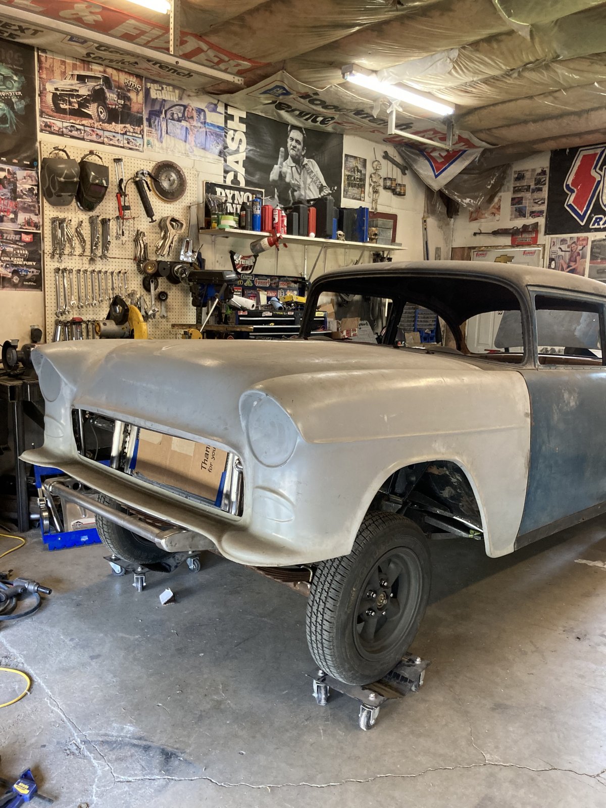

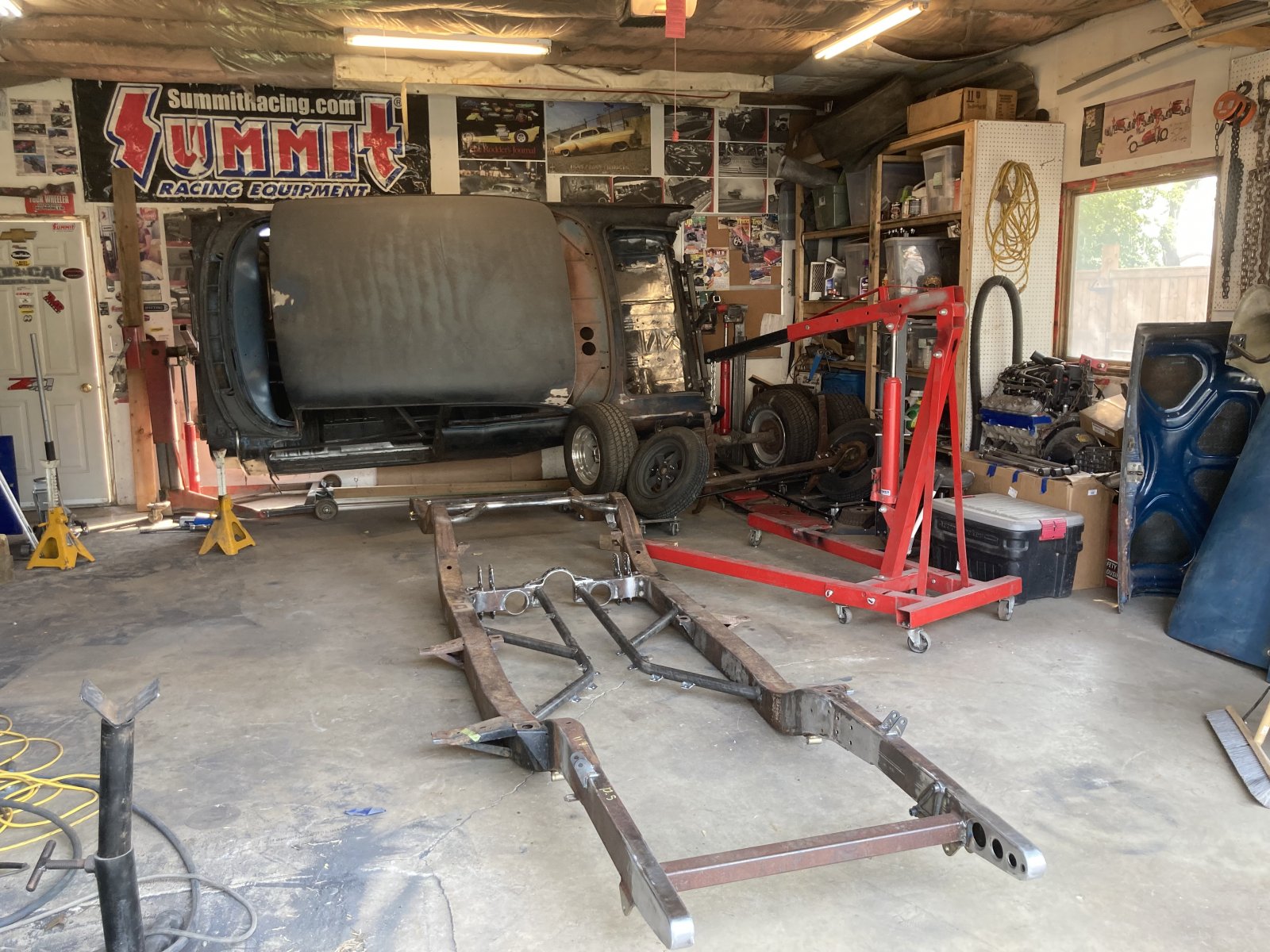

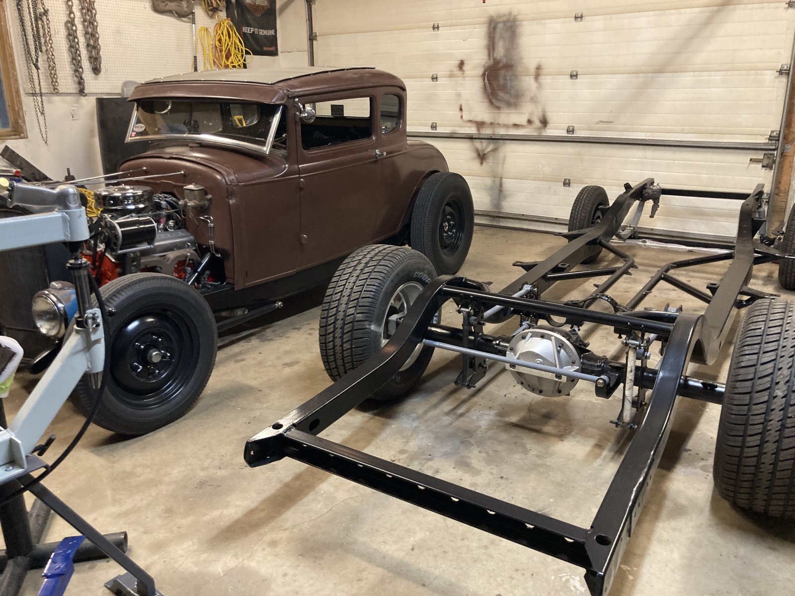

    Here's the car sitting for the last 6 months of so.
    I had an order of body parts from cl***ic industries that had some back ordered parts. I had a run around with cl***ic industries earlier on my floor and they offered to make it up to me with a $100 off my next order. Hoping to have them make it up to me I ordered a bunch of stuff from them
    Well after 6 months of waiting, the two parts finally came off back order, and the other parts which I had paid for and were in stock were now all of a sudden back ordered as well. Long story short I told them to keep their $100 and don't worry about hearing from me again..
    Kind of took the wind out of my sails, so I spent some time off and took a break from the car.
    I ordered a bunch of body parts from Real steel, seems ok so far. Except costing me more to ship them here than the cost of the parts themselves.
    There are some stumbling blocks I need to solve for the trunk area but I'll get to that in the future..
    I figured with my lack of motivation I would pick some low hanging fruit... Knock off some small items to get on a roll. I had a local welder tig some brackets to the rad, and I made some mount to hang. The washers represent the space that the rubber cushions will take up.
    I'm using a "bare bones" Be Cool rad.
    Last look before being blown apart again.
    I had stole the front wheels for my Model A, to try out a different look. They were too shiny so I gave them a coat of fakesium to match the car. If you're wondering why they changed color in the picture above lol.

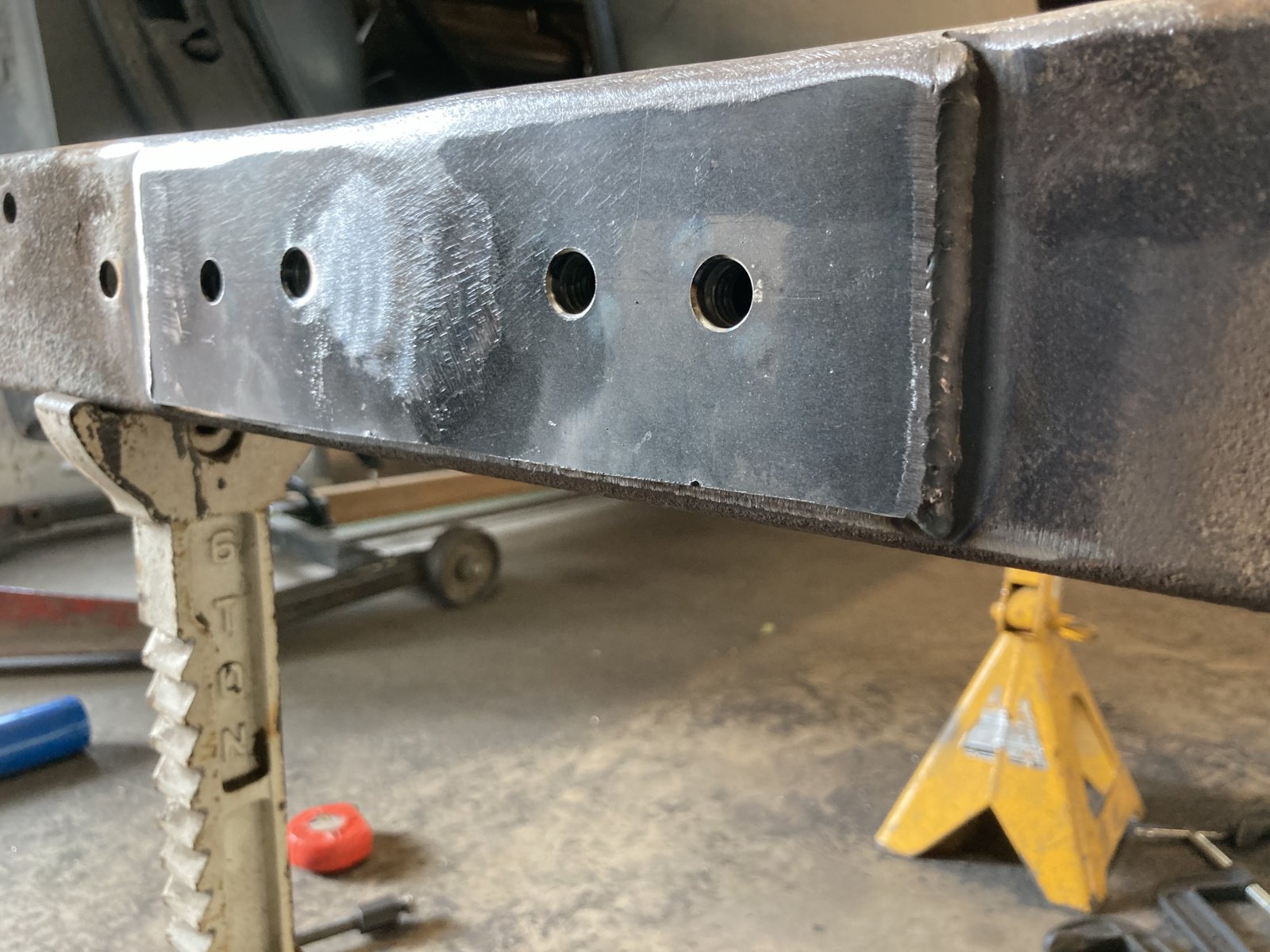

    So while waiting for the body parts I figured I could strip it down and try to knock out the rest of the frame work this past weekend. I tore the body off the frame, which is always a chore solo with out equipment in a small garage lol.
    I smoothed out as much grinding gouges and marks from the previous owner who did the straight axle.
    I finished all the welding, added some tabs for future needs, patched two small rust spots that I found after cutting off the spring hangers, cleaned up all the old crossmembers I cut out and brackets I didn't need.
    I added some reinforcement plates with nuts on the back side for future trailer hitch, never know if I run a drag week type challenge or something along those lines..
    I wasn't super happy with the frame horns, kind of looked a bit bulky before with the two crossmembers so close. The square one was there when I got the frame . It looks good and is in a good location.
    So I chopped off the one I made and shorted it up a bit.
    Here my little tip? for the rounded end, instead of grinding down the edges to match, make your pipe slightly larger, add a bunch of relief cut and pound them round. Weld it up and it looks pretty clean with a nice edge that it still full thickness.
    So that is where I'm at today, three long days in the garage, 10 flap discs, sanding discs, etc.
    Would kind of be nice to use some all metal to clean up remaining spots, but it is just a driver so this is a good time to stop. I am getting it blasted and powder coated. I've gone over my list a couple of times, hopefully I haven't forgot any brackets or future welding, but so be it..
    After this I can start ***embling the frame, hopefully get my wheel tubs installed in the back and finish up the floor.
    Then some paint, sound deadener, and it can be bolted back together and I can be building a car instead of dismantling lol.

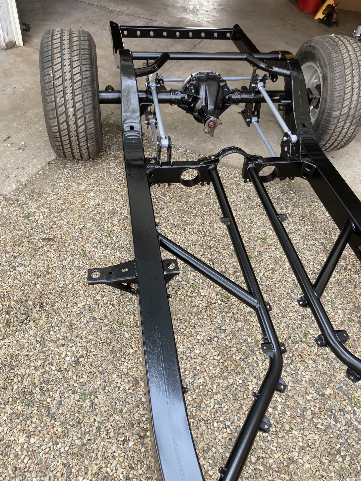

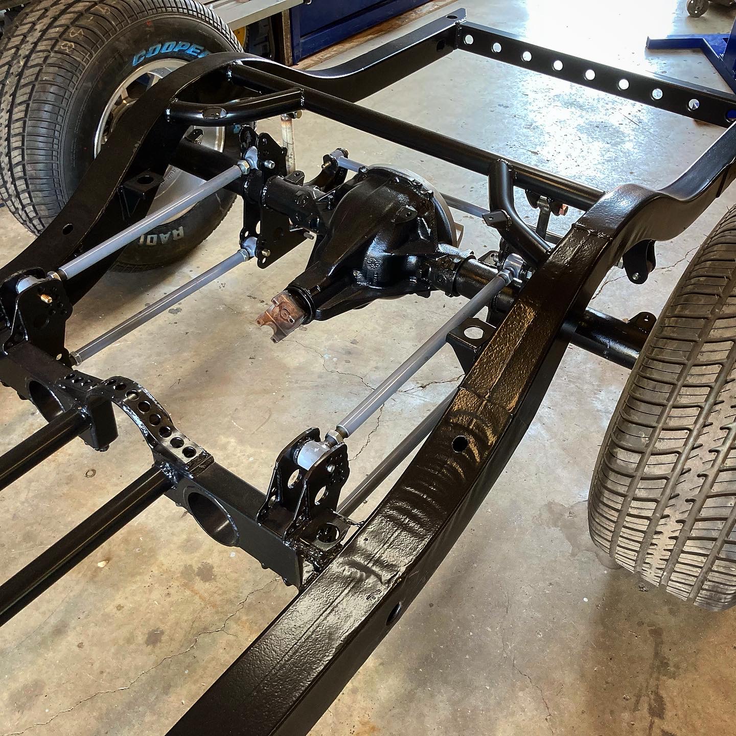

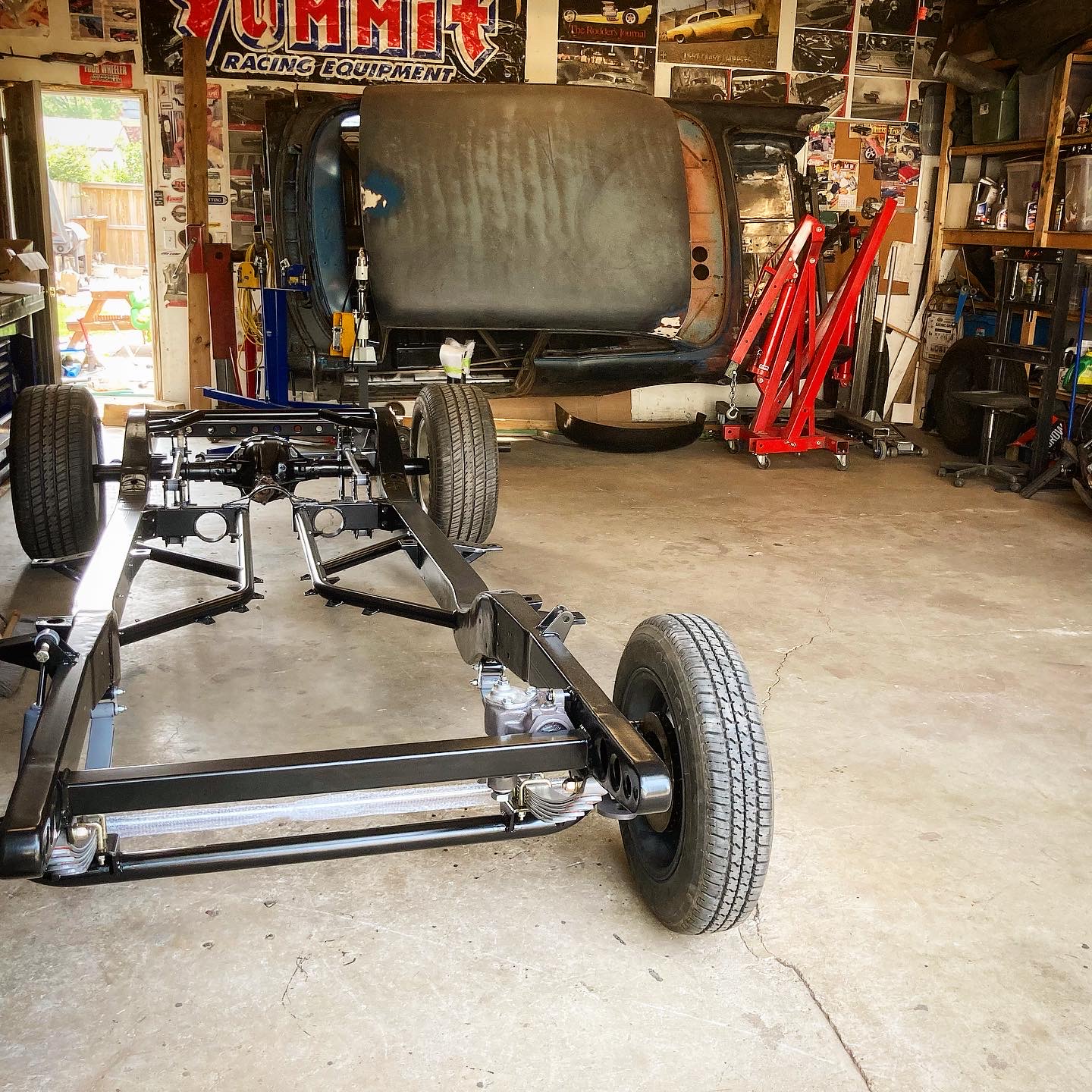

    The previous owner had mocked together everything and left it outside, so I had a lot of rust cleaning to do.
    Various wire wheels and die grinder pads and they were good as new, or good enough lol.
    High tech climate controlled paint booth
    Also when its 36 degrees Celsius out I can bake the parts too. lol.
    The frame back from powder coating.
    Pretty much ***embled.
    I need a few more odds and ends, and missing hardware.
    Now I just need more time and money..
    IMG_5688.JPG IMG_5691.JPG IMG_5721.JPG IMG_E5703.JPG URYH3341.JPG UXPV7804.JPG
    Happy where its at currently. I have a few things on order to finish up the frame stuff, then finish wheel tubs and underside of car.
    The 1/4 patch panels showed up finally and look tall enough to cover and the bondo'd areas of the quarters.

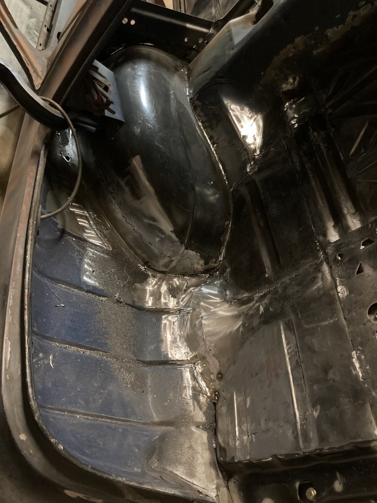

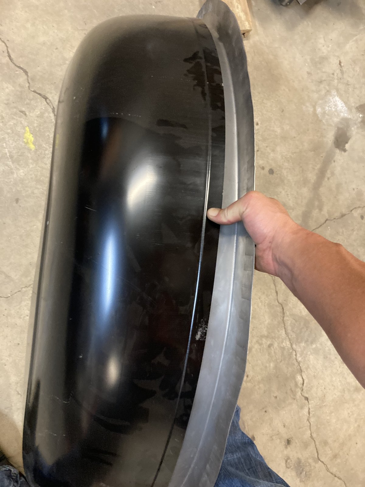

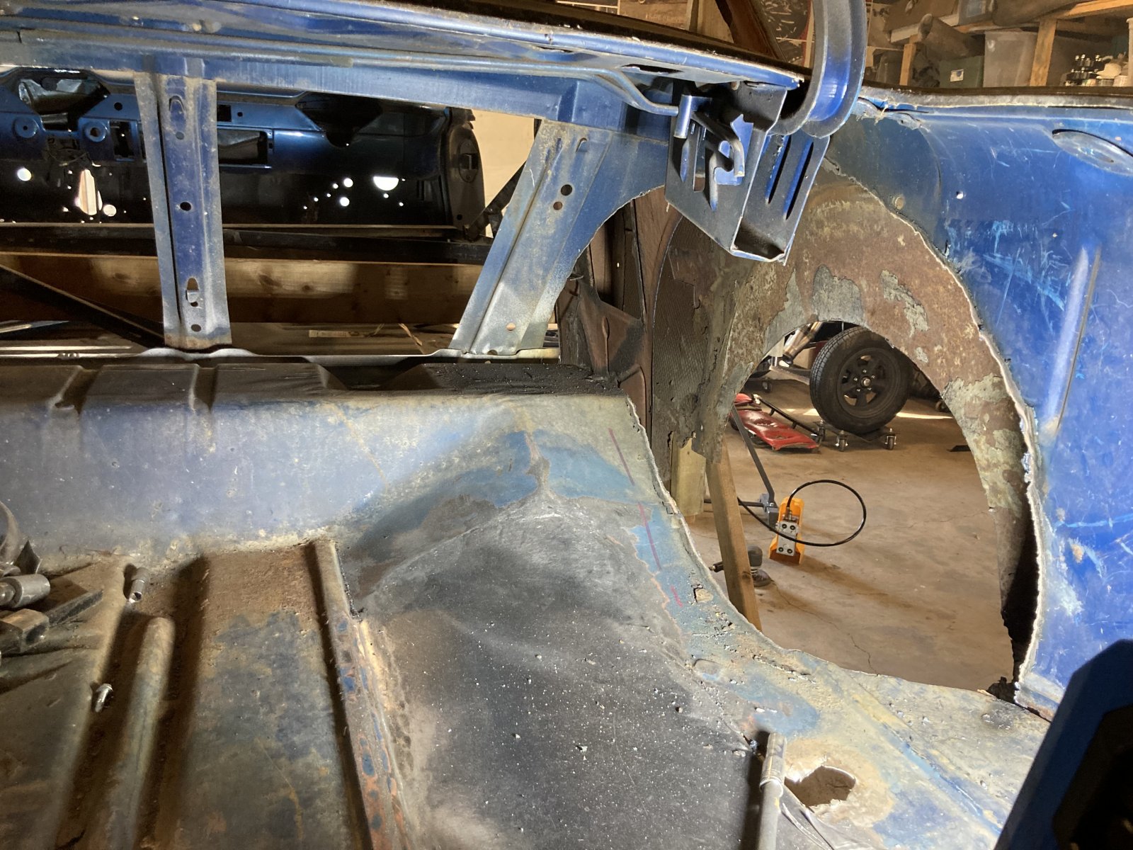

    I had sometime off this weekend, so I worked on the part that I have been dreading.
    The wheel well tubs and outer wheel houses are rusty, replacement wheel tubs don't cover the rusted areas and a full on inner quarter is way too much money and work.
    Here are some pictures of the rusted areas.
    This is the part that I was most dreading fixing. The part right above the wheel well, where the outer wheel house is lapped on held rust pretty bad.
    Also the lower flange for the floor joint also was non-existent.

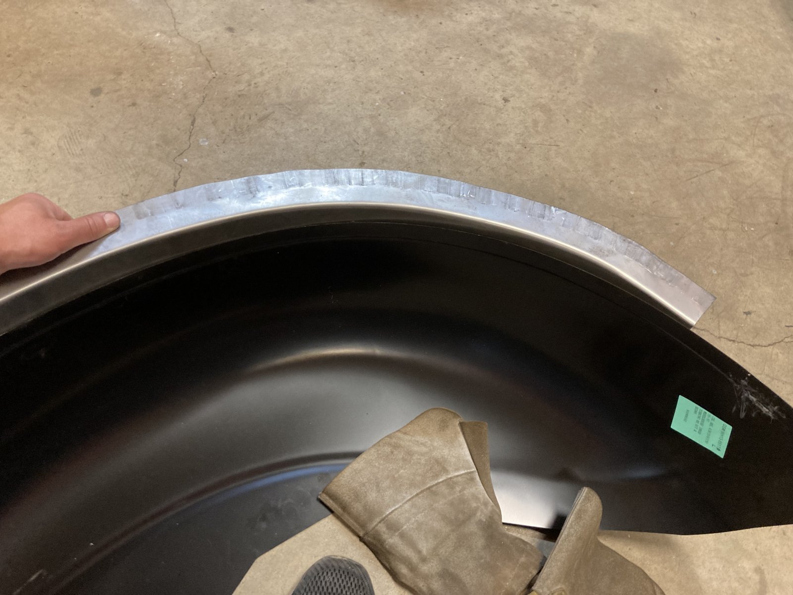

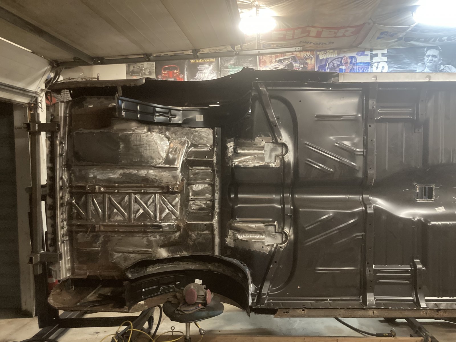

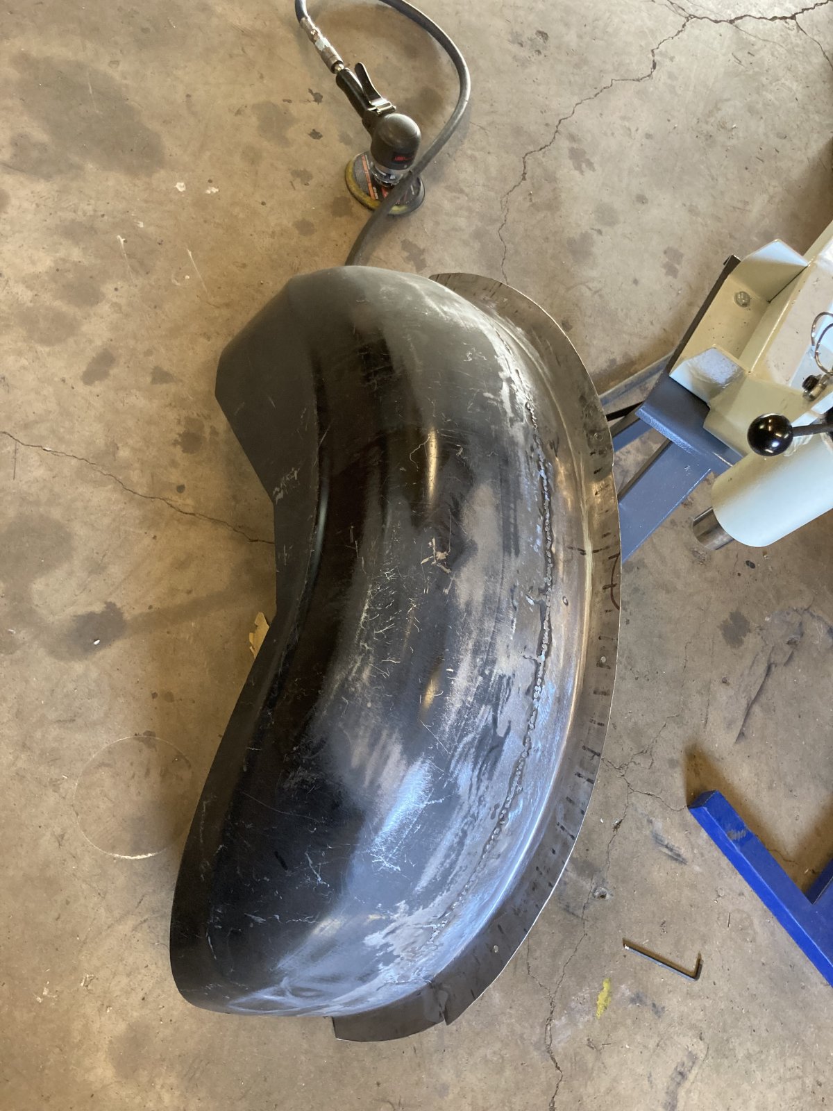

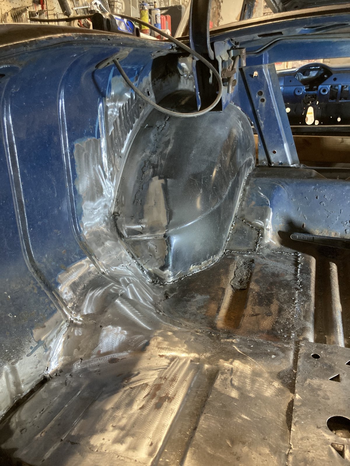

    I had the local welding shop brake some 4' long 18 gauge since my sheet metal brake is too small.
    I purchased a shrinker/stretcher and was able to easily make the radius of the wheel well, I'm actually surprised how accurate and easy it went.

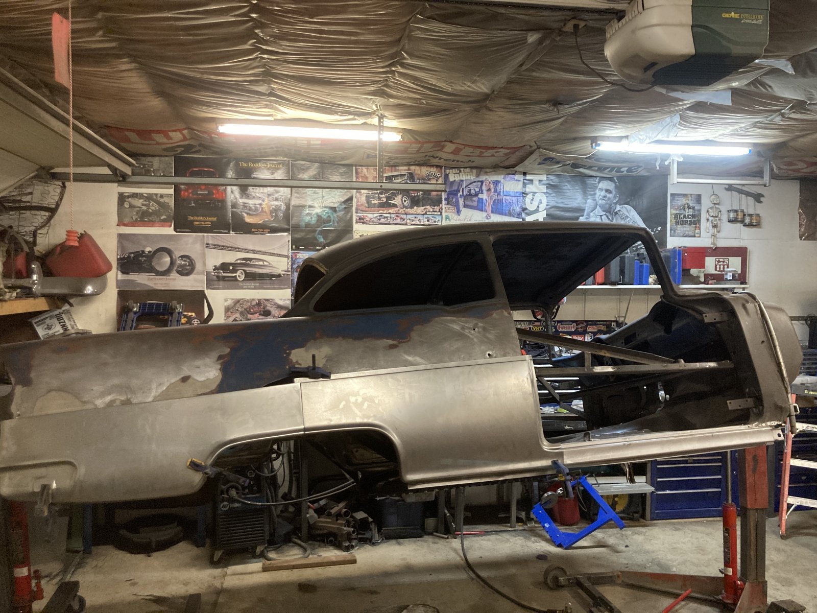

    I figured the best plan of attack, and mocked it up in place. When I was happy I sheet metal screwed it to the inner quarter.
    I did one side at a time, and braced the body as you can see in this picture, with a 2x6 at the rear of the doors. Hoping to keep the weight off the rear rotisserie.
    Fitnessguy, swade41, 40LUV and 6 others like this.
  17. Fry
    Joined: Nov 14, 2002
    Posts: 990
    Fry
    from SK, Canada

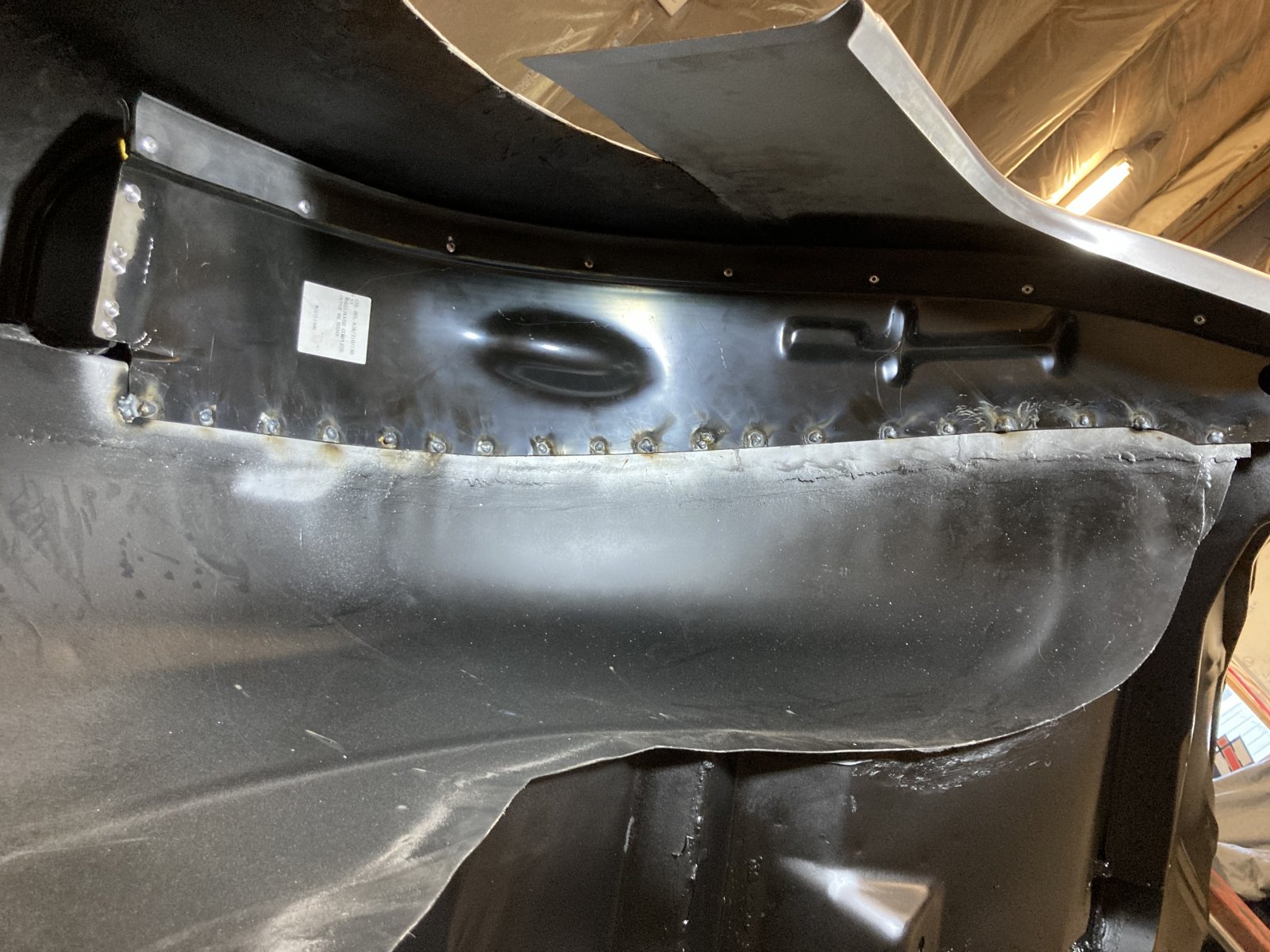

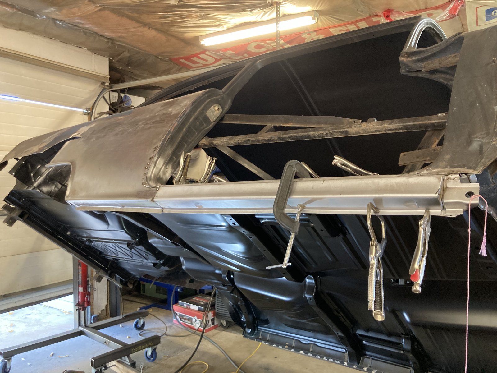

    Once the upper radius was in place, I attached the tubs (real steel widened versions) with sheet metal screws to the radius.
    Then I removed the whole thing, made some transitions at the ends, and started cutting and ****ing.
    Once finished I hit it with my small planishing hammer to clean up the stretcher marks and to round the transition at the weld in a few areas.

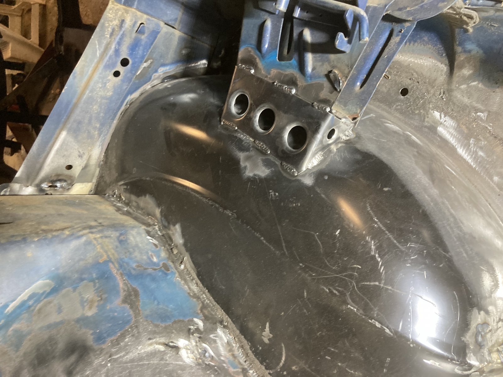

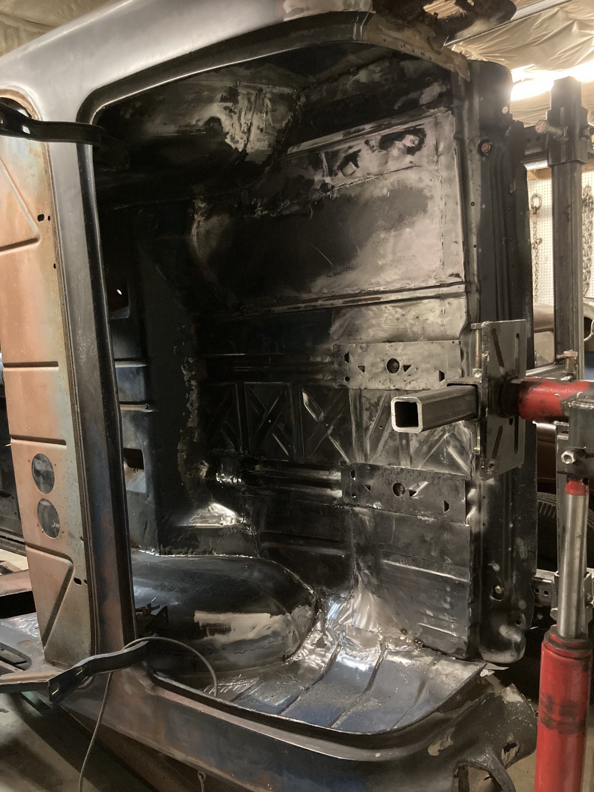

    After the tubs were complete I fit them for the last time and cut and **** welded them into the inner quarters.
    Lots of patching and transitioning to get them to flow a little.
    These tubs though sold as 55 tubs, are way different than my factory tubs. I'm not sure if this is a early 55 to late 55 change or not.
    While I was at it I patched the rest of the trunk. I really wish I had a one piece trunk, after doing all this work.. But a 6 month wait and $1700 I'll just cover it with some sound deadener so I don't have to look at it. lol.
    Still a bit more finishing to do, but its close.
    I just welded the tubs to the floor and didn't bother building a flange like factory. I did rebuild the bottom of the inner quarter at the back and trunk edges to have a factory style flange.

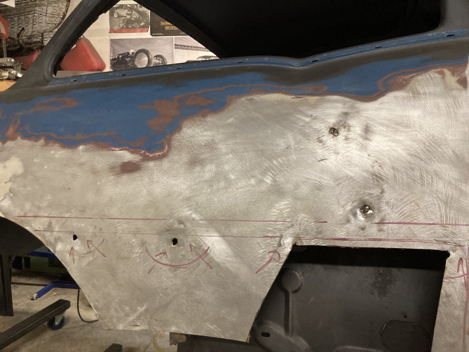

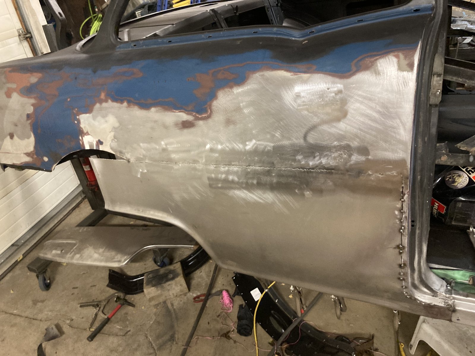

    Test fitting the quarter patches, should fix most of the bad stuff.
    This gives me a good idea on installing the wheel houses to make sure the seal is right against the quarter.
    Also the wheel wells will have a radius cut into them again after.

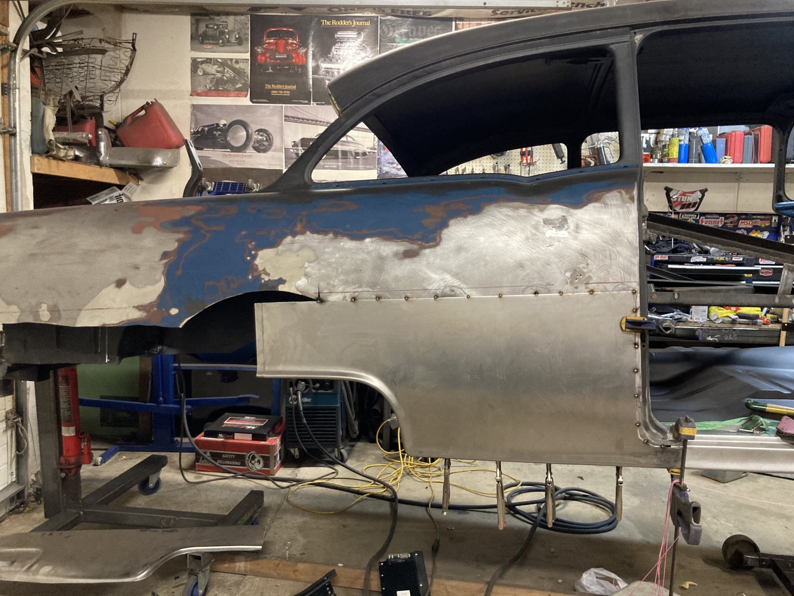

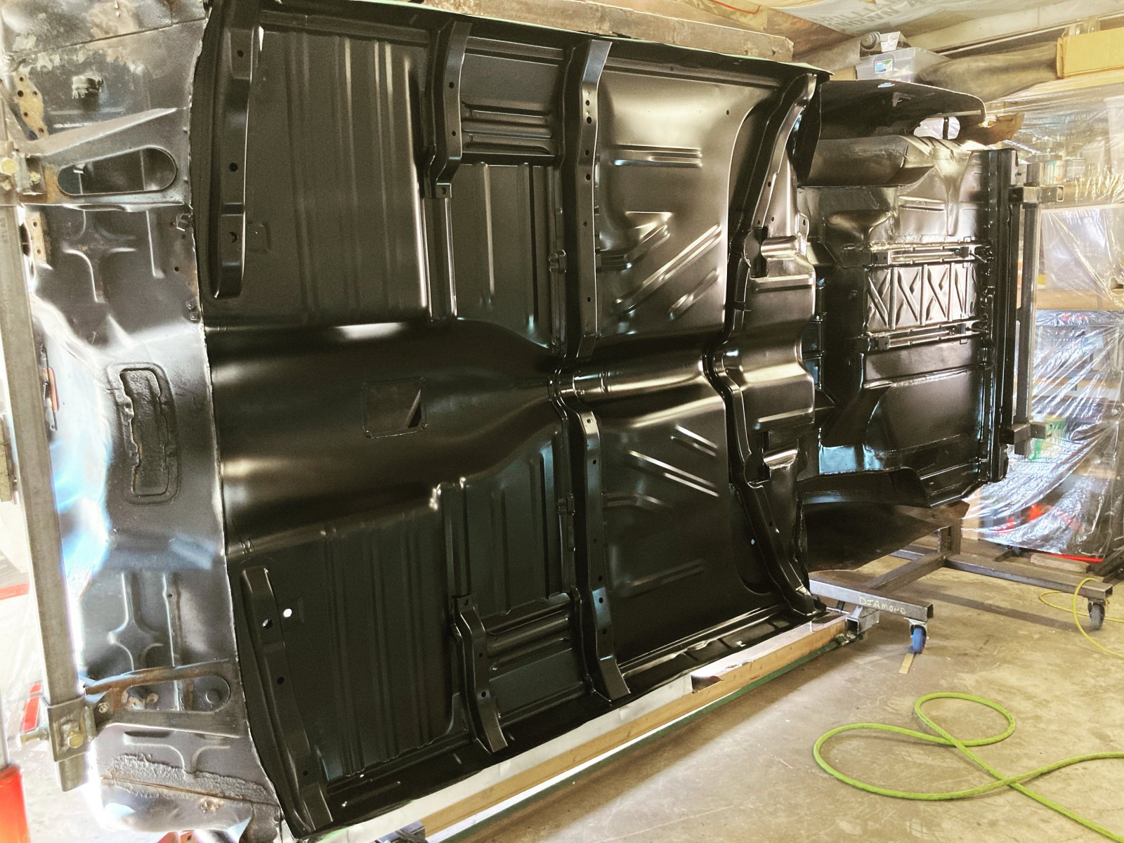

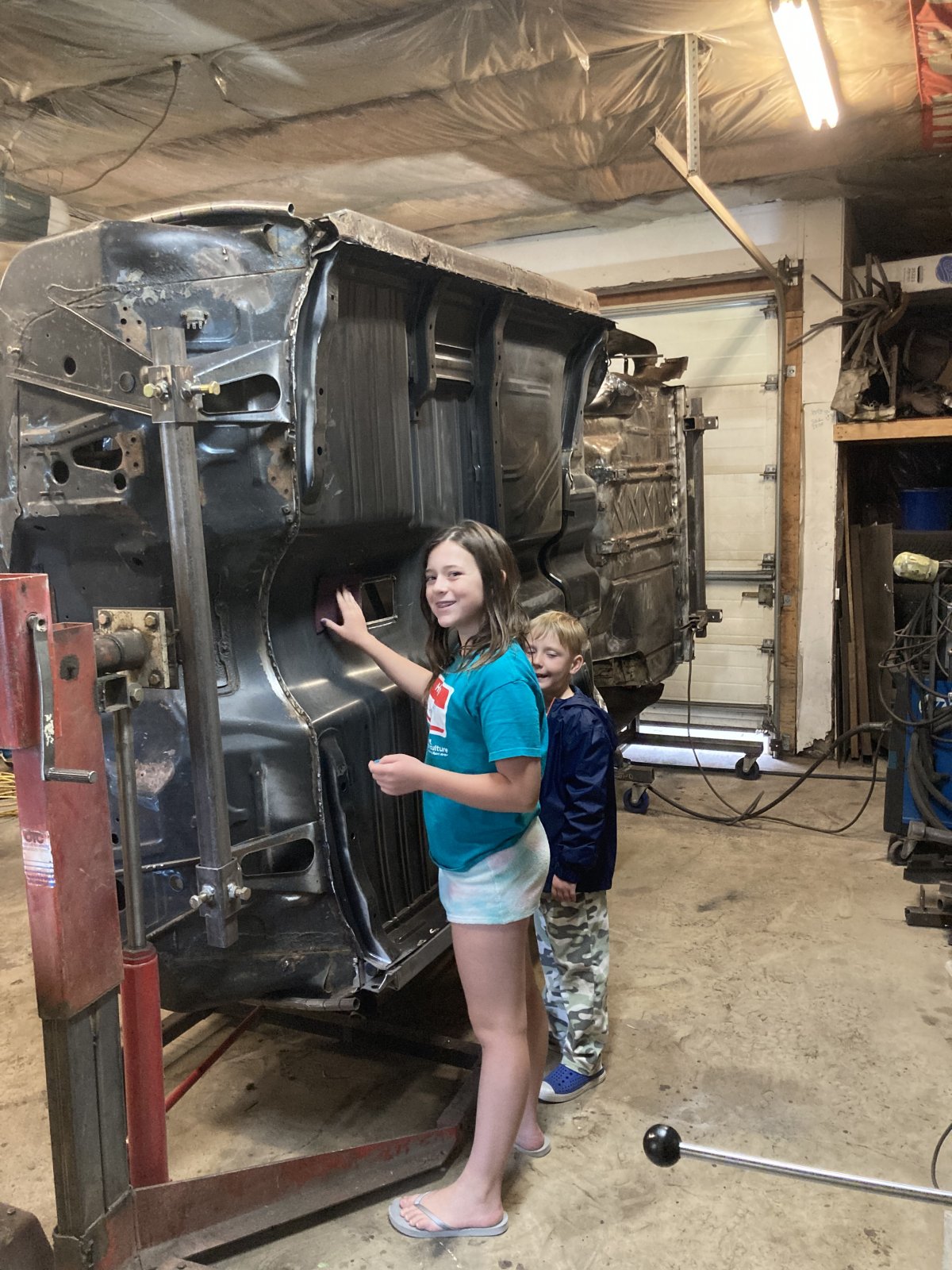

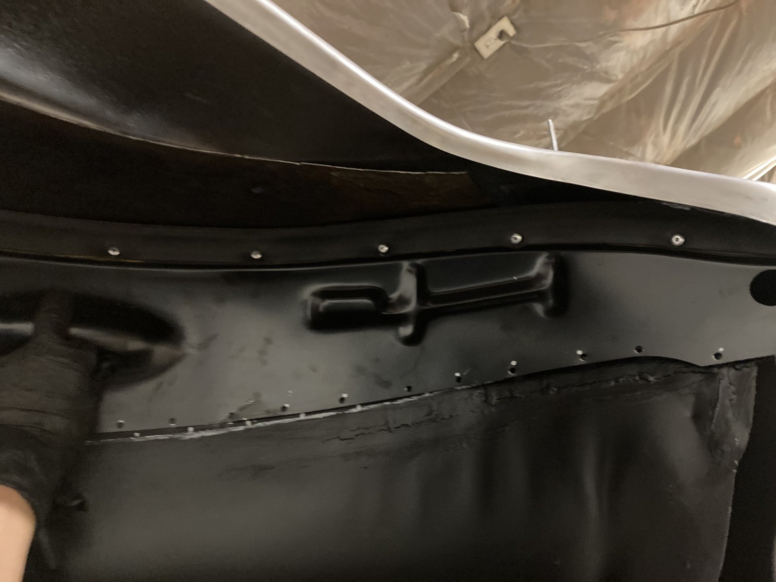

    I finished the metal work, all the welding, braces, spot welds, etc.
    Somehow I wrangled the kids into scuffing up the floor to get ready for paint.
    D36CD161-A61F-4CAE-AD3D-C64433088BAD.jpeg 129E8F55-E015-404A-9E59-C50E2A8394B2.jpeg A34AABA6-0DB3-41ED-958E-6CEFF24A94B3.jpeg 310F56EB-925F-4C2F-93F7-D23C6B3561F3.jpeg

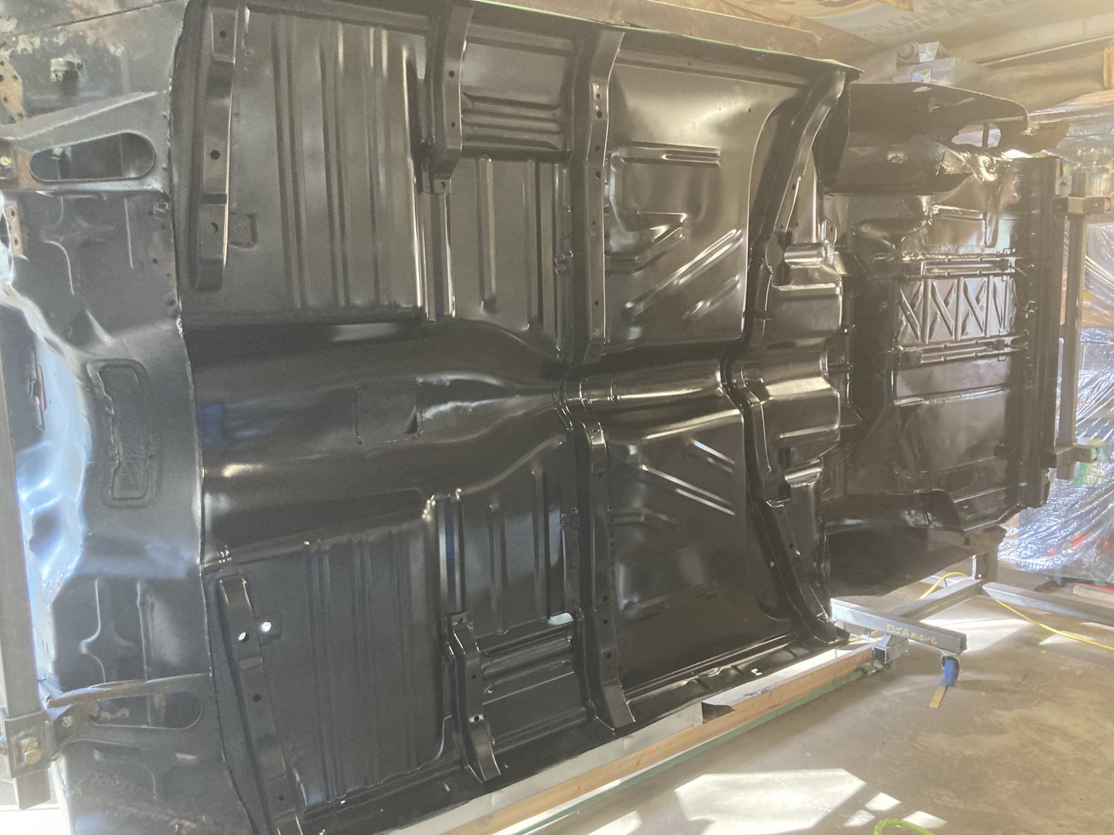

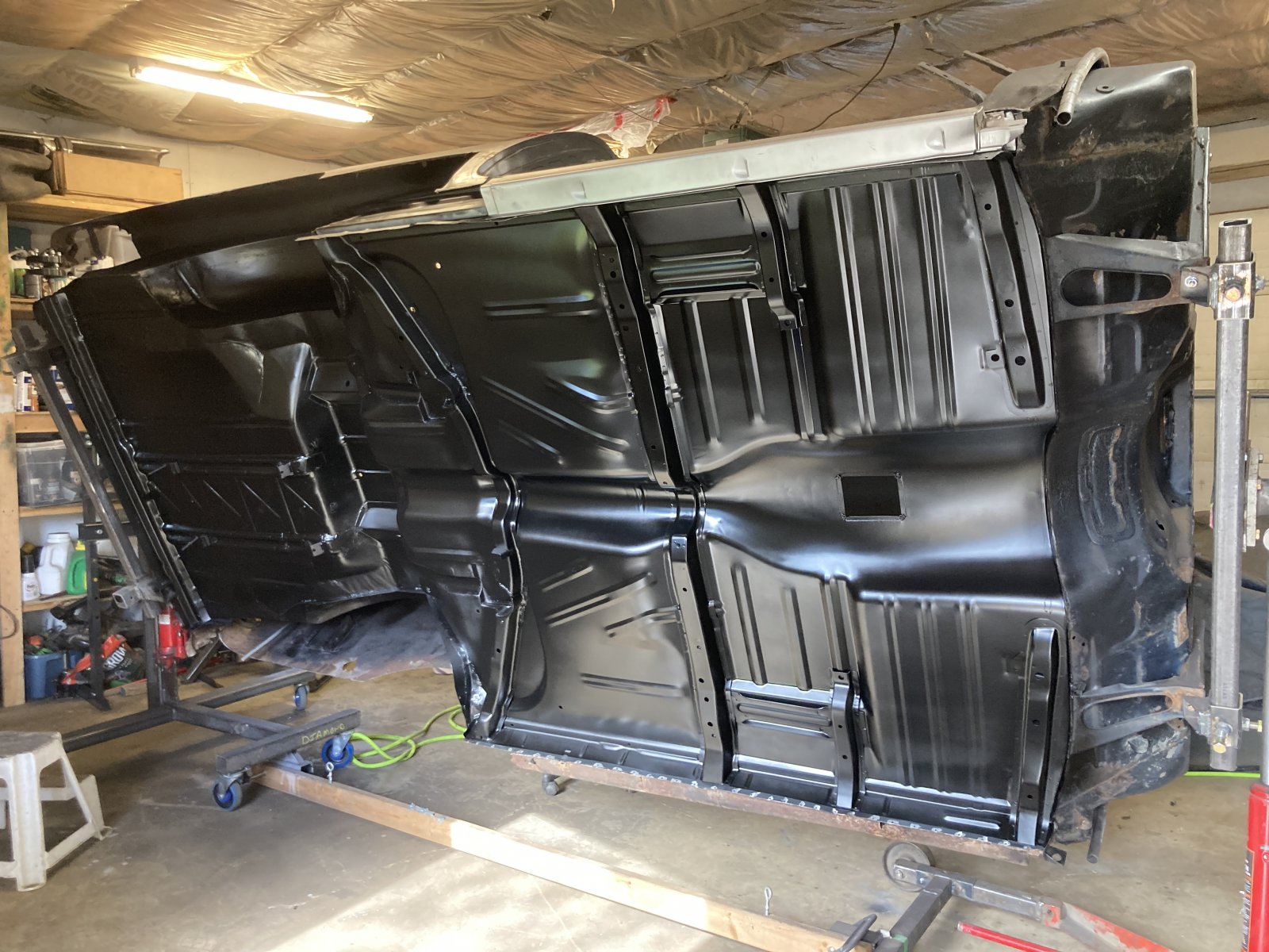

    After hours of wire brush, sanding, stripping discs etc I used Picklex 20 on the pitted parts of the trunk. Hoping it works as good as advertised.
    I used Eastwood epoxy primer, coated inside the trunk, inner roof, floor and bottom of the car.
    I kind of have to do this in stages based on weather and it getting cold here soon.
    The plan in to get the body back on before winter permanently.
    After the epoxy was ready I painted the bottom with Eastwood ch***is stain black.

    I glued and riveted the seals to the outer wheel house. Should stay in place.
    to get the right distance for the seals to firewall I had to patch the front quarters. They were a bit of a mess. I cut access holes to hammer and dolly the best in trim holes.
    Cut and **** to weld the patches in. It works pretty good though seems to leave a little indentation at the weld seam. Nothing worth getting excited about though.
    FBC6DE7A-8089-4ACB-9ED4-595FEBC42893.jpeg 366E71FC-A9AF-463A-AB9D-C9ED98A8DC20.jpeg
    I originally bought complete outer wheel houses but separated them to get the best fit.
    to get the right quarter fit I had to make sure the rocker was right and line up the bottoms.
