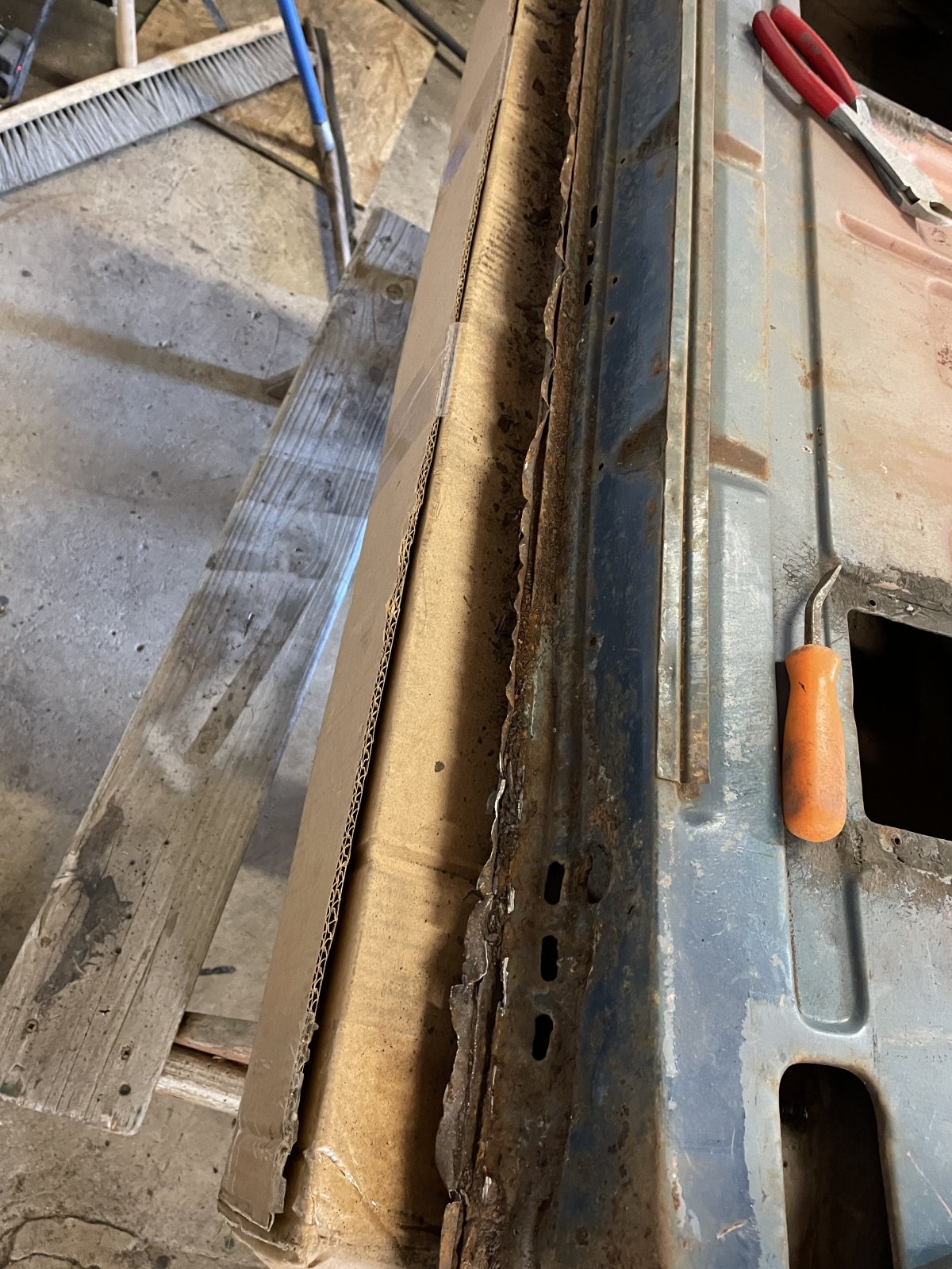

    IMG_7007.JPG The driver side inner needed a lot of saving, I did my best..

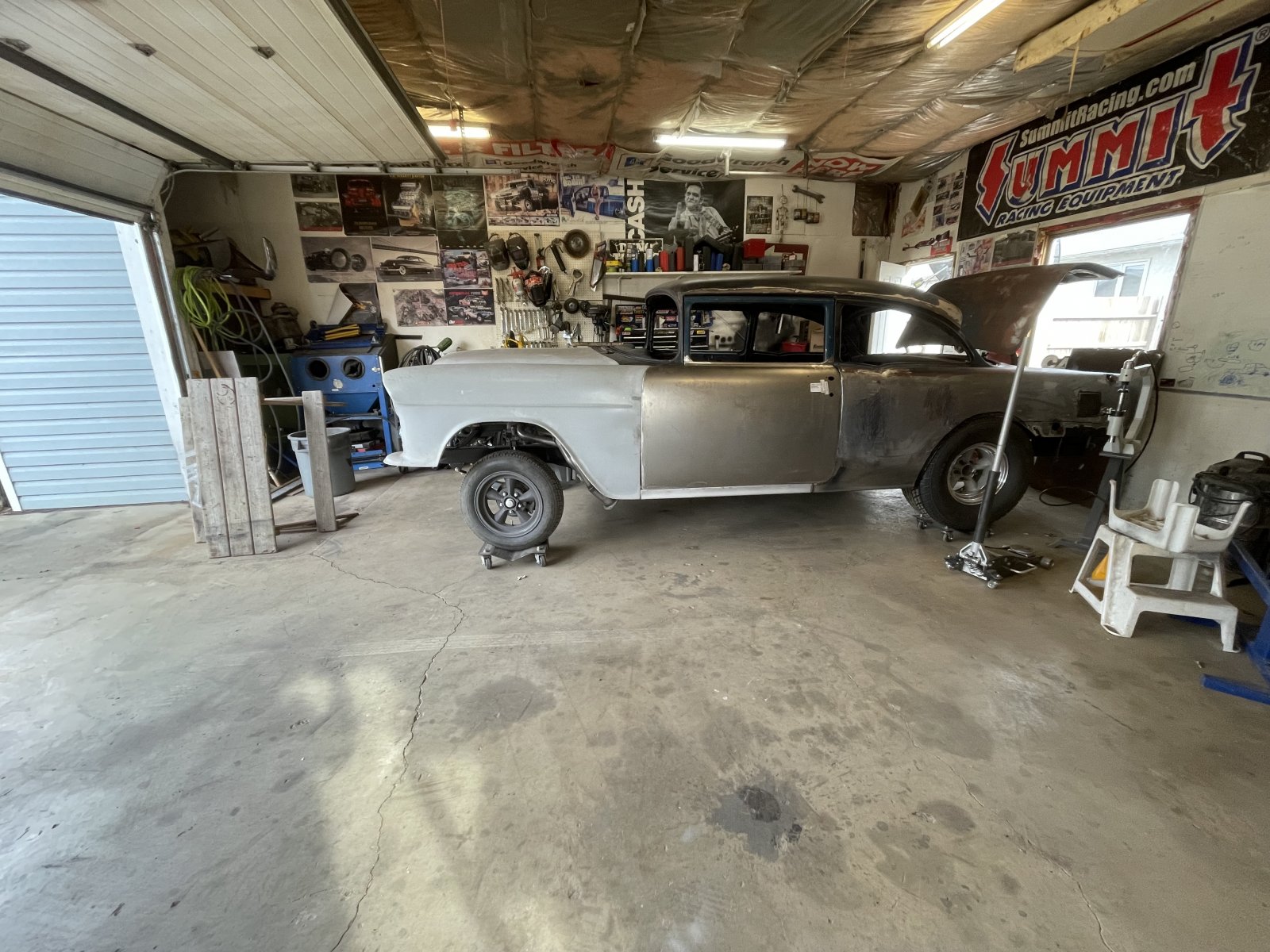

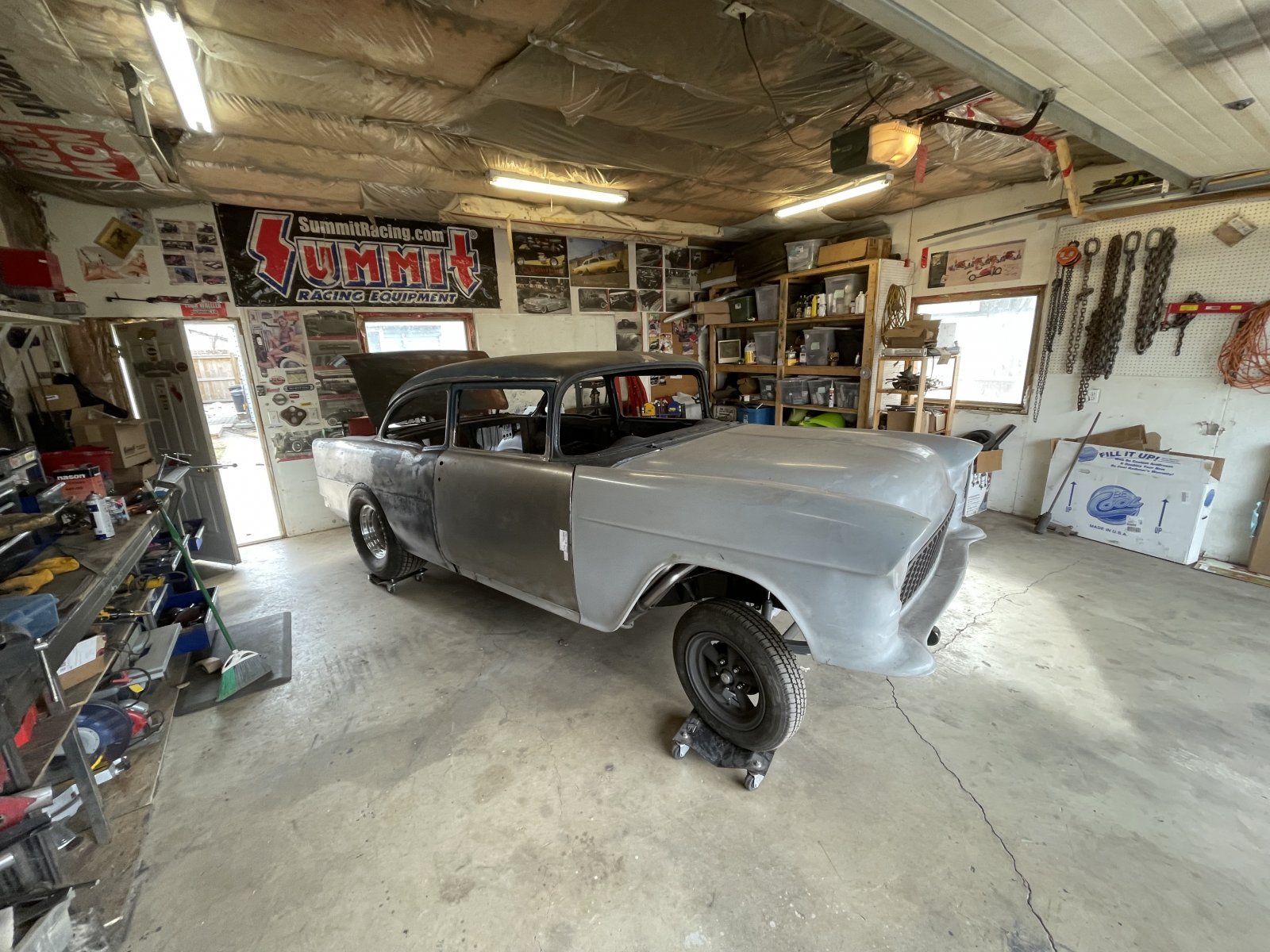

    Here she is showing off her new body parts..
    I had to split the rocker on the p***enger side and lengthen it to match the door. I didn't have room to fit the door when installing it before winter needed to get the floor painted. Rookie mistake, either way I would have needed to modify the pinch weld to the outside..
    So currently planning on getting the other door hinges rebuilt, finish fitting the doors, maybe get the door gaps squared away. I really didn't want to fuss too much and just have a beater, but I think this would bug me too much. The top frames are a little wonky gap wise.
    It'd be nice to finish up the doors and rockers and move on.
    I have to make a buck for my quarter radius's, I have a friend who made up a die for his pull max to match the front beads, hopefully will look pretty cool.
    The goal this year is to get it in one color, primer or if time allows paint. Either way will be big motivation.
    I really like the look of this thing.

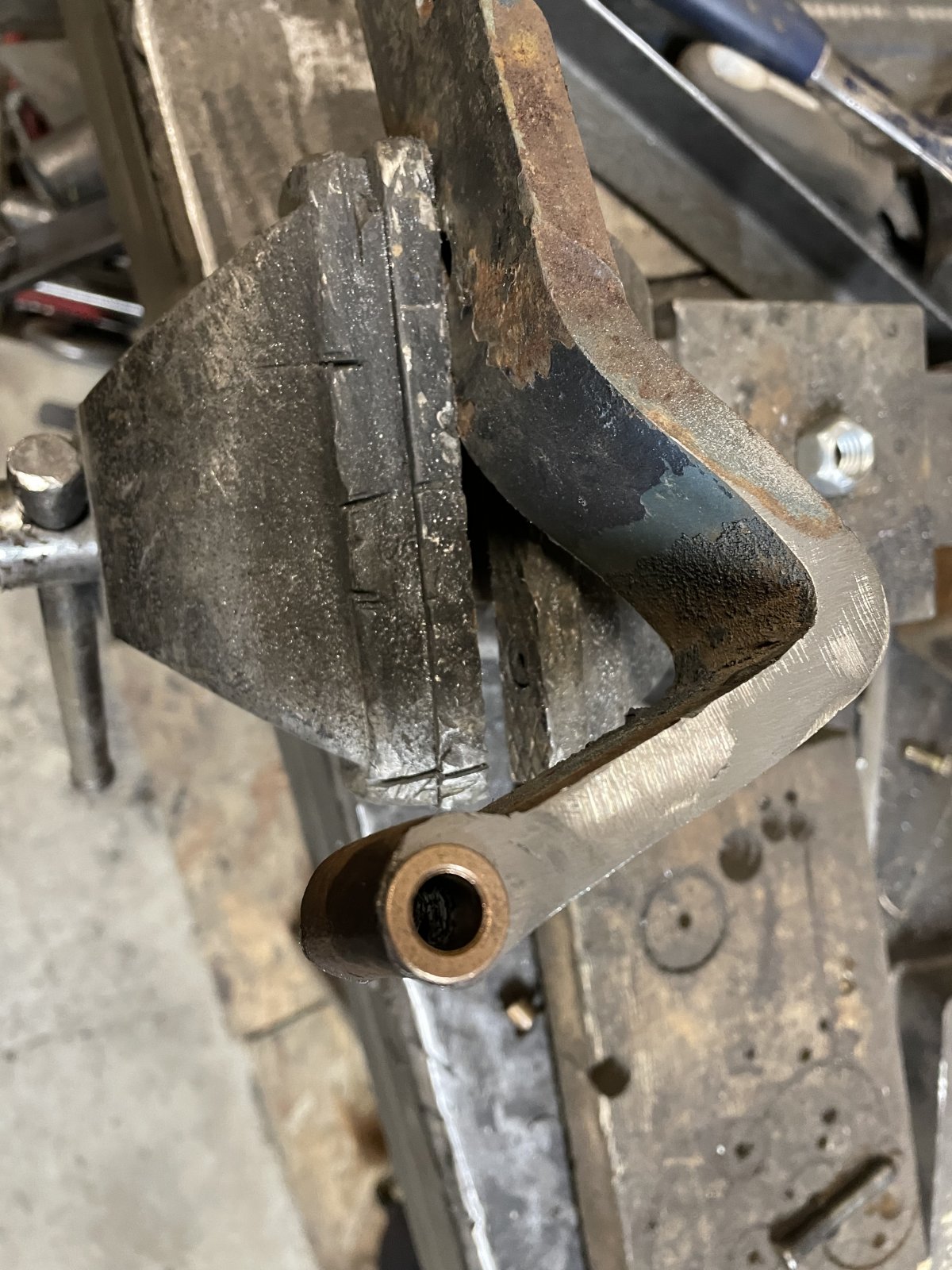

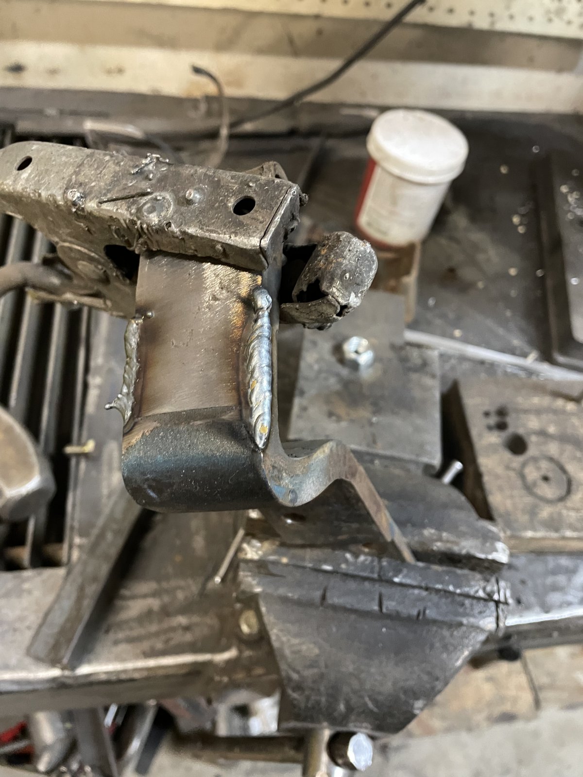

    I snuck out last night and rebuilt the last door hinges. This side the pin had half fell out. This reinforced that I’m not entirely dumb to be spotting welding the pins in.
    I welded up the wear spots and smoothed everything out, new bushings and good as new… almost. I used common Chevy bushings and drilled out the holes slightly to allow them to press fit nicely.

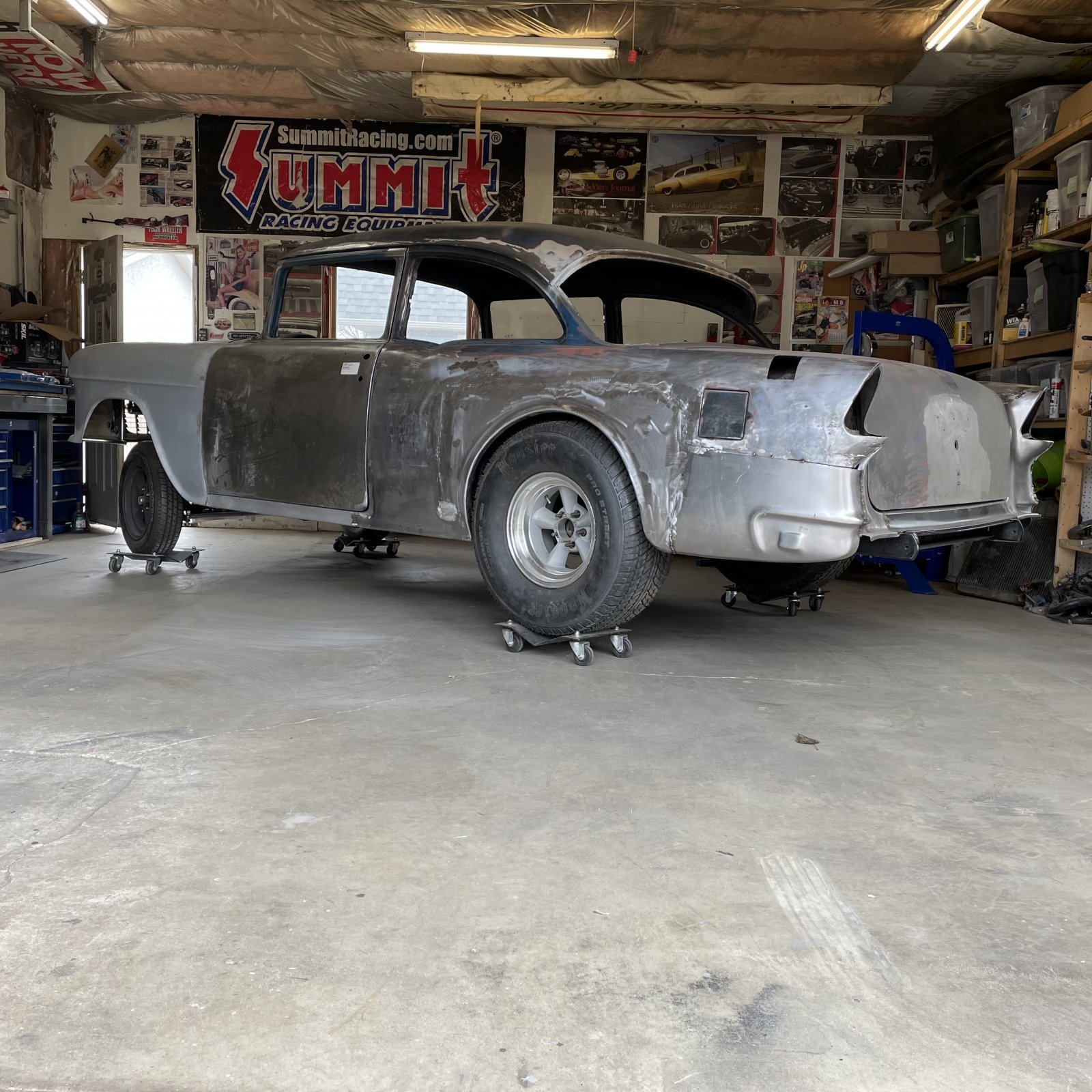

    Sunday I was able to get the tailpan on, and the trunk latching again.
    Still a day or two of work back here to get it somewhat acceptable.
    I'm trying to get rid of all the overlapped leaded seams and **** weld it all.
    But its progress nonetheless, and glad it doesn't have the gaping hole in the back anymore.
    Once I get the back quarter patches roughed in and the wheel wells made, it'll resemble a real 55 again.

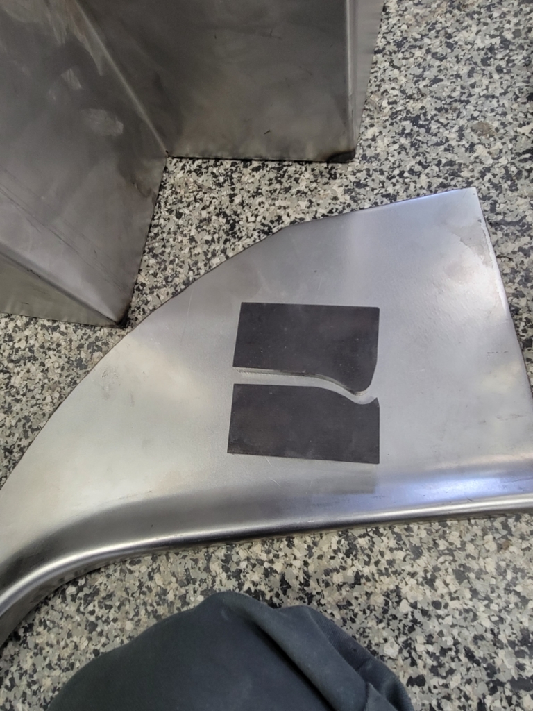

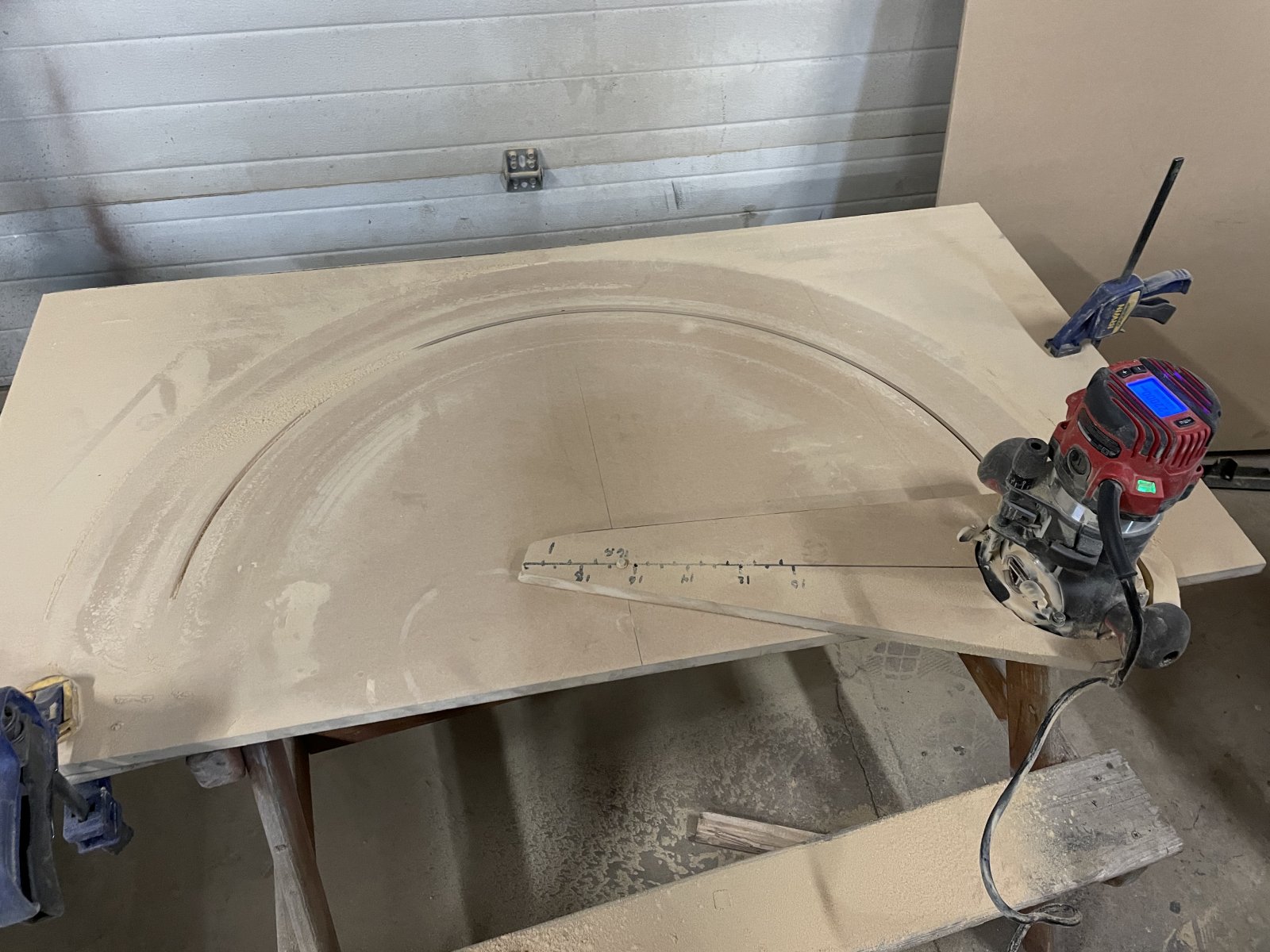

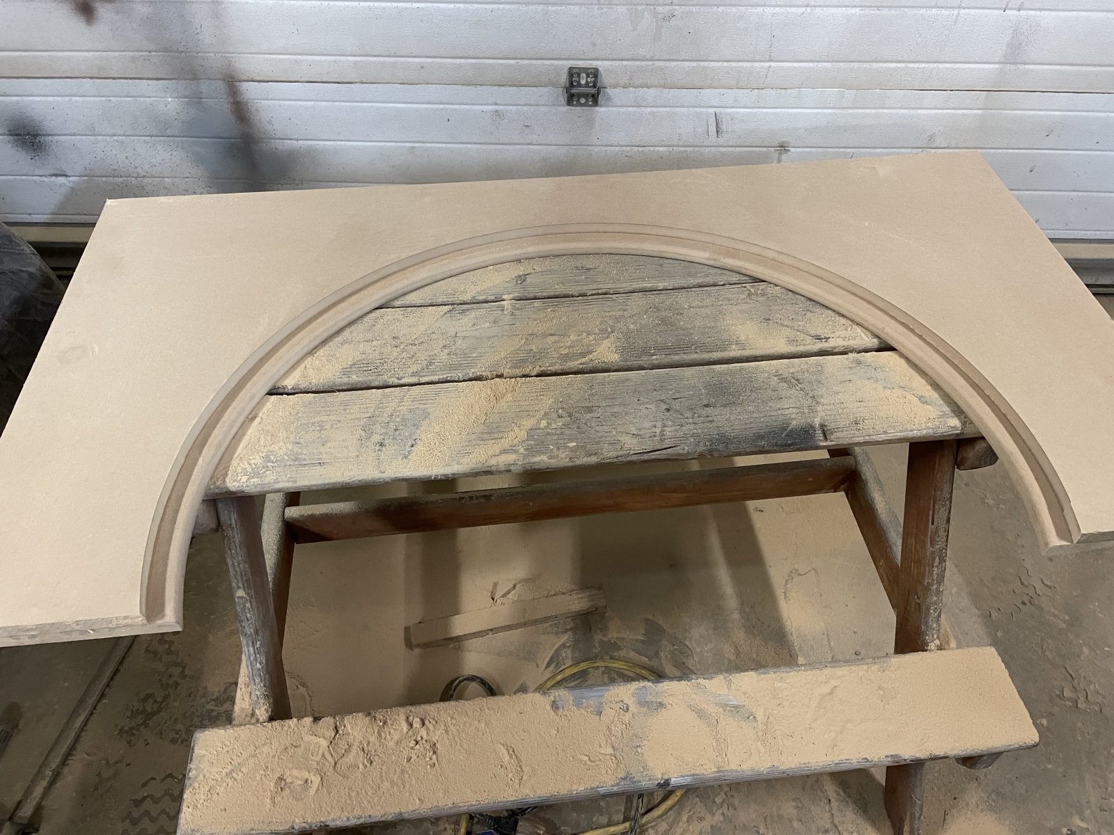

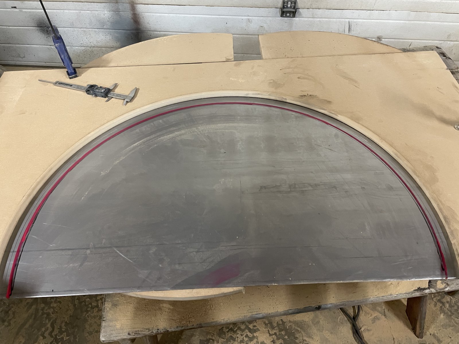

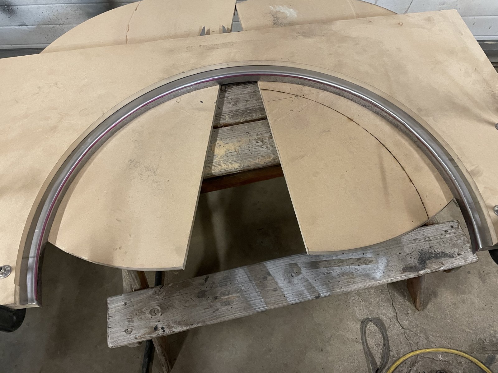

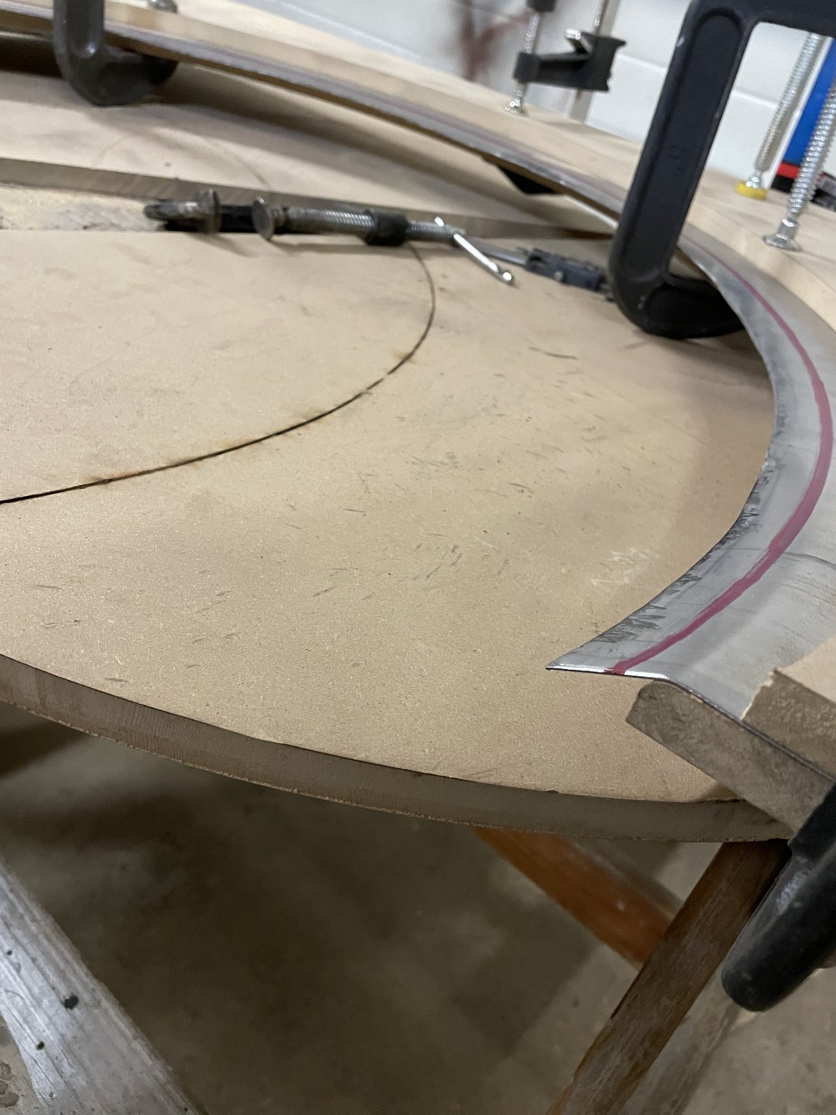

    The start of my wheel radius. I bought a router and some 5/8 mdf, made a little circle jig and cut two slightly different diameter circles. The bottom piece I used a 1/4” radius die for a rounded edge.
    i used it as a guide and free hand cut with the die grinder my 18 gauge sheet metal.
    With a couple hours of hammering back and forth I had one finished.
    I’m pretty happy how it came out, still one more to make then power hammer to try and finish the bead profile.

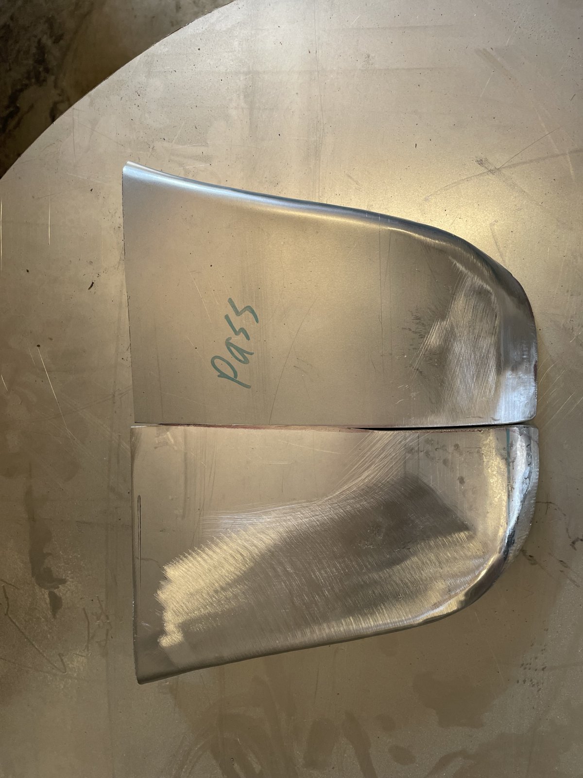

    I finished the other side and started fitting them last night.
    I just used the shrinker to get the body curve. Starting to have a nice look.
    I think they are ready to hit the pullmax.
    I did try to use the air hammer on the second one, but honestly its probably more work than hand hammering, and much slower. I thought it'd knock the panel over in no time, but after 10 mins you could barely see any progress.. Its a little harder on the mdf and the arms than hand hammer. I found when I do it manual, I can slide the hammer off the piece for a glancing hit as well, where the air hammer is straight on.
    I’m going to make some bottom transition pieces separate and see if we can taper the bead off at the bottom, probably go straight down at the front of the tire and sweep back slightly at the rear.
    hopefully I can keep the panel this size as it gets rid of some trouble some spots on the quarter that I haven't addressed yet haha.

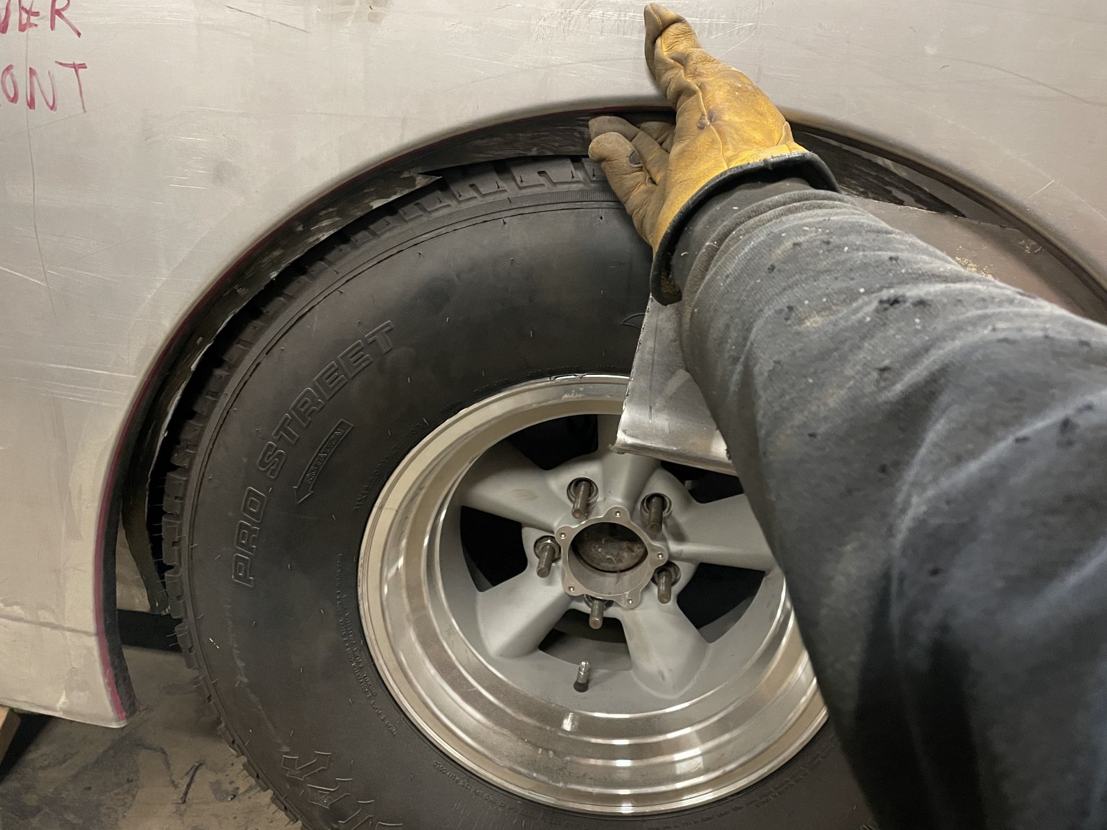

    Test fitting with my jig
    double checking with the tire and "swooping" behind the tire.
    I also cut the front and shaped it straight down so it wouldn't wrap around the tire like above.

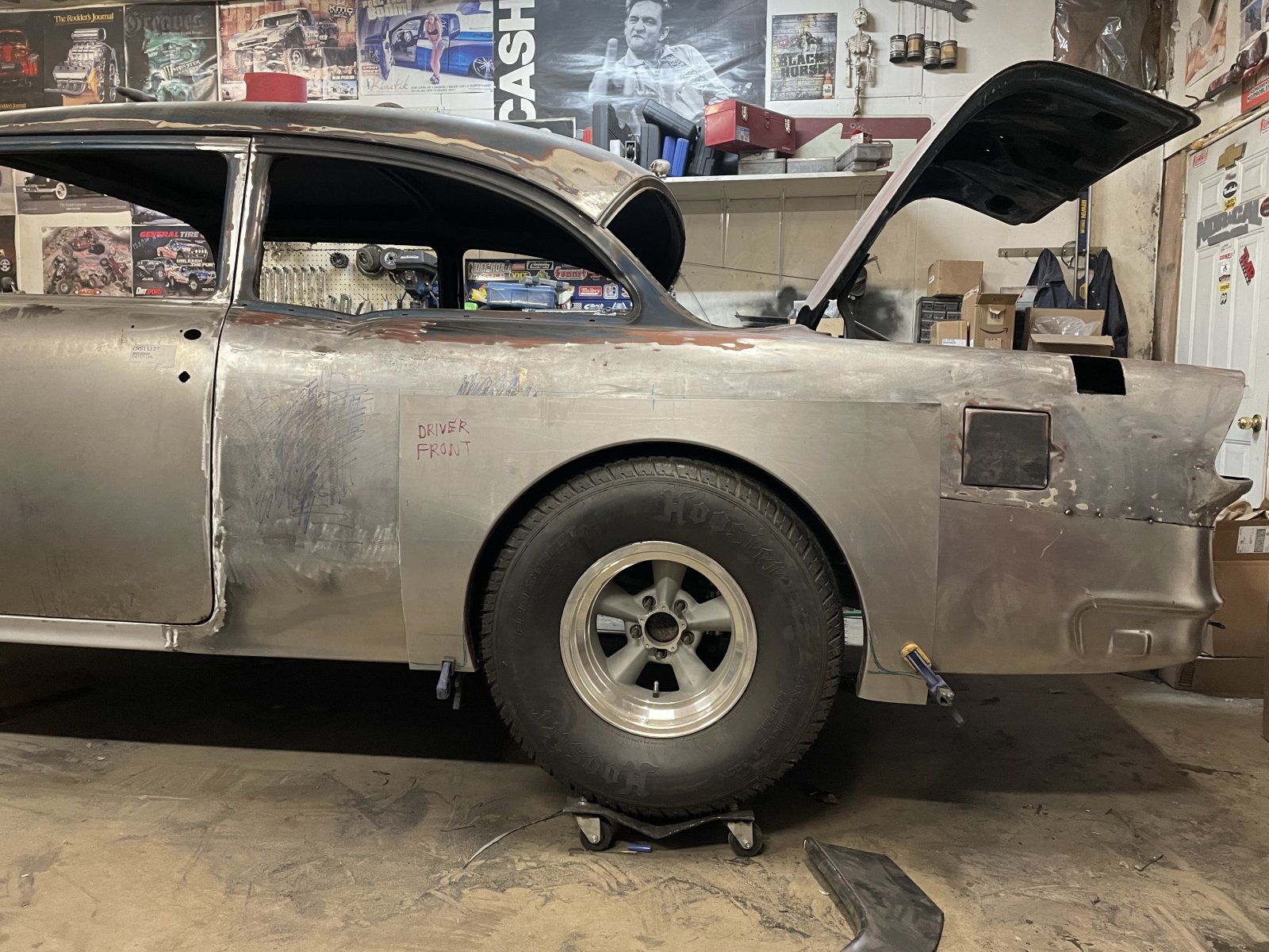

  22. Fry
    Joined: Nov 14, 2002
    Posts: 990
    Fry
    from SK, Canada
    With them all welded in, looks ok.
    Dips in at the top probably more than I wanted but this is good enough for this beater...

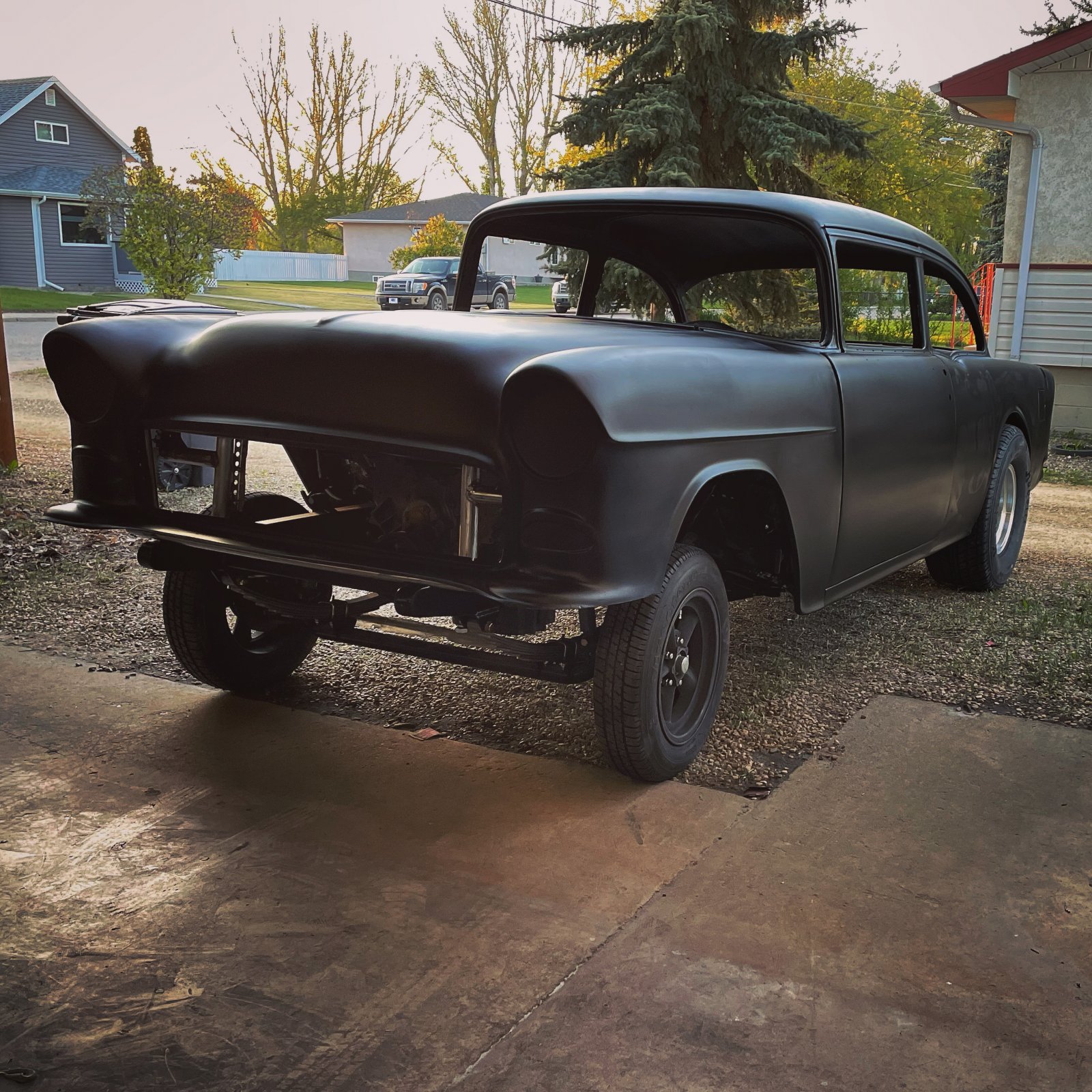

    Started some body work and got it in some epoxy primer. Will keep picking away at the body over the next few months and hopefully have it ready to paint. Lots left to do, but looks better than it did.

    Looks really good! Just know it is probably going to **** in the snow and ice. I spite of your self doubt you have done a hell of a job with the sheet metal.

    One solid color really makes the car look so much better, you have do a excellent job. HRP
