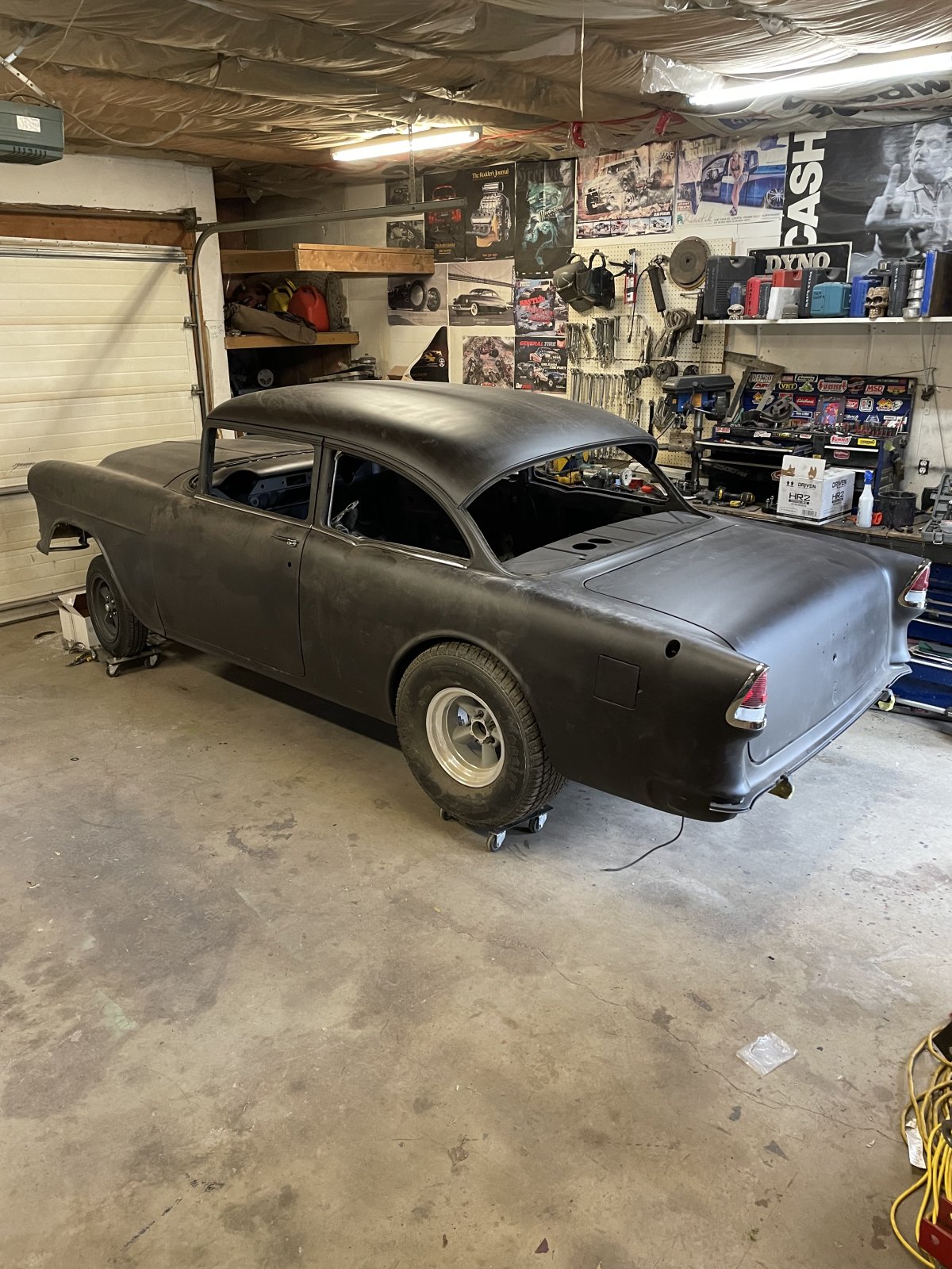

    Well back on the 55. Thought about letting the thread die, as its not 100% hamb friendly.. but reviewing it, there's a lot of good info on here that should get updated and added to.
    I've had it wrapped up for the last year, kind of got burnt out and sick of it. Parts pricing has blown any hopes of a budget, I don't have swap meets around here to get parts, so I just forgot about it for a year.
    Blowing the dust off..
    In an effort to get some motivation I figured I will just run it in primer for awhile and start installing the boxes of parts I have taking up room.
    I installed the trim on the bottom of the window. I think it breaks up the drab of the all black.
    I noticed I forgot to drill the holes in the drivers door..
    Headlight buckets, signals installed. I thought about adding backing plates but the fibergl*** is so thick in that area, I don't think it is needed. The car didn't come with most of this stuff so buying all the light ***emblies and stuff has been killing me.
    Taillights installed, I spent a lot of time getting the gaps out during body work, they aren't a perfect fit, could have spent days on that, but good enough is sometimes good enough.

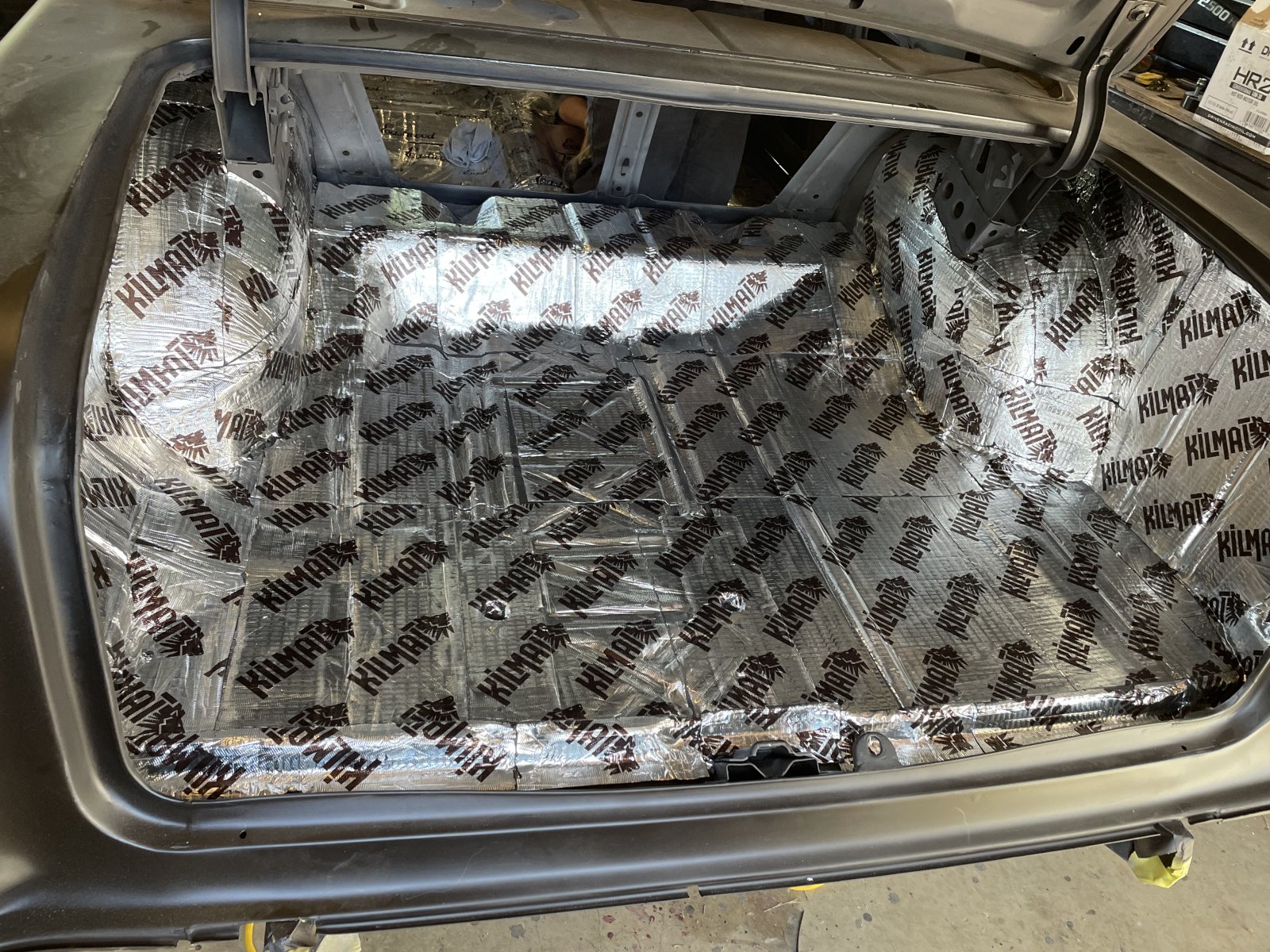

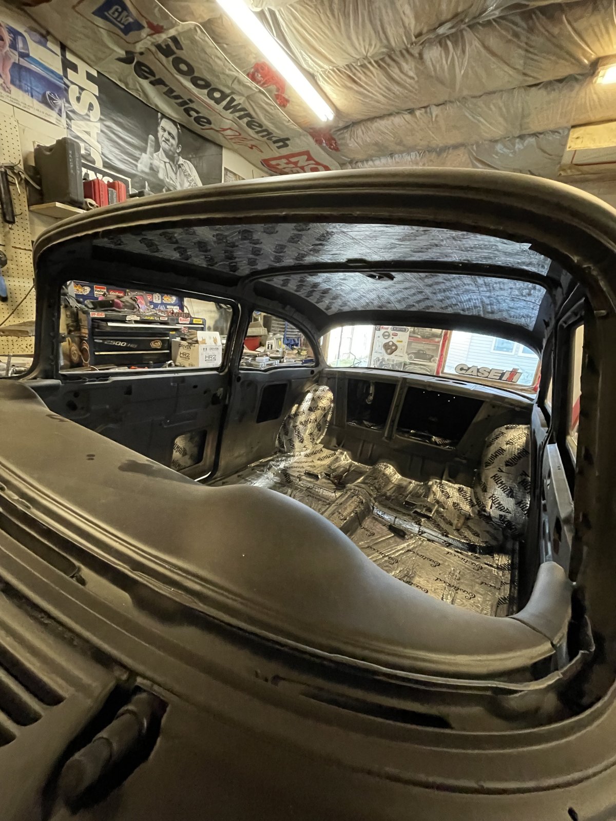

    I talked the kids into rolling out the sound deadener with a promise of some ice cream, I got the better end of that deal. I want this to be a pretty good street car so it has to be a good road tripper and daily driver. Eastwood sound/heat for the main floor, and cheapy kilmat for trunk and roof.

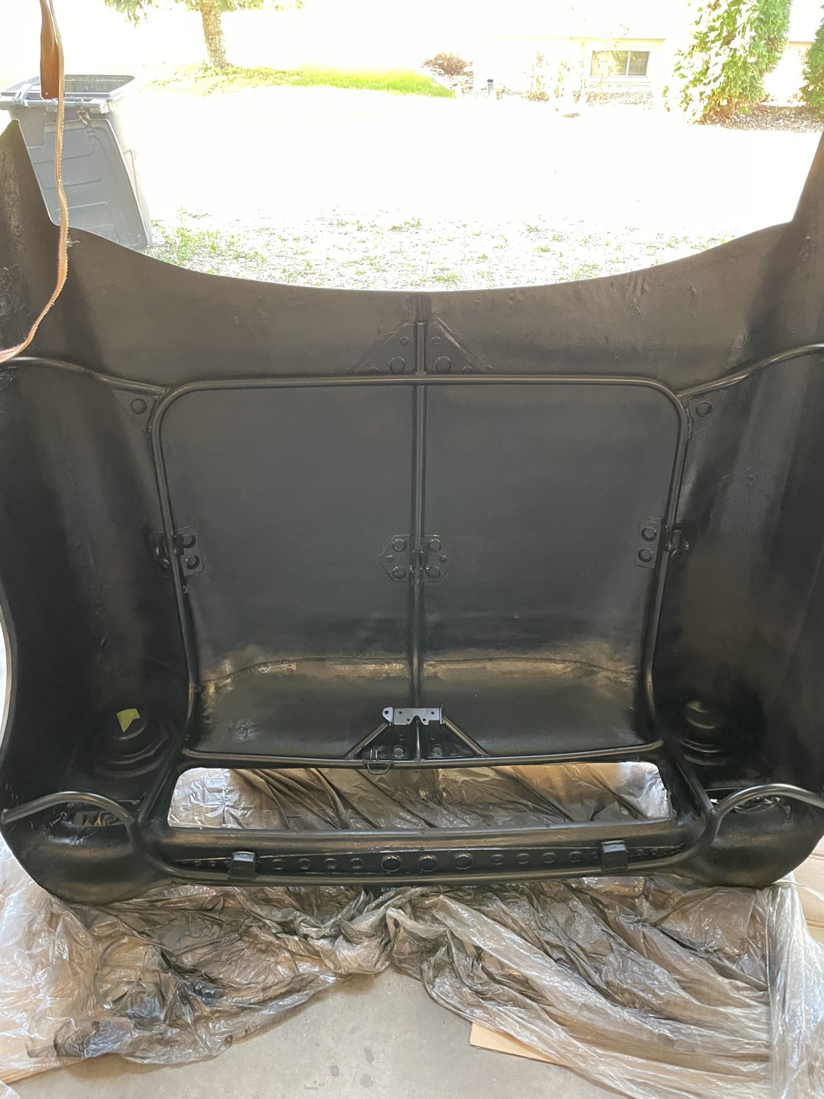

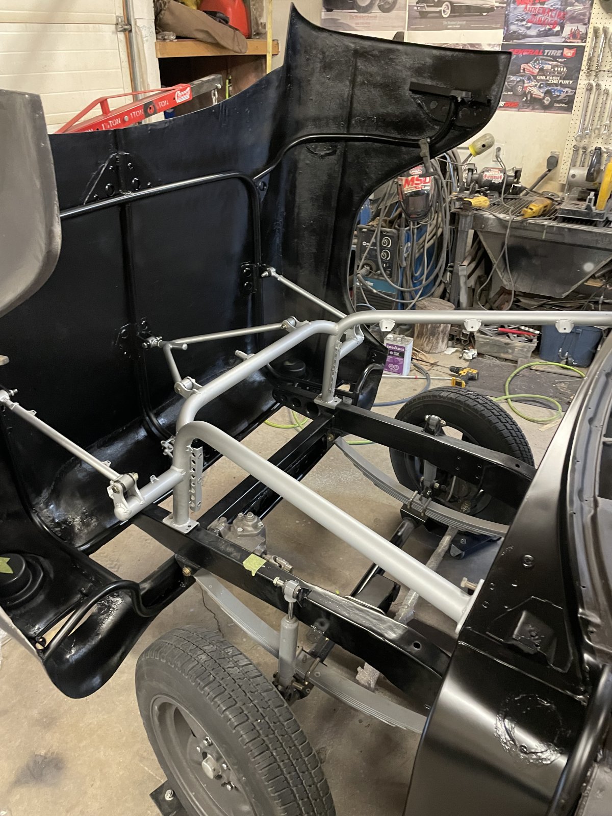

    I stripped the frontend and painted the firewall and inside the hood ch***is black.
    This eastwood stuff just looks great.
    I also splashed some on the dash.
    Before priming I shaved most of the firewall, I don't think I mentioned that earlier. I added the required holes for the steering column and brake/clutch M/C.
    I really didn't want street rod smooth, but instead a factory stamped look.
    I don't think I showed the hood latch before, I added a striked at the top of the engine bars and use this, works pretty good. The handle is hidden behind the grille.

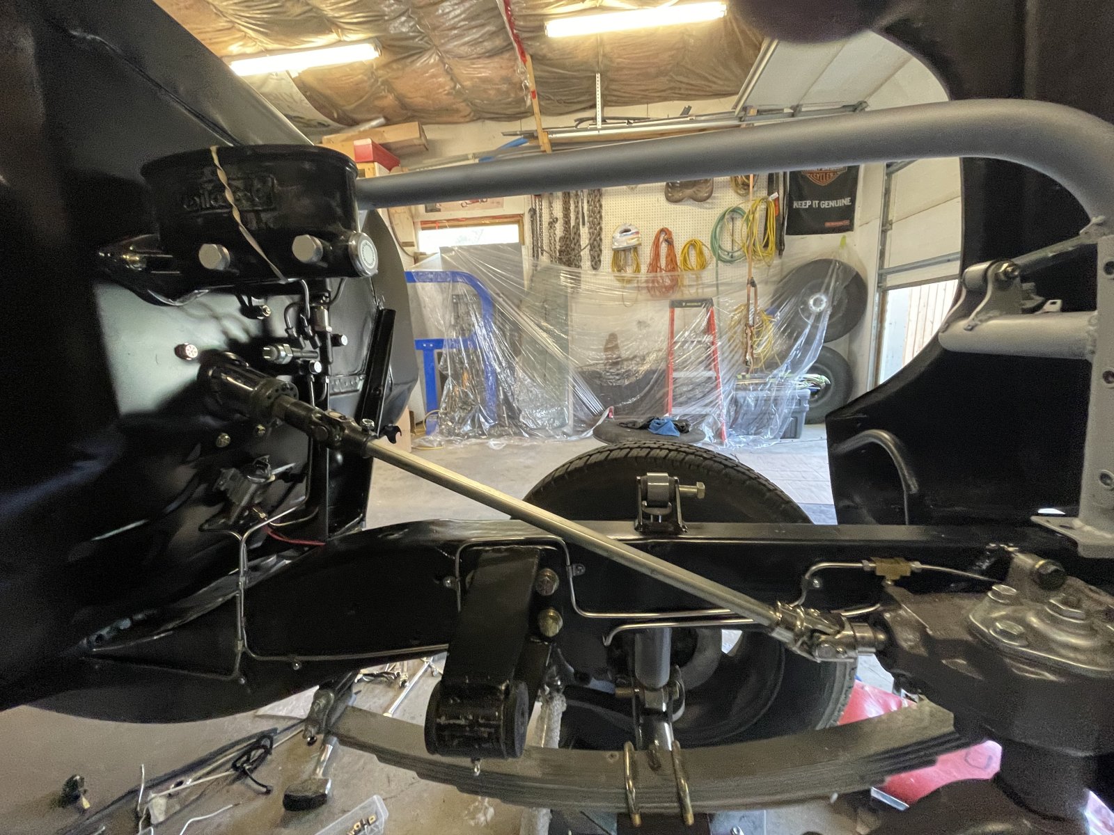

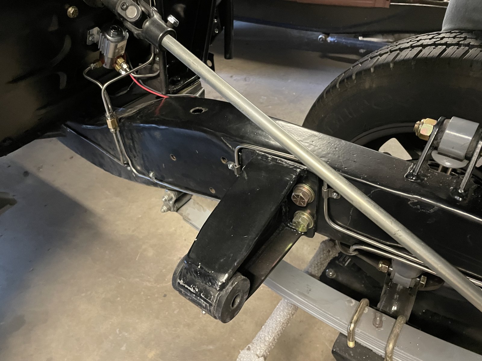

    Finished up the brake lines, all stainless, wilwood reservoir and pedals.
    Between the K-line brake flare tool and this straightener, brakes lines are actually pretty fun to build.
    Installed the rear discs just like two lane blacktop lol.

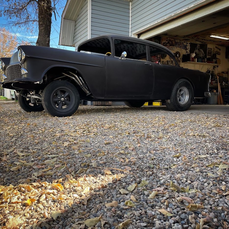

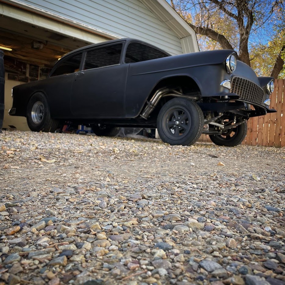

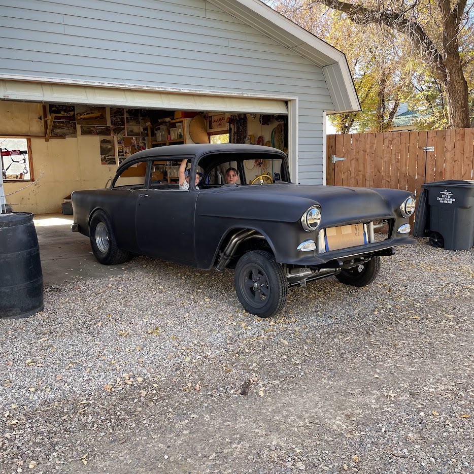

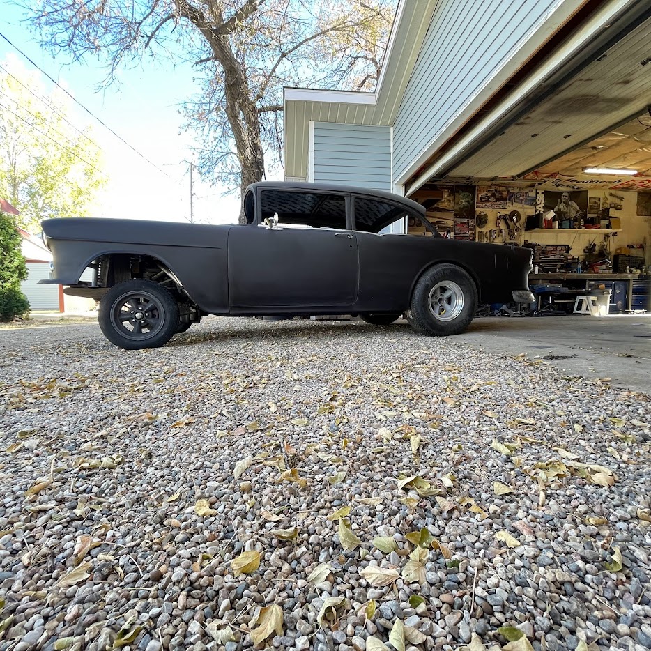

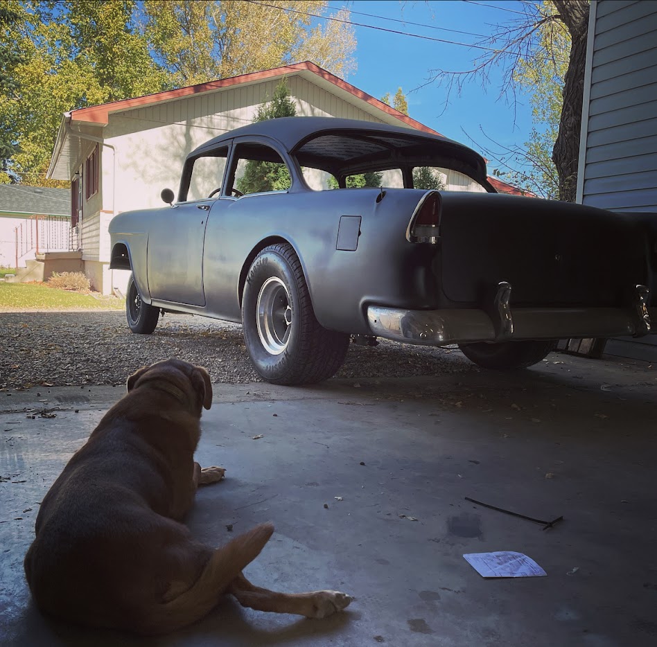

    last pictures before I had packed it away for winter last month.
    4E143844-B66D-413D-99A0-C8C999FC6725.jpg 610736EC-D811-4323-8AA6-67B9209003C2.jpg E300E605-98CC-4CD7-B5D5-960B88295806.jpg IMG_0784.jpg IMG_0791.jpg IMG_0834.jpg
