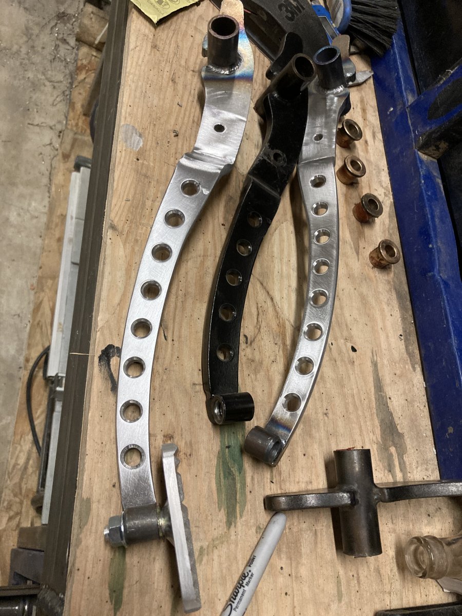

    I also got new pedals for my swinging pedal setup, Rjays sent me new arms on their dime for a better ratio on the brakes, since I didn't think I had enough leverage. I cleaned them up and drilled them to match, also went ahead and bought some moon pedals that I had been craving since the beginning of the build but couldn't justify.

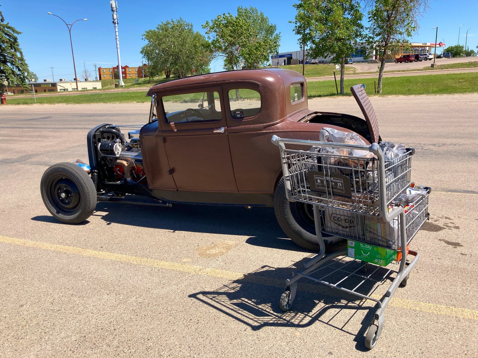

    Grocery getter
    Teaching the daughter to drive a old hot rod with manual steering, brakes and a 4 spd.

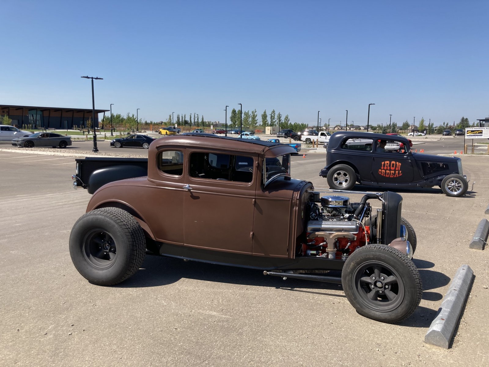

    Couple of snaps from lethbridge street wheelers cruise weekend.
