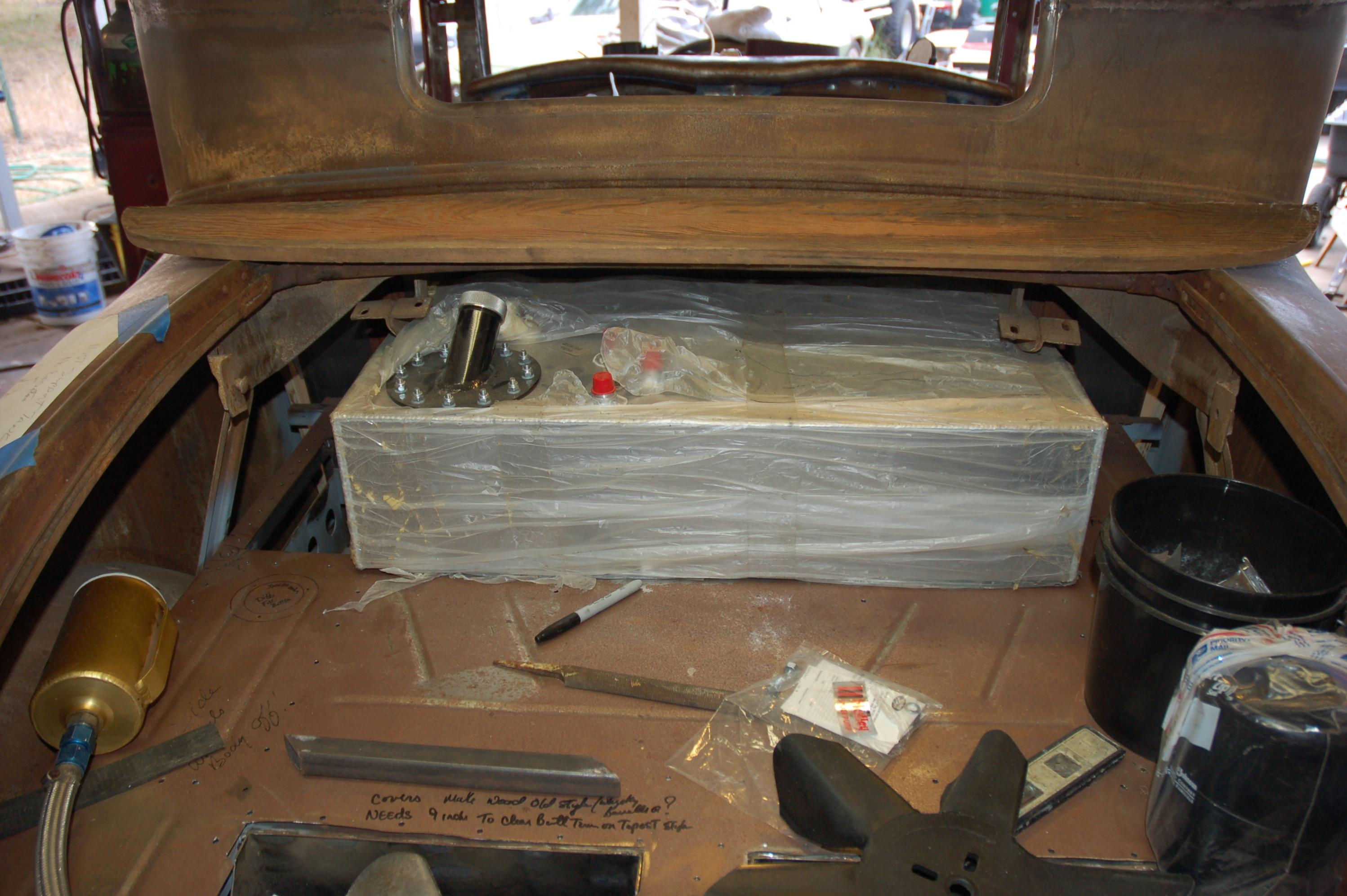

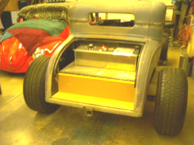

  26. i just thought it was a good idea to keep the gas tank and smells out of the passenger area, so I built a barrier between the cab interior and the trunk area where the RCI fuel cell/tank is. And it was just about the only place left to put the tank anyway as I dont feel real comfy with it hang out the back ala 32 style.
  27. forgot to add the pix of mine....sorry. here they are

    Nice job. Gary
