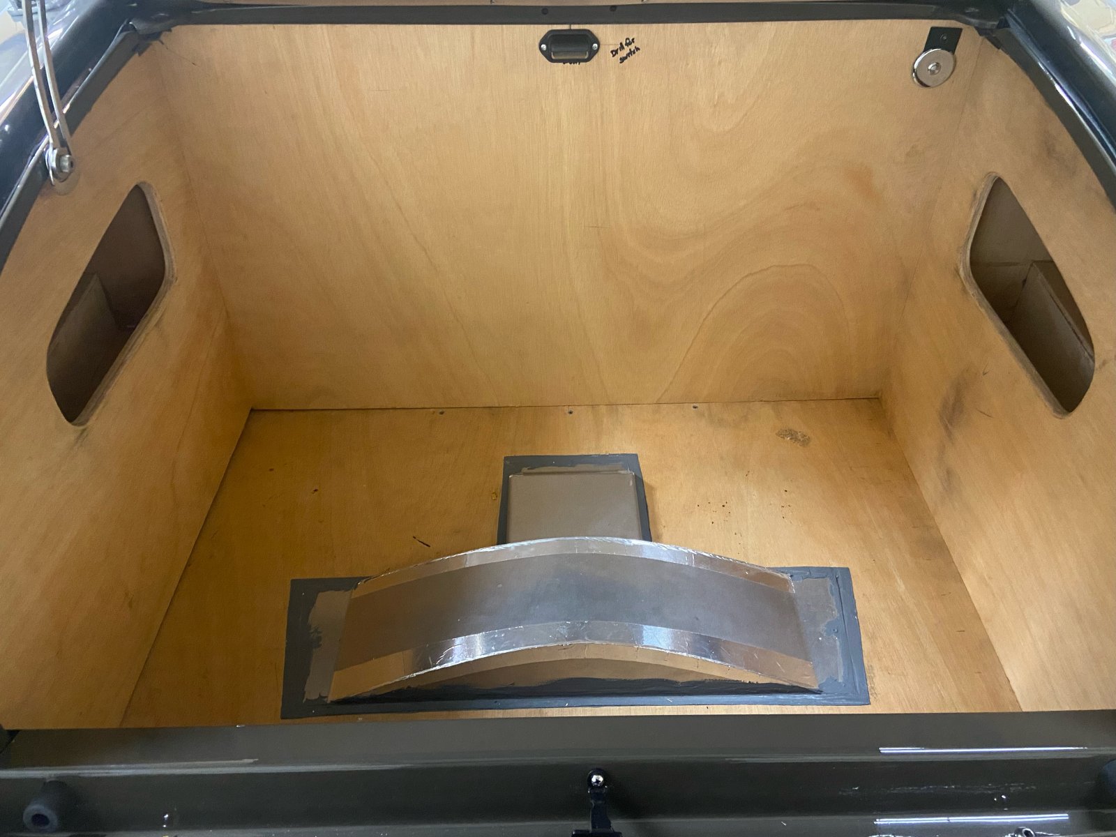

    Not a fuel cell but I used a 14 gallon tank from Tanks standing up in the front of the trunk which allowed me to maintain a decent sized trunk. ‘32 Ford five window. IMG_4037.jpeg IMG_1519.jpeg

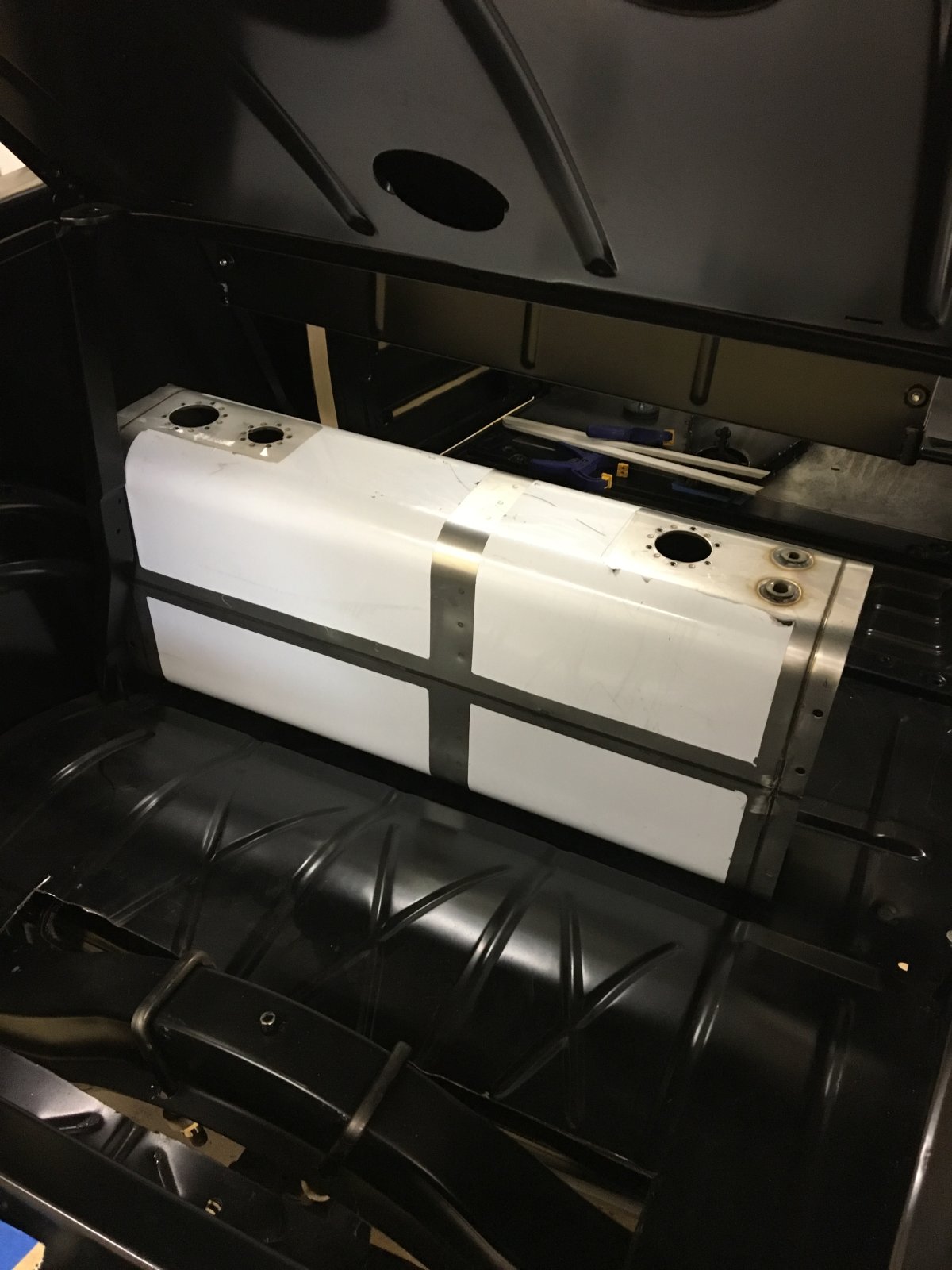

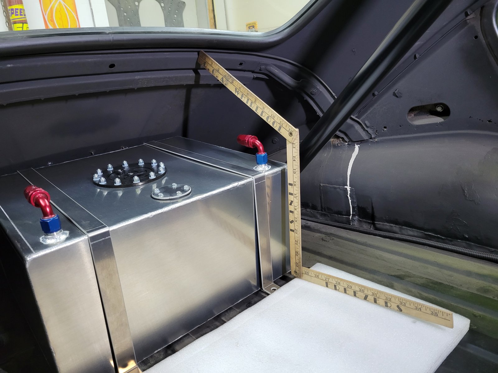

    If you want to a vertical tank behind the seat, I'd recommend a 17-gallon RCI #2171.
    It's only 7" thick so you retain some trunk space in your coupe.
    Mine fits behind a firewall that's behind the back seat in a Tudor sedan.
    20190506_183033_HDR(1).jpg 20200513_165740.jpg tank 01.jpg tank 02.jpg tank 03.jpg 20200222_104543~2.jpg
