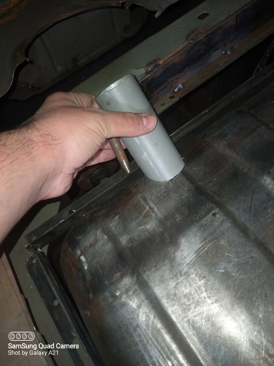

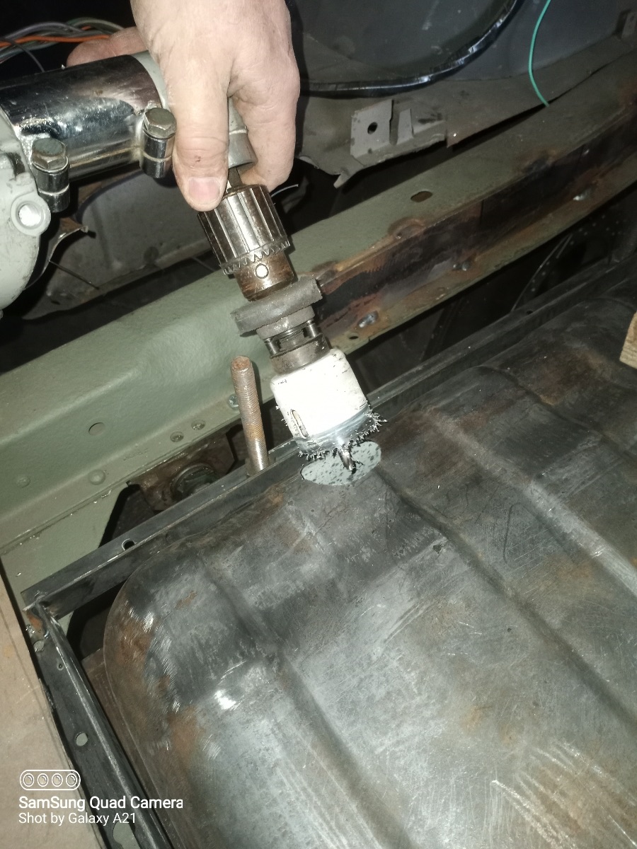

    BA408D67-7A6A-4880-B658-5CDA8EB8BCDC.jpeg FFF2E7CF-14A8-4186-88BB-E6C444731829.jpeg A17047AF-8F66-4097-82D4-2EA8FDF43263.jpeg I discussed welding gas tanks in the seventies, due to a mishaps in a McDonalds parking lot. But why would some crazy **** drill a hole in a used suburban gas tank, to change the filler neck location in 2022, to increase his fuel capacity, and weld the new filler neck and fill in the old filler neck hole. Why, because it can be done. I do it all the time. I don’t give a damn what anybody else has to say about welding gas tanks. Let’s review, I’ve been doing it since the seventies. Side note, I drove the suburban in to remove the gas tank. Fresh gas.

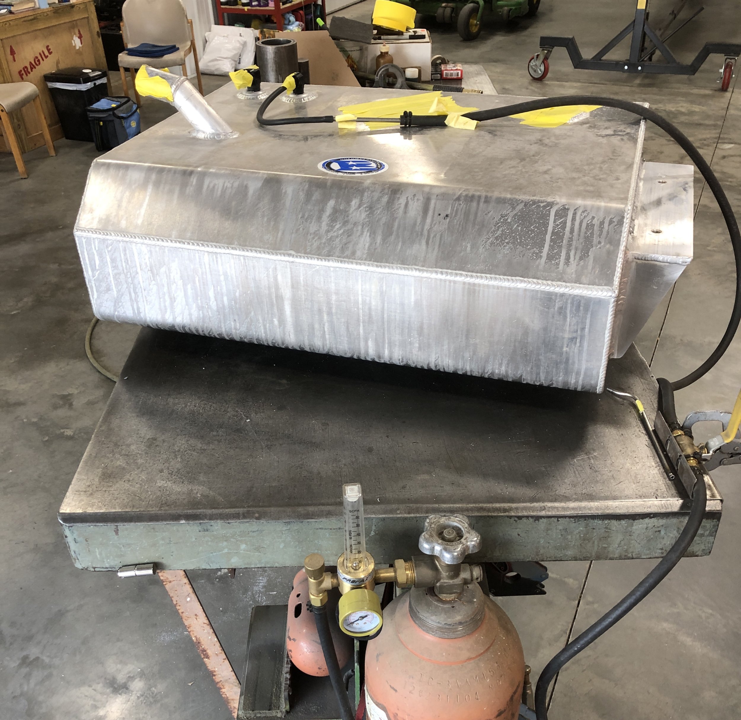

    This is how I did it just today. Purge with straight argon while welding. IMG_8881.jpeg

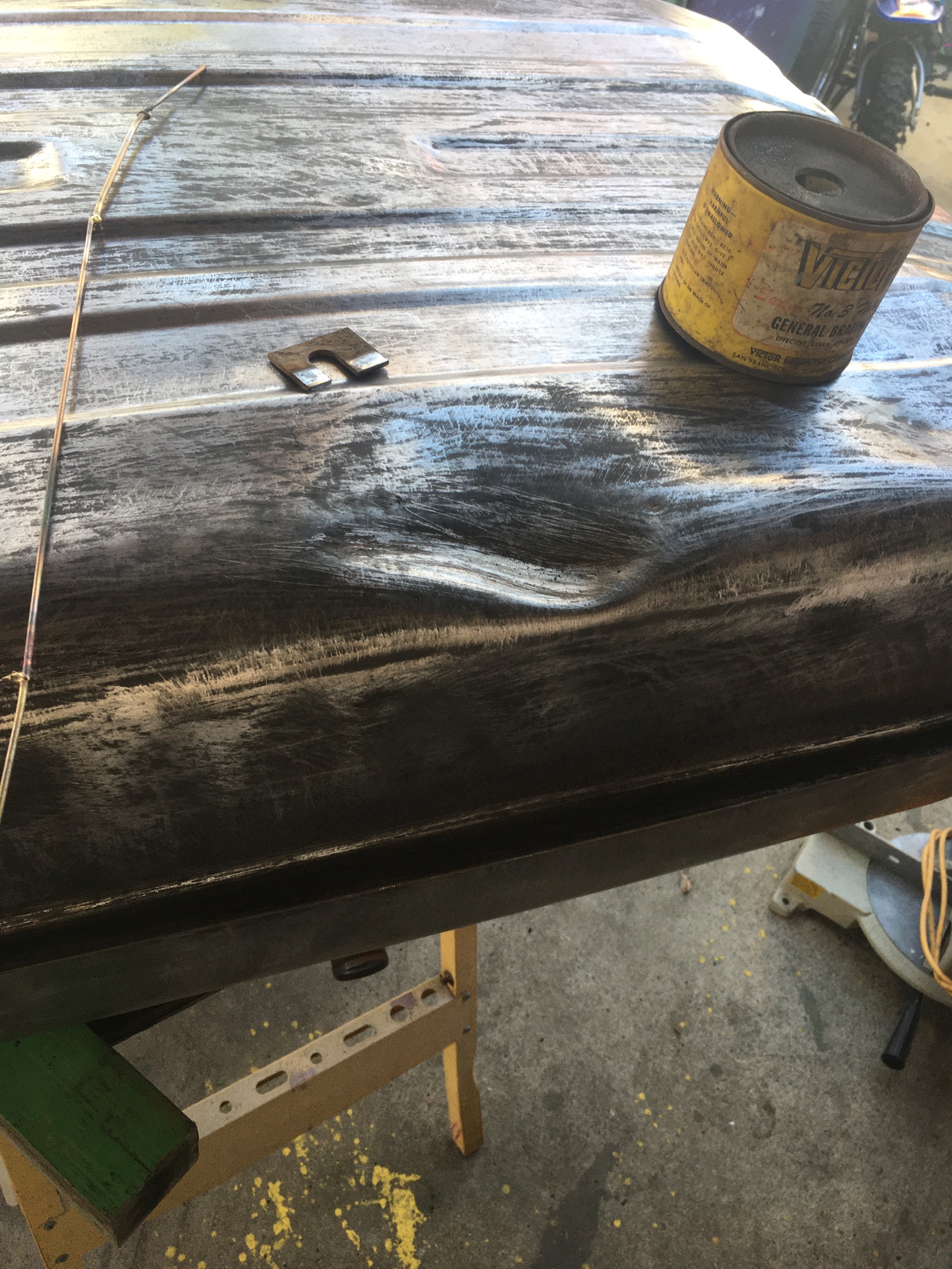

    Another one, for the, FIX-IT CROWD.

  29. ronzmtrwrx
    Joined: Sep 9, 2008
    Posts: 1,709
    ronzmtrwrx
    Yes. Drained it, pulled the pump and sender out of it, then I sprayed some whitewall cleaner in it and power washed as best I could. I then put a water hose in it and let it fill up and run over for ten minutes or so to shove all the whitewall cleaner out. After all that was done, I let it sit in the sun for a couple days to get completely dry. Then purge and weld. Honestly, it was probably clean enough to weld without purging, but back purging is necessary for good results when welding aluminum.
