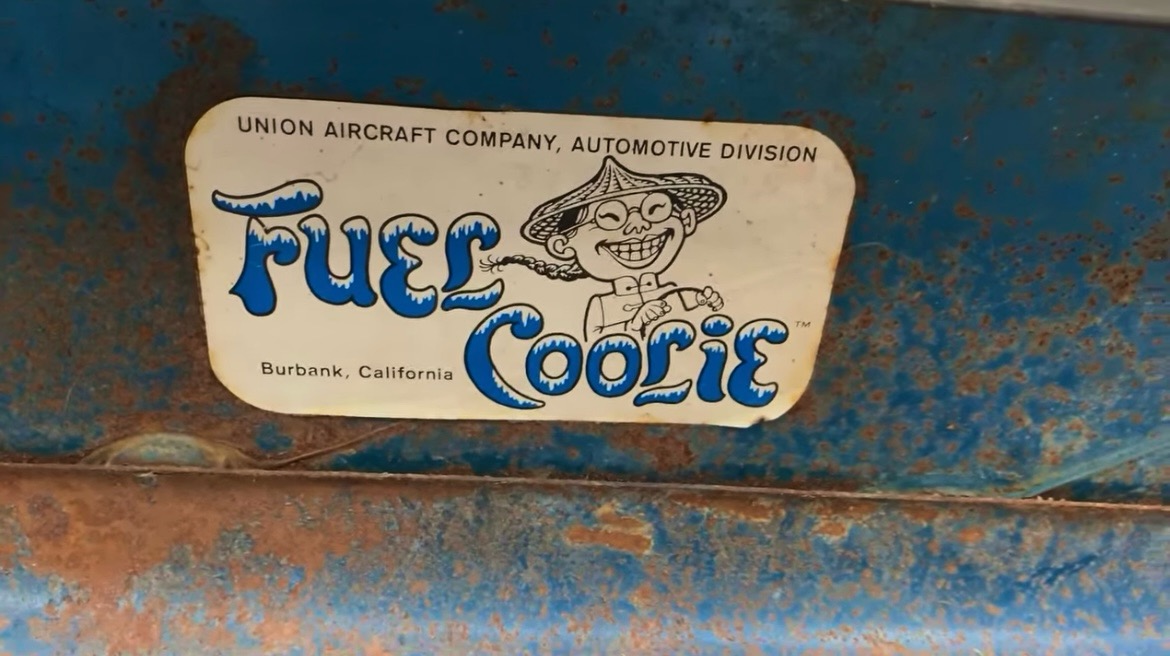

  1. These were available in the 70’s and maybe earlier and were used to cool fuel to prevent vapor lock - it was a bottle with copper tubing out the top mounted close to the radiator in front of the engine.

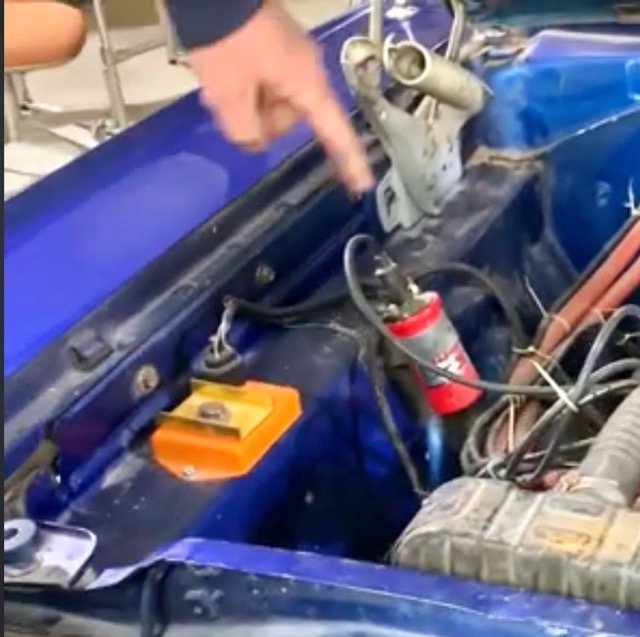

  8. The finger belongs to the owner of the car I transported - he is pointing to where it was located in the front right engine compartment next to the radiator.

    I recall seeing that very decal or sticker, probably in an age-old parts ad for that product, the likeness of the little Asian character & the Coolie name relates to the Asian common labors as the product was perhaps made offshore by the industrious little guys.
