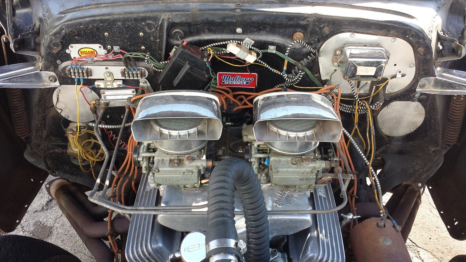

    My g***er has a 327ci motor and the edlebrock intake installed back in the late 60's with two 1850 holley's. I thought I could run this setup and keep the vintage parts and pieces in place from back in the day. It is now clear that this setup flows just way too much gas. I just don't think any jet changing or other mods to these carbs will balance out this setup.
    One option I have is to swap out the original 600cfm carbs for two 450cfm Holley's. So I've been looking for other options for not a ton of money. I have found several Hilborn FI intakes w/stacks for about the same money. I like this look very much but have no experience with this setup.
    Which setup will not require lots of money and primarily have the highest percentage of working as soon as it is bolted on. My 327 is stock bottom, aftermarket cam, 1.94 camel back heads and fender well headers. Odds are the 450 Holly's will require some dial in time but what about the Hilborn equiptment, easy to dial in? not a lot of moving parts? Your input is appreaciated. View attachment 3296663

    The issue would be that it flows too much air...not too much gas...something about how carbs work, they only provide as much fuel as the airflow requires.
    But with proper gearing, etc you might be able to get away with two 1850s. Are the vacuum secondaries still functioning like they are supposed to? Pictures...please!
    Hilborn mechanical injection is going to be a bit more of a challenge to get working, than a pair of good old 600 Holleys!

    I pretty sure my power valves are blown as I do get some backfire. Other than that the motor just fouls out the plugs in one run, not to mention misfire. Anything above 3000 rpm is ****.
    These are first generation 1850 Holly's, probably installed late 60's to early 70's. Intake is an edlebrock X-C8 crossram. So, I did not say too much air, I think it is too much gas.
    Do I try to work with these 600 4bbl's or try something else. I really want to stay with parts from the day.

    Rebuild the carbs to list number specs, make sure the ignition is good and timing set and report back..Those 1850's with vac secondaries make it hard to over air anything (almost)..

    Looks like you have some sort of flat air cleaner in those scoops over carb throats? If so, give it a run without them and see if anything noticeable happens. I am always deeply su****ious anytime I see a Briggs&Stratton sized filter of any sort on a hotrod.

    In all likleyhood , some well meaning individual have messed w/those carbs , take them apart & see what's been done & undo it if possible , there's no reason you shouldn't be able to make that setup run decently on the street or strip ..
    BTW , hardlines from the firewall mounted fuel block to the carbs isn't a good idea, somethings got to flex...

    The picture I posted was an old one taken when I first bought the car. Fuel pump on the firewall was replaced with a new one at the tank in rear of the car. These are new pictures with dual springs and same fuel block, new valve on firewall. I love the look of the hard lines and left them as they work. The carbs are setup to work simultaneously not progressively. DSCN0450.JPG DSCN0451.JPG DSCN0452.JPG DSCN0453.JPG

    Someone has put 50cc pumps on them fairly recent, like was said double check your ignition components, replace your power valves, check your timing and tell us what's happening.

    Man, I know you like the look of those hard lines but that is definitely a disaster waiting to happen. They WILL stress crack at one end or the other in time. Gotta get a couple pieces of hose in there somewhere. Just trying to look out for you and your ride, not burst your bubble.
