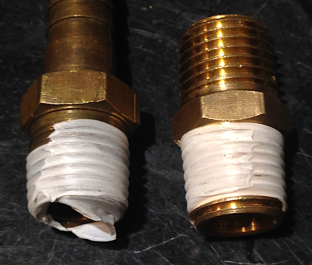

    PTFE tape applied like the right is correct .... left is just wrong.
    I grabbed photo from the internet, imho, the right needs 2 maybe 3 more wraps. They just did one wrap for example.
