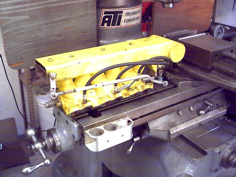

  22. RichFox

    RichFox

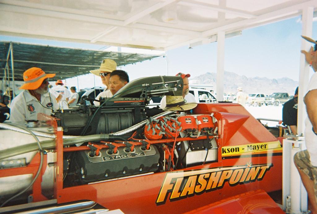

    ,,,,,,,,,,,,,,,,,,,,,,,,,,,,,,,,,,,,,,,,,,,,,,,,,,The plan as explained to me is that you take half of the displacement of your 4 stroke engine. Then take the tire cir***ference and final drive ratio and calculate how many revolutions you will you need to go one mile. Put those numbers together
    and that is how much air you need. Then calculate a column of air one mile long and find the height and width and that equals that number. That is the proper size of your air intake. Any larger is drag. Note size of scoop on this record holding nitro roadster

    Here is the Flashpoint car with a Top Fuel type hat. Ran 395. And with the current Don Jackson Bonneville size hat ran 451. Of course there were several other changes. But the car was faster and more responsive to driver input with the Jackson hat. Also the Sumers Bros Goldenrod went 409 with the MoPar scoops made by AFX engineers. When they went to the Bob Herda scoops they went 425, Back to Back 1471 .jpg 13987371_1768017290082471_962519234743150165_o.jpg
