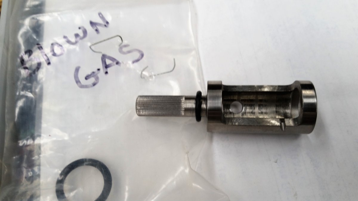

    Not sure what brand barrel valve this fits.
    I must add that this has been a very interesting thread.
    And great work.
    loudbang and Deuces like this.

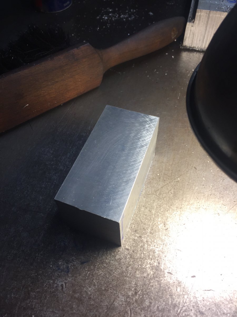

    IMG_2481.JPG So you ever meet one of those guys who can't leave well enough alone? Yeah, that's me. Here's my take on a fixture to ream the throttle shaft. I used replaceable drill bushings so if I decide to ever use a larger bearing or bigger shaft - it'll be a piece of cake.

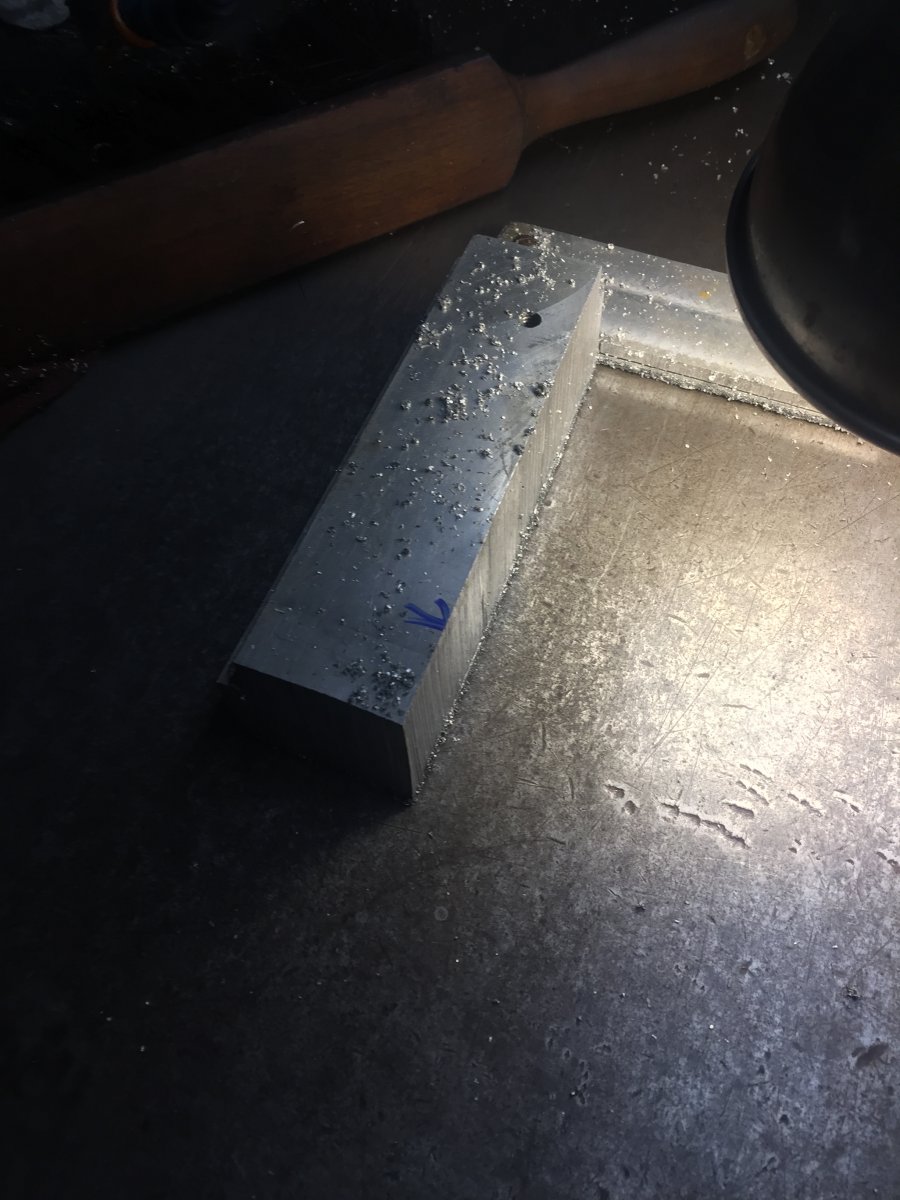

    IMG_2487.JPG The surface of my fixture is pretty flat <.001" - I will eventually put it on the surface plate and see just how flat it really is, but it's close enough for now. The next thing is to get all the bushings at the exact same height and I was doing pretty good - all within .0005" until I got careless and missed the number by .002" - dang I hate when that happens! Sure I could shim it, but then I remembered how I resurfaced the head on my daughters car and I figured it'd work here too. So far it seems real close - we'll see how it feels when they are tightened down.

  12. saltflats
    Joined: Aug 14, 2007
    Posts: 13,733
    saltflats
    from Missouri
    It said blown gas on the bag it cam in.
    Deuces and loudbang like this.

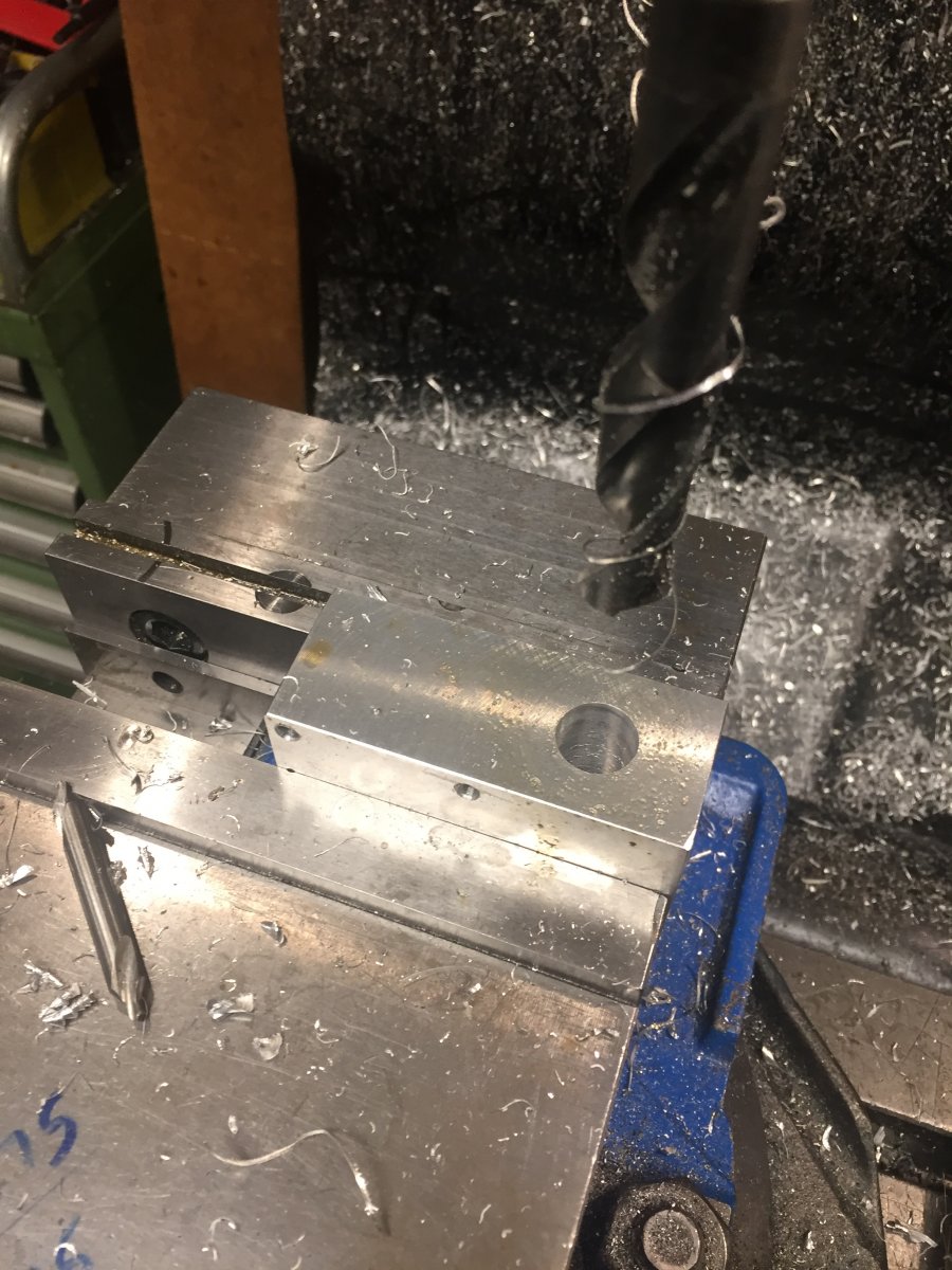

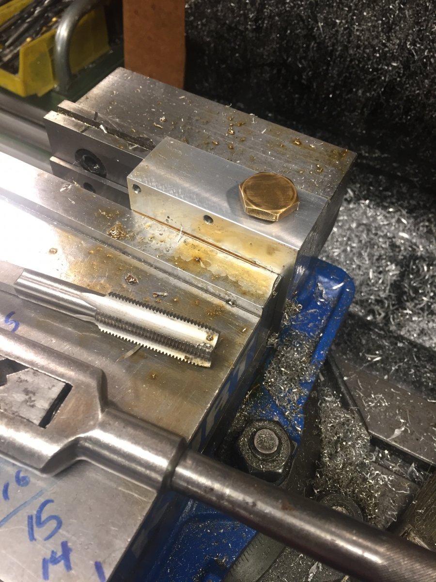

    IMG_2496.JPG IMG_2497.JPG I opted to enlarge the bores to allow the option for roller bearings should I ever want to try them. The drill/reamer fixture uses bushings you can change in place so once it's aligned you can swap whichever bushing size you need. It worked great! I also took a thin sheet of shim stock and punched a slightly oversized hole in it - I used this to mask off the throttle bore and the hole let me debur the throttle hole edges which were sharp after reaming. I also opted to take the easy way out and just weld some old HEMI pushrods on the drills/reamer to allow me to reach all of the bores in one shot. After I welded them I straightened the in the lathe before use. Worked great!

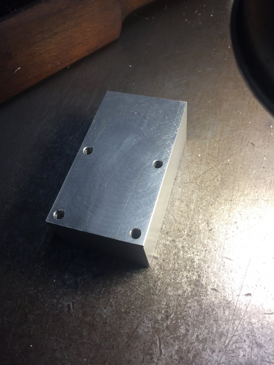

    IMG_2561.JPG So TODAYS lesson is: Not all Fuel nozzles are the SAME size - even if they are from the same vendor!!!! I used some (I think) NEWER nozzles to mock everything up and had taken measurements off those only to find out when the set I will actually use are quite a bit wider!! After contemplating option between modifying the nozzles to narrow them up like the rest that I have -OR- modifying the housing- I went with the housing so that this problem doesn't bite me again should I decide to change nozzles again. So for my buddy saying "Bolt the damn thing on already" All I can say is that it's always something!!!!!!
