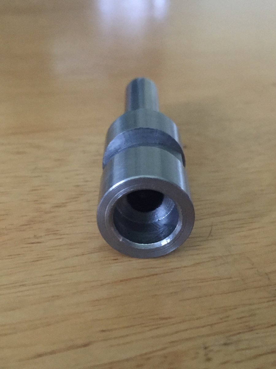

    image.jpg image.jpg Idle ramps machined and secondary byp*** holes drilled. This thing might even work!
