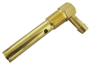

    $_35.jpg I'm wondering if that will also apply to this type of rollover vent valve. Installed in the top of my RPU gas tank there is no way I will be able to have a loop higher than the valve as the top of the tank is practically even with the top of the bed. .

    And obviously no one has a clue to this one. :D:D
    I'm thinking that since it has a check ball that will close when the fuel level is high then it will only vent when required and will not siphon because of the check ball rollover design.
    That's my theory and I'm sticking to it. :D

    If the check ball is steel it won't be floating.
    If you can get one that is straight then you could put a loop in the hose on the way back down.

    This problem has reared it’s ugly head again now that I’m installing my vent/ rollover valve for the final time.
    My valve does in fact have a separate phenolic plastic ball above the steel ball.
    The plastic ball floats when the tank is full and stops fuel.
    As the tank needs air it will breathe.
    The steel ball is of course for rollover shut off.
    This info is from the maker of the valve, Tanks.
    I’m still not sure if I’m going to have issues with any fuel smell or where to route the vent given thephysical limitations of my tanks location in the bed of my RPU.
