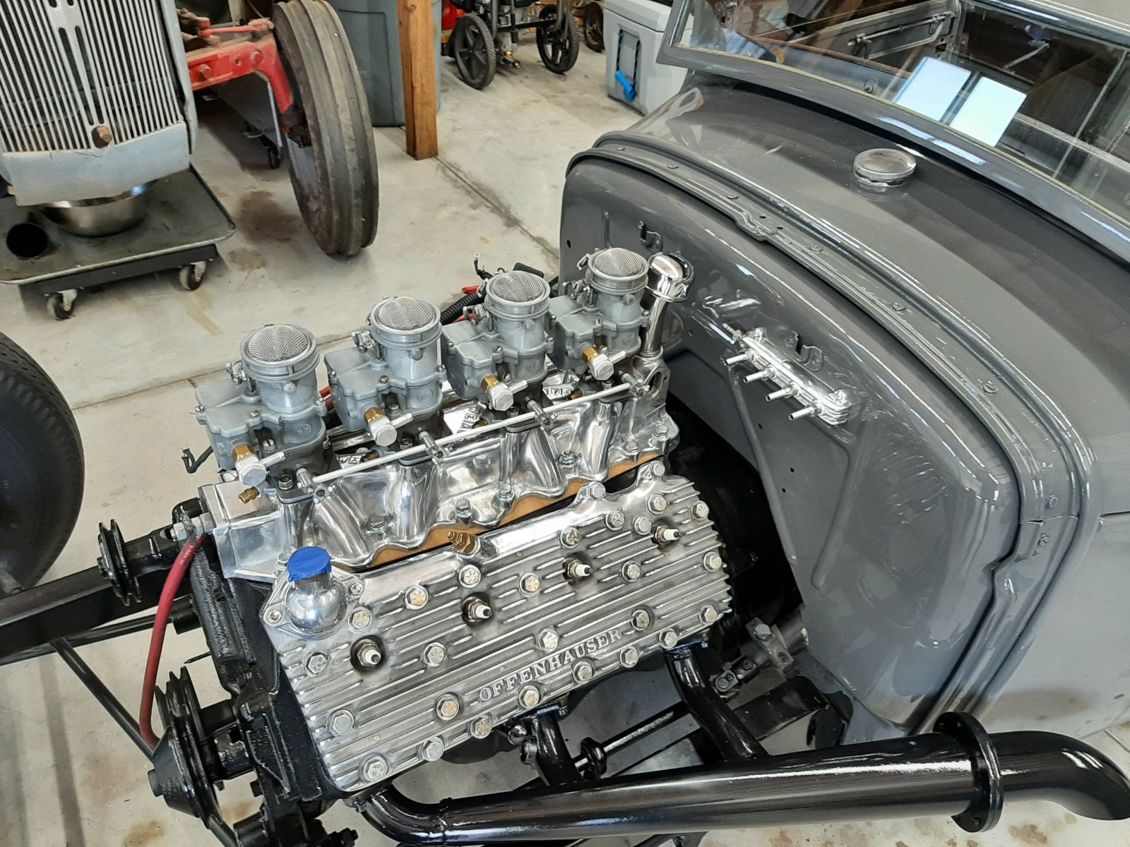

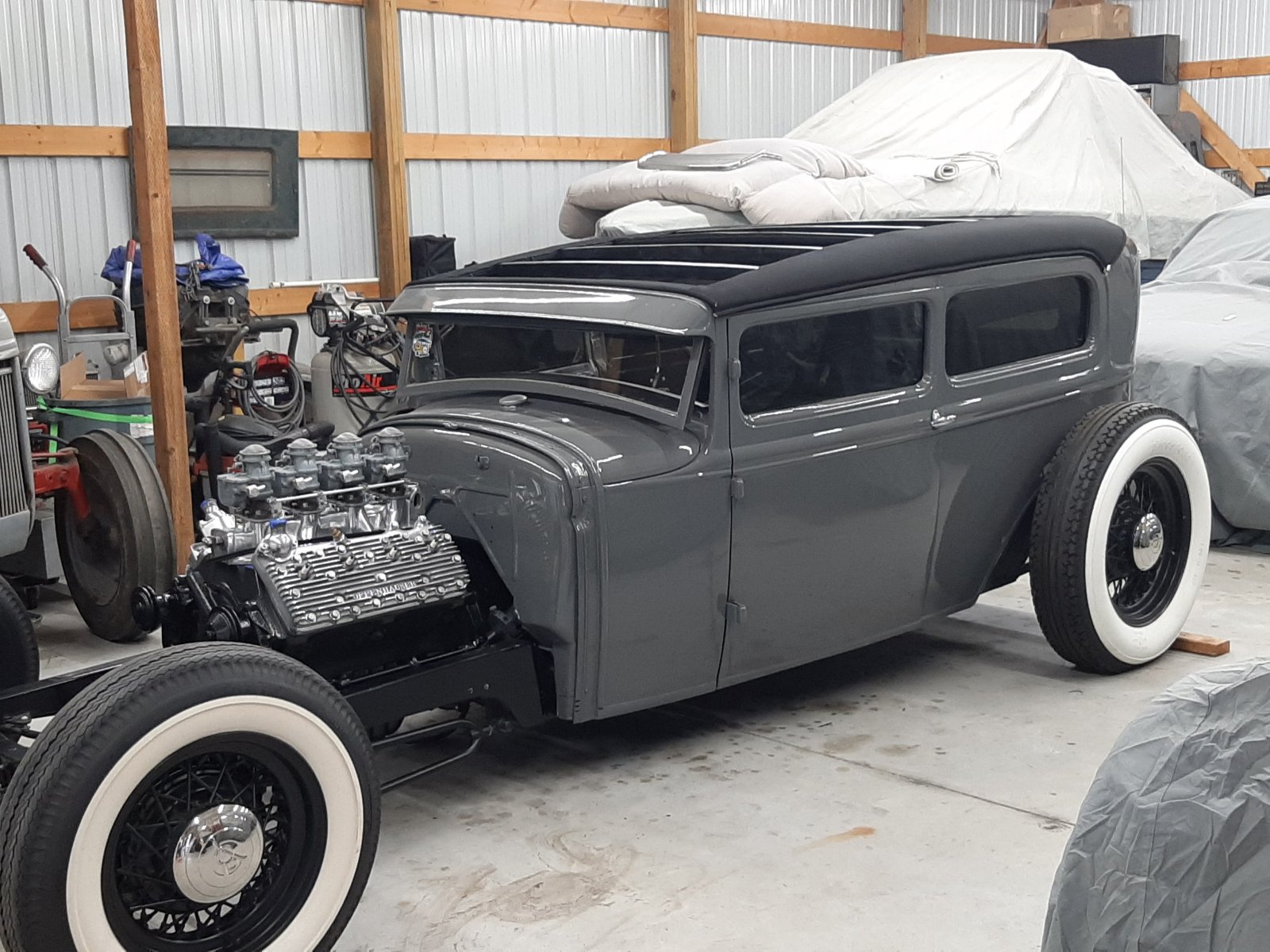

    Needing some suggestions on my build. I have a flathead with 4 Stromberg 97's on it, electric fuel pump. What size gas line should I run from tank to pump then pump to block and then from block to each carb? Should I put a regulator before the block? Any help would be appreciated.

    I'm not trying to be negative, but I think 4- 97s on a flathead is too much.
    On a street driven car low speed response will be almost impossible to achieve.
    There's no way to use progressive linkage and opening all four carbs at once will
    likely create problems, stumble, etc.

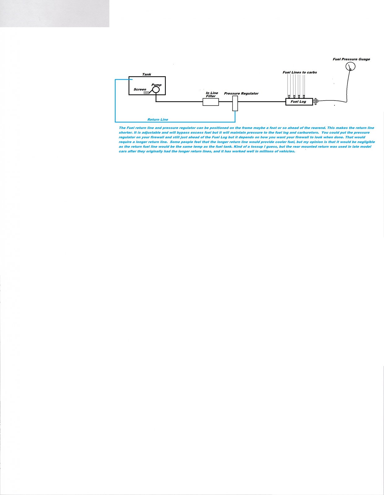

  8. ekimneirbo
    Joined: Apr 29, 2017
    Posts: 4,218
    ekimneirbo
    Here are some considerations. The way an electric fuel pump works, is that it provides flow......not pressure. Different pumps are however designed to work at certain pressures, so you need to select a pump that is designed for the pressure you need. Generally a carbureted set up will need less than 10 psi and probably close to half that. The key here is that too much pressure and it will overcome the resistance of the spring(s) seating the float needle in the carb and flood the engine. So you want a pump/system designed to provide that correct pressure.
    Next consider that the pump will run continuously.
    1. The pump will be pushing but not moving enough fuel at times because you are not using enough fuel
    OR
    2. You will allow fuel to be pumped in a circle from the fuel tank to the engine and the excess fuel will return to the fuel tank via a return line.
    Some newer systems have pumps that are designed to operate as #1. The best way however is to pump more fuel than you need and allow the excess to return to the fuel tank. This lets the pump run cooler and supply cooler fuel to the carb........but it requires a return line. (This is how I would do it)
    Next consideration is whether you are going to use a fuel pump that resides inside your fuel tank or is placed inline between the tank and the engine. I recommend an intank pump as they last a long time, are quieter, and run cooler. It's more difficult to run an intank pump but in the long run its better.
    So, the basic idea is to have a mesh filter mounted on a pump inside the tank. Then insert a large inline fuel filter in the line. You can put a pressure regulator tapped off the fuel line and returning to the fuel tank shortly before or shortly after the fuel filter. This keeps you from having to put a pressure regulator up by the engine. The main fuel line will then run forward and deadhead at your fuel block and carbs. That way you only have one line to run all the way forward and the return is tapped off under the car via the pressure regulator. Adjust the reg to maintain whatever pressure you need. I would add a pressure guage up at the fuel block so I could always see fuel pressure and tell if it stays where you set it even when accelerating hard. The guage could be mounted inside your dash just like an oil pressure guage. One last thing is to buy a name brand regulator from a known company (Summit) as there are cheap counterfeits that are made to look like the quality ones (Aeroquip etc.).

    Great information!!!! Thank you. Only thing that would make this better would be a drawing. LOL.

  20. ekimneirbo
    Posts: 4,218
    ekimneirbo

    If that manifold does not have a balance p***age, then it is effectively an individual runner manifold.
    Blocking off carburetors would mean blocking off pairs of cylinders.
    31wrecker, BJR and loudbang like this.

  24. 31wrecker
    Joined: Apr 27, 2021
    Posts: 34
    31wrecker
    That would work great but the way the intake is setup is the front carb runs the first two cylinders, the second card the next two cylinders and so on. At least thats the way it is explained to me.
    BJR likes this.
