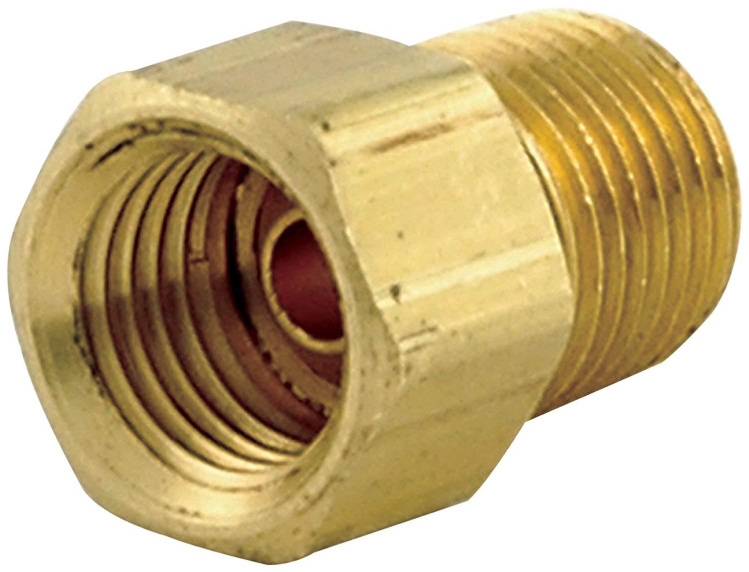

  16. This is your answer. The bung on the tank is npt and needs an adapter for the tube nut (not an npt) to seat into.
    427 sleeper likes this.
  17. RmK57
    Joined: Dec 31, 2008
    Posts: 3,082
    RmK57
    Something like this if it’s pipe thread. $3-4 at pretty much any auto parts store. Not actual size!
    427 sleeper and osage orange like this.
