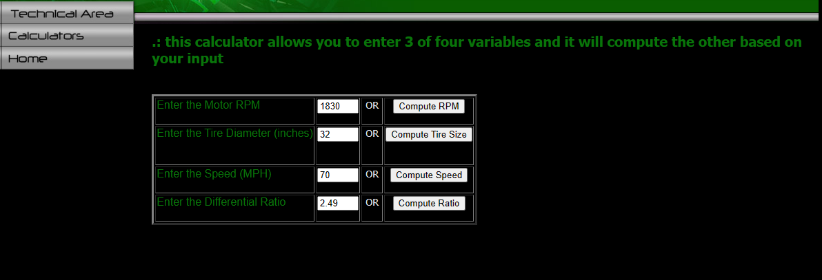

    With the 32 inch tall tire, 3.55 Rear and a 1 to 1 high gear at the output in the trans you should be turning 2609 rpm at 70.
    A 70% overdrive would drop that down to 1830
    Still total state of tune and driving habits have a lot to do with gas mileage. Even tire pressure especially if you 32 inch tall tires are 8 ply or more light truck tires and you are running low pressure to soften the ride.
