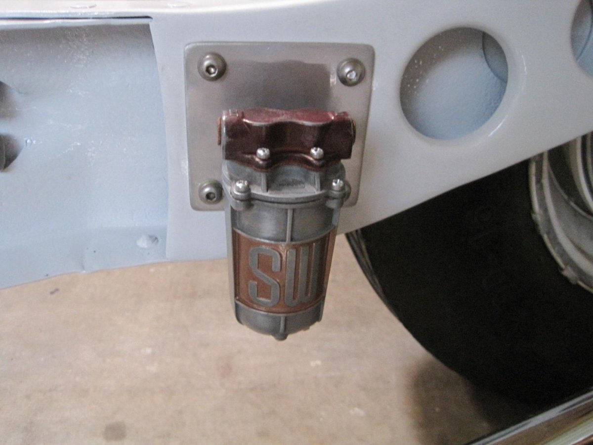

  5. More complete chassis pics 001.JPG Thanks, I bought a Holley Fuel pressure regulator that runs from 1-4 lbs. so I'm guessing I should be ok. I have a electric SW fuel pump that I'm using and had no idea what it would put out. I'm using this pump. Any ideas on it? Motor is 371 Olds with tri-power

  7. I run 3 pounds on the tri power in my truck. I'll 2nd that is a cool looking pump.
  8. It's NOS so I'm hoping it is going to last a while. I'll be looking for a second one to carry in my tool box.
  9. Looks like a bellows type pump.....I had one like it(sw brand also) on my F-1 PU. Ethanol gas turned all of the rubber inside to goo. If you can run real gas it might live....
