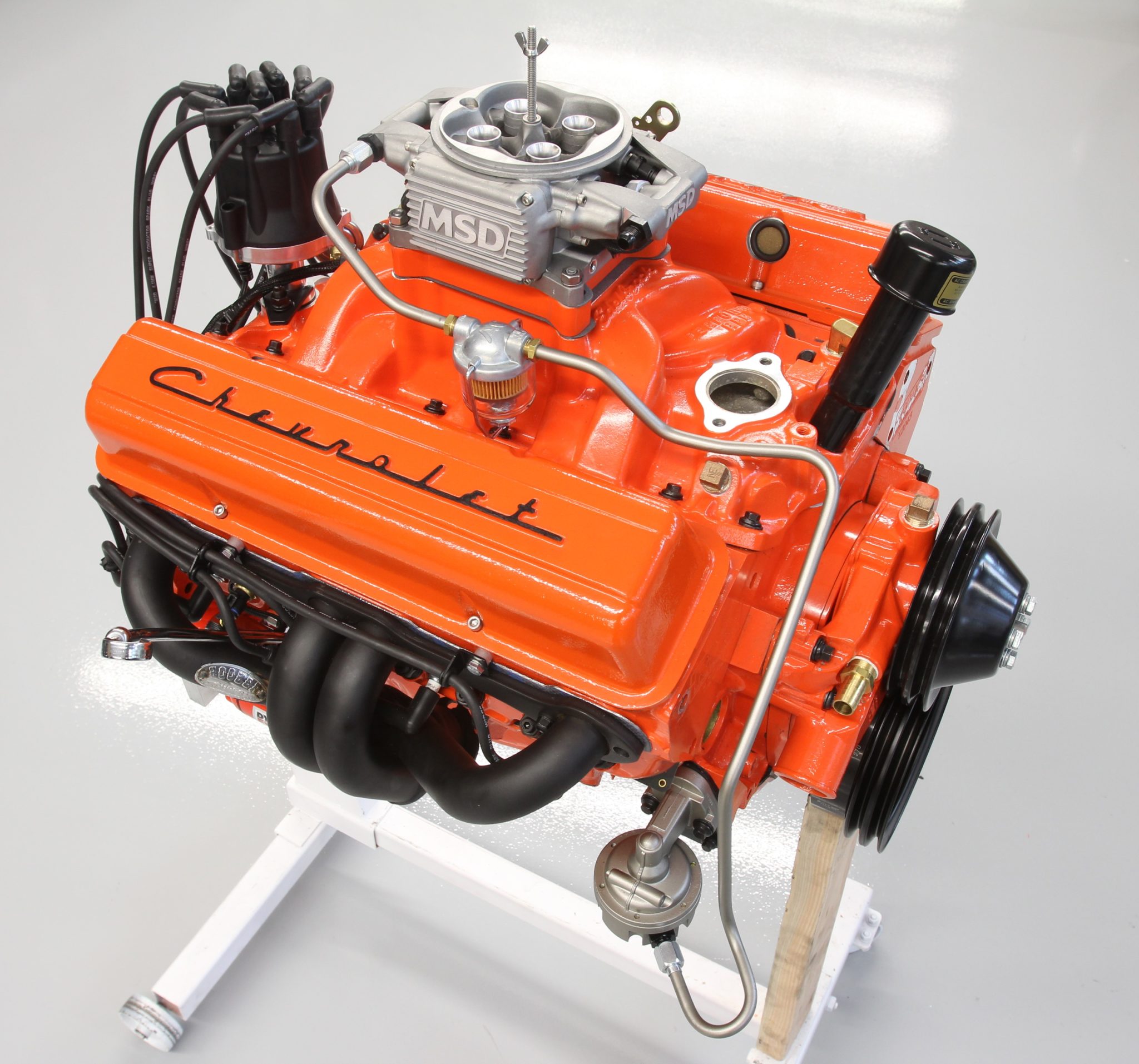

  5. PotvinV8
    Joined: Mar 30, 2009
    Posts: 549
    PotvinV8
    Here's one example that I've done on a fuel injected 383. Dummy fuel pump and filter, but you get the idea. Line is 3/8-inch stainless with AN fittings at either end.
    If you must use hose, they make some very nice Kevlar braided hose that looks good or you could always use the typical stainless braided hose and cover it with heat shrink tubing to keep things looking "correct" but still retain the benefits over the usual rubber hose.
    Here's another example with a tri-power setup. Stainless line, welded together and ran from the regulator to each carb. Motor is filthy and needs a resto, don't mind that...LOL

    Thanks for the inspiration. Some noce workmanship there. My flaring skills are garbage…
    I may run the hard line about 10” from the carb and run hose and clamp filter from there.
