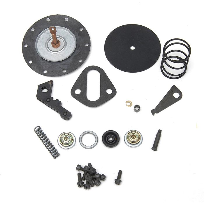

  25. I was going to make a comment about fuel pumps but didn't want to muddy the waters. Since you're having trouble with new pumps I can comment. I've had trouble the last few years with mechanical pumps (dying early, leaking or over pressurizing), I've resorted to finding old made in USA rebuildable Carter pumps and buy a quality rebuild kit for it. I even went so far as to buy an old 80s Carter catalog. I have an old Carter performance fuel pump from the late 80's (I bought new), that's been on at least 4 cars over the years and still works great. I'm stocking up on other pumps now.
    Studebakers have that problem with new Carter pumps, the arm isn't in the correct spot to get a full stroke from the eccentric.
    302GMC and The Shift Wizard like this.

  28. Found on a review on a Studebaker pump from Amazon. The "R" is the stock pump and the "C" is the new "made in China" Carter.
