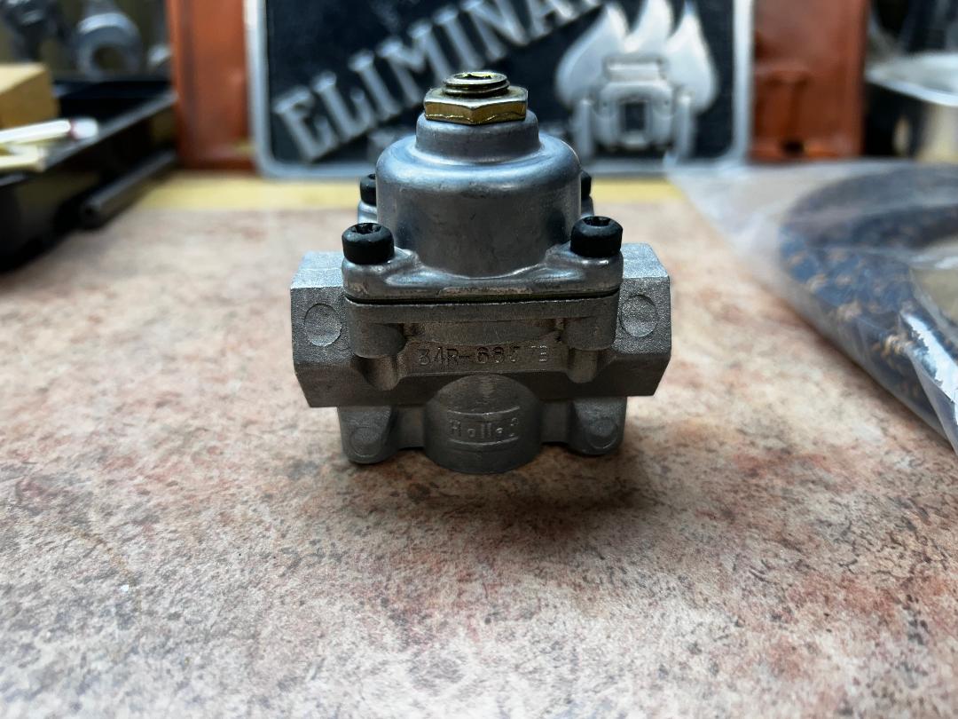

  5. Joe Blow
    Joined: Oct 29, 2016
    Posts: 1,904
    Joe Blow
    Like a Mr. Gasket? Could be your problem....look at a low pressure Holley.

  8. Joe Blow
    Posts: 1,904
    Joe Blow
    Speedway's knock off of a Holley.....but then again the Holley's quality is starting to lag too (overseas). I'd sure look at that regulator though.

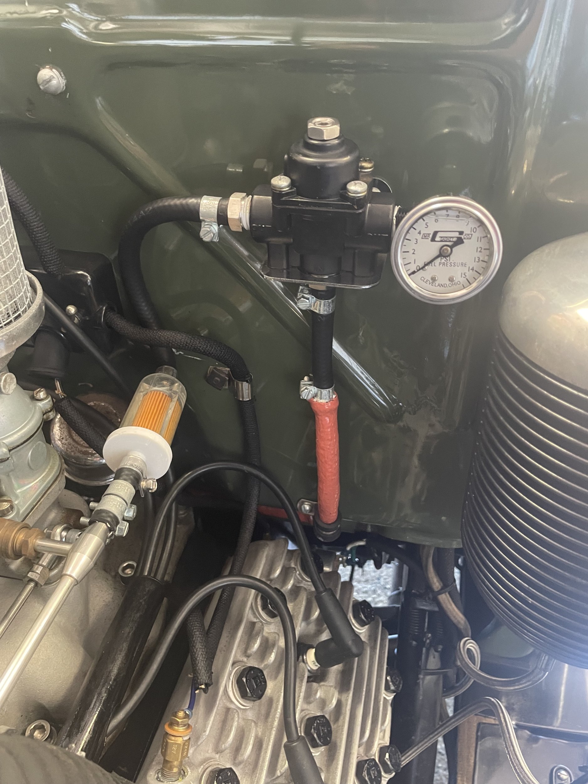

  26. Budget36
    Joined: Nov 29, 2014
    Posts: 15,444
    Budget36
    Post number 6, you can see it’s a FH.
