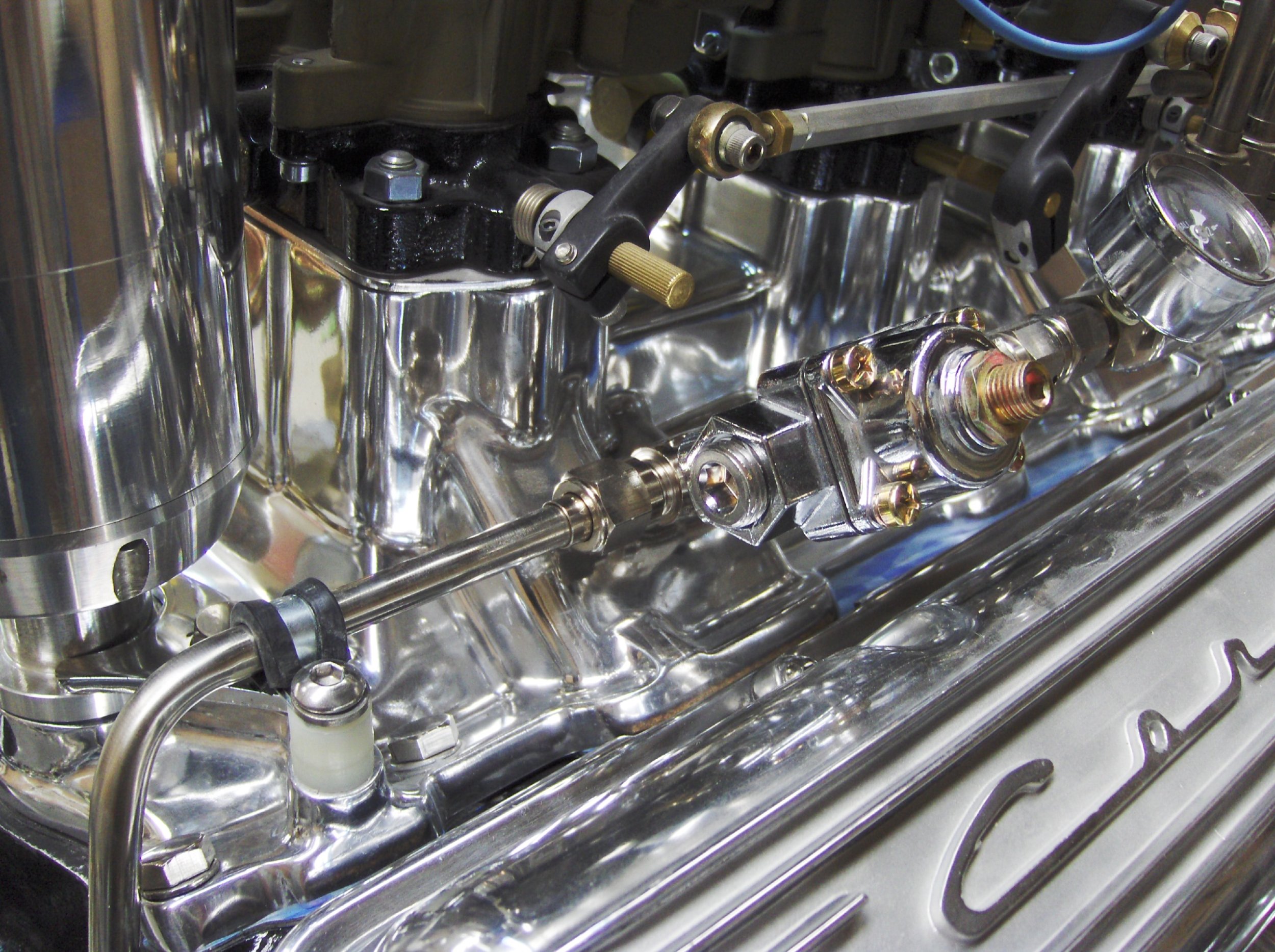

    I have a roadster with a 392 hemi and a WC 3-D intake manifold with three new big 97 Stromberg’s. Would like to know who makes a low pressure regulator and the best place to mount it. I don’t want to mount on the firewall looking at the front of the motor off the bolts for the water pump, I need to make a bracket to hold it. I was gonna mount the filter right off the regulator and feeds into the fuel rail with a gas pressure gauge at the end of the rail. Your thoughts IMG_0769.jpeg

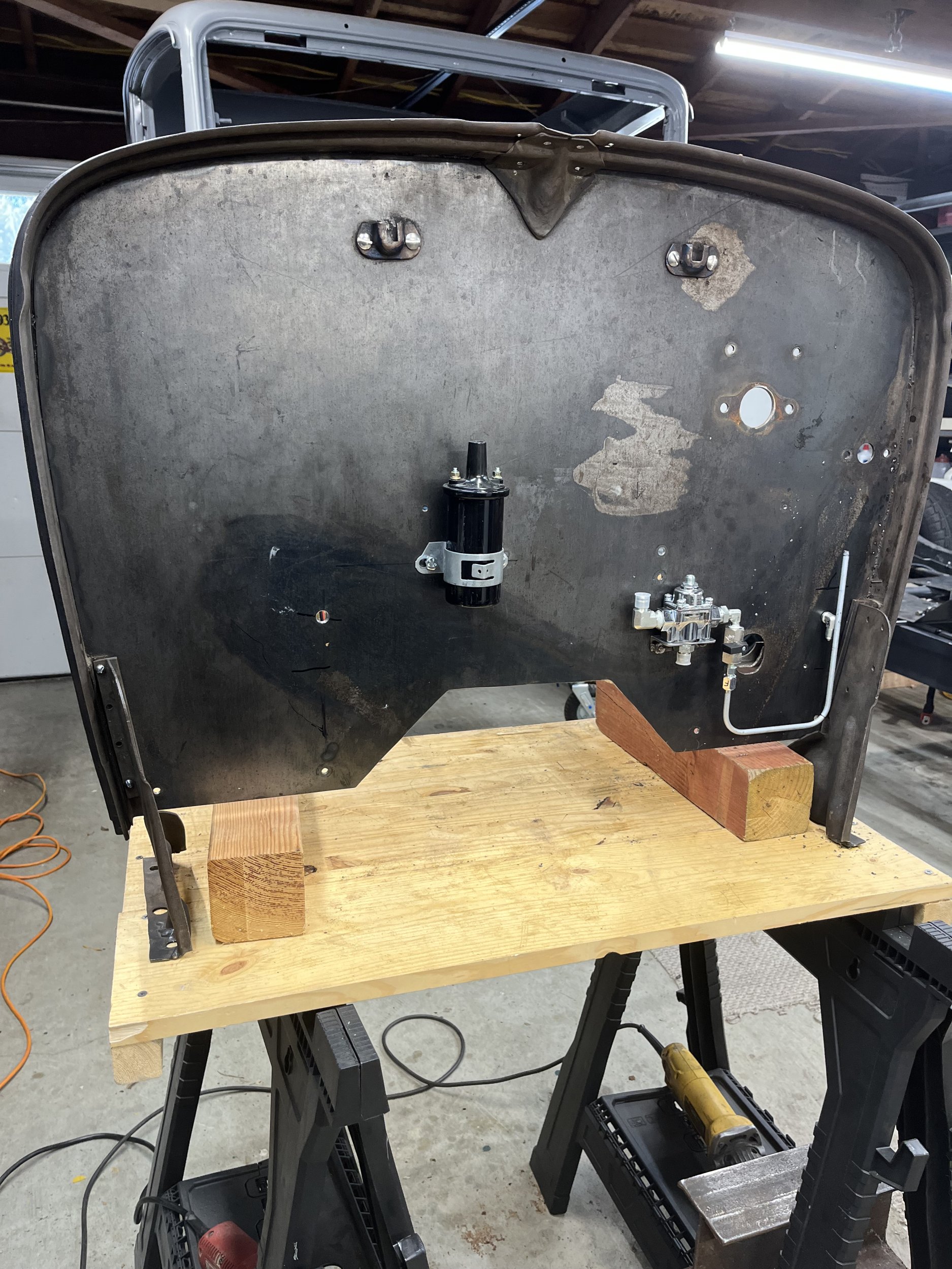

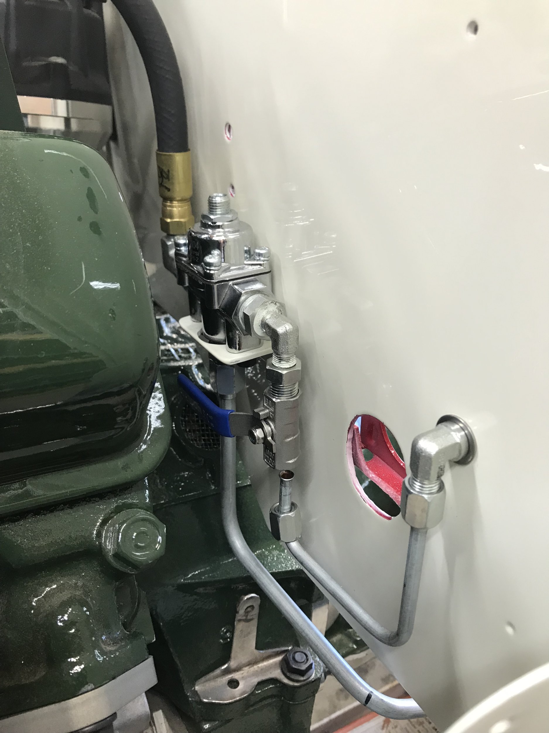

    IMG_5524.jpeg IMG_7288.jpeg I mounted mine low on the firewall to keep that sanitary look. The take off with the ball valve services the pressure gauge on the dash. I valved it in case of a gauge failure or leak. The bracket also has threaded provisions for the throttle pedal
    jimmy six and rattlecanrods like this.

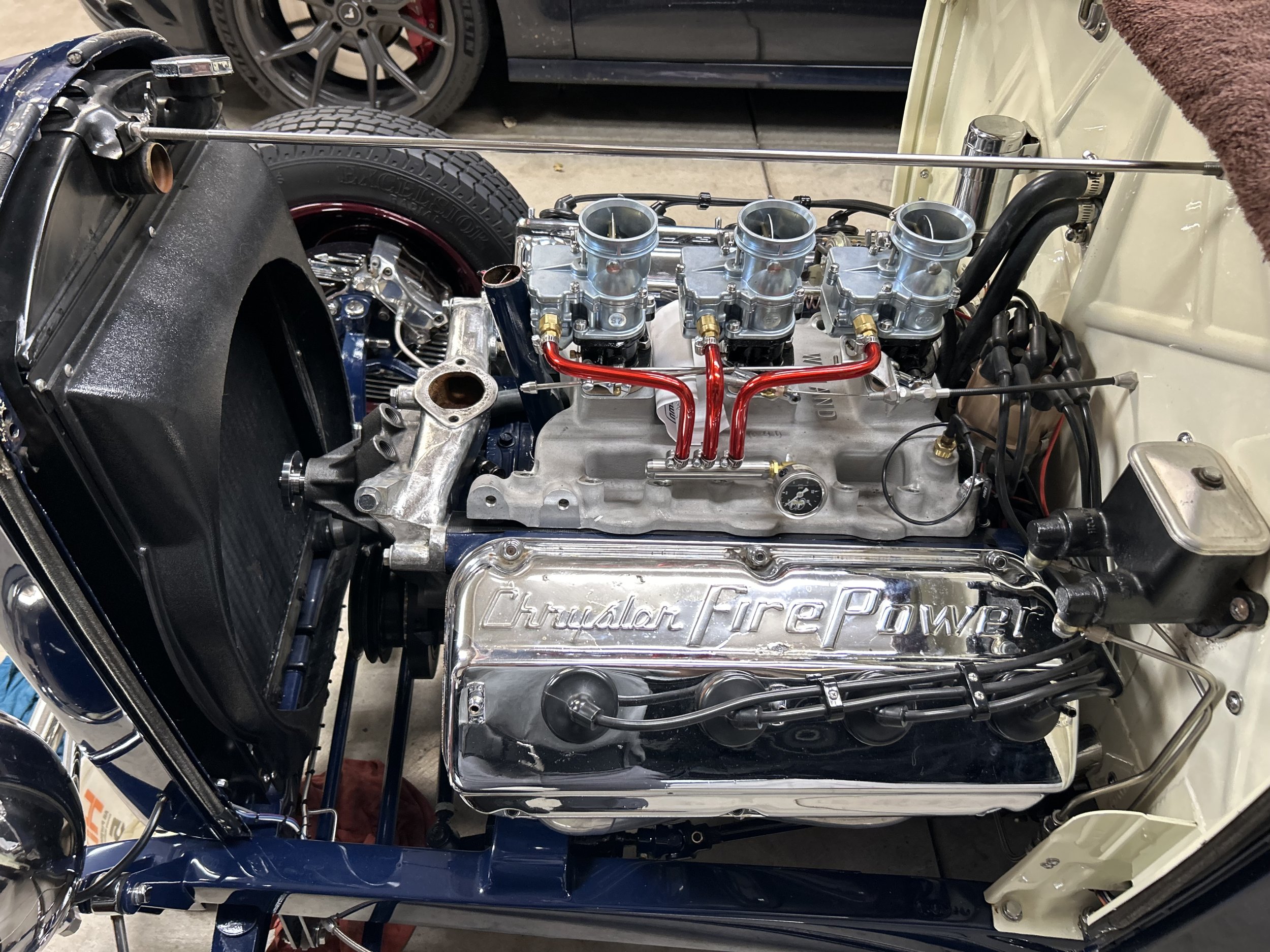

    Nice setup. I'm wanting to do the same thing. I have 2 of the WC 3-D intakes.one is drilled for Rochesters and the other for Strombergs. You'll have to let me know how your 392 runs with the big 97's when you get it going.Can't decide which carbs to run. wc3d.jpg
