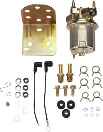

    9 psi. 350-2 barrel? Get a Carter and don’t worry about one. 5 psi and a 5/16” line. IMG_0403.jpeg

    One too many hose barbs used in the pump kit above. No hose between the pump & carb.
  16. Doublepumper
    Joined: Jun 26, 2016
    Posts: 1,843
    Doublepumper
    from WA-OR, USA
    ^ Not when the pump is mounted in rubber. The hardline will hamper isolation.
    1971BB427 likes this.
  17. Jack E/NJ
    Joined: Mar 5, 2011
    Posts: 978
    Jack E/NJ
    from NJ
    Line loops are used for isolation, not hose.
  18. Doublepumper
    Posts: 1,843
    Doublepumper
    from WA-OR, USA
    ^Nothing is perfect. Loops can crack from metal fatigue, caused by long term vibration:)
    2OLD2FAST likes this.
  19. alchemy
    Joined: Sep 27, 2002
    Posts: 22,753
    alchemy
    I’ve tried about half a dozen electric pumps and mount them all with rubber isolators on the bolts and a short bit of hose on each side. Still have noise but probably less than if it used hard line into it.

  21. 1971BB427
    Joined: Mar 6, 2010
    Posts: 9,837
    1971BB427
    from Oregon
    I always use hose to isolate, or to make maintenance easier on my cars. But I keep with NHRA limits of less than 12" of hose. From frame to engine I have a short 3" piece from hard line to hard line for isolation. At my rear electric pump and fuel filter I have 4" between each so they can be maintained, or replaced easily.
    Even hard loops can eventually fracture from vibration in some situations. And I really don't want coils at the fuel tank, pump and filter setup.
