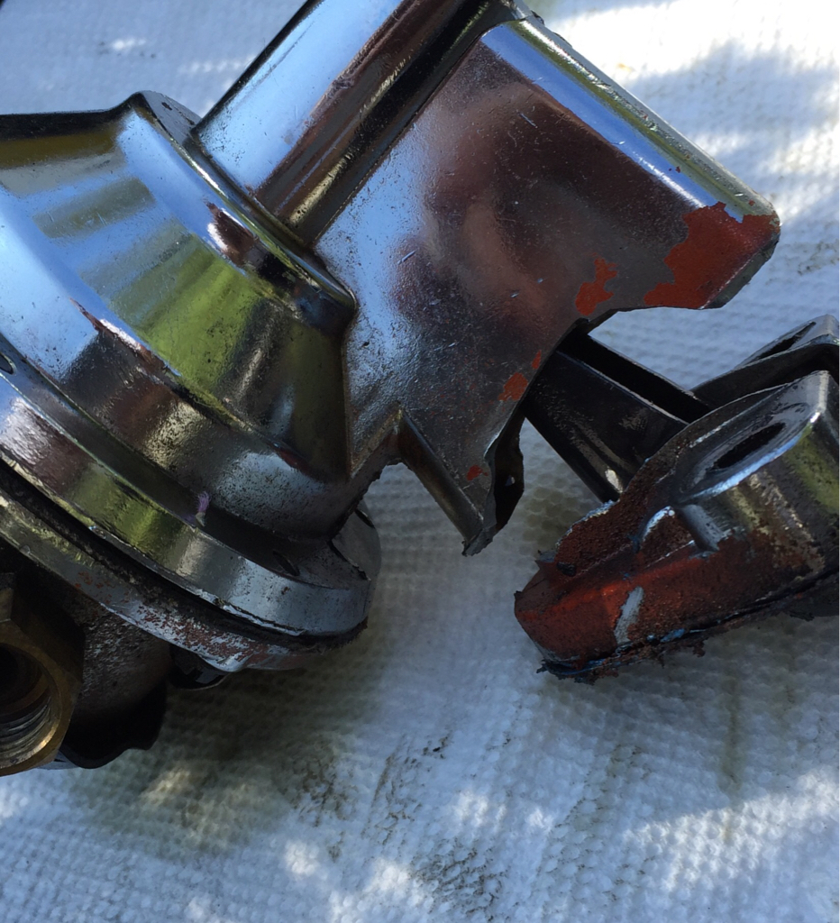

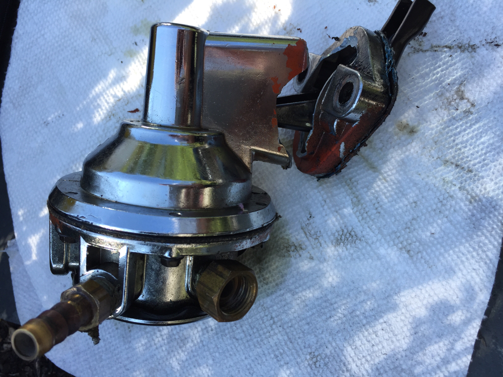

    ImageUploadedByH.A.M.B.1442686954.628044.jpg ImageUploadedByH.A.M.B.1442686971.450892.jpg

    Looks like the housing is chrome plated, could it have been Hydrogen Embrittlement?
  4. Edelbrock but I'm not sure if it's off shore produced or domestic.
  5. I'm not entirely blaming the pump.
    When I went to remove it I found the 2 bolts loose, I'm talking finger tight
    Stuff happens no matter how many times you go back over your work.

    In the first picture, it looks like the flange is bent alongside the fitting. It didn't get hit by something or hit the frame?

    yea, really, just because the goddam bolts are loose and the pump is rattling around on its mounting boss, that's no reason for it to break, right??:rolleyes:o_O

    And airtex denies it's a problem, though I know about a dozen folks who have suffered from loosing fulcrum pins either partially or fully, causing loss of fuel flow at the minimum, and more exciting failures as mentioned above.Check to see if the pinis staked in before installing any mechanical fuel pump, especially those made in Mexico.

    Shouldered bolts with a flat washer and lock washer (as above) also fuel pump shouldn't be chromed. It's a hydrogen thing...
