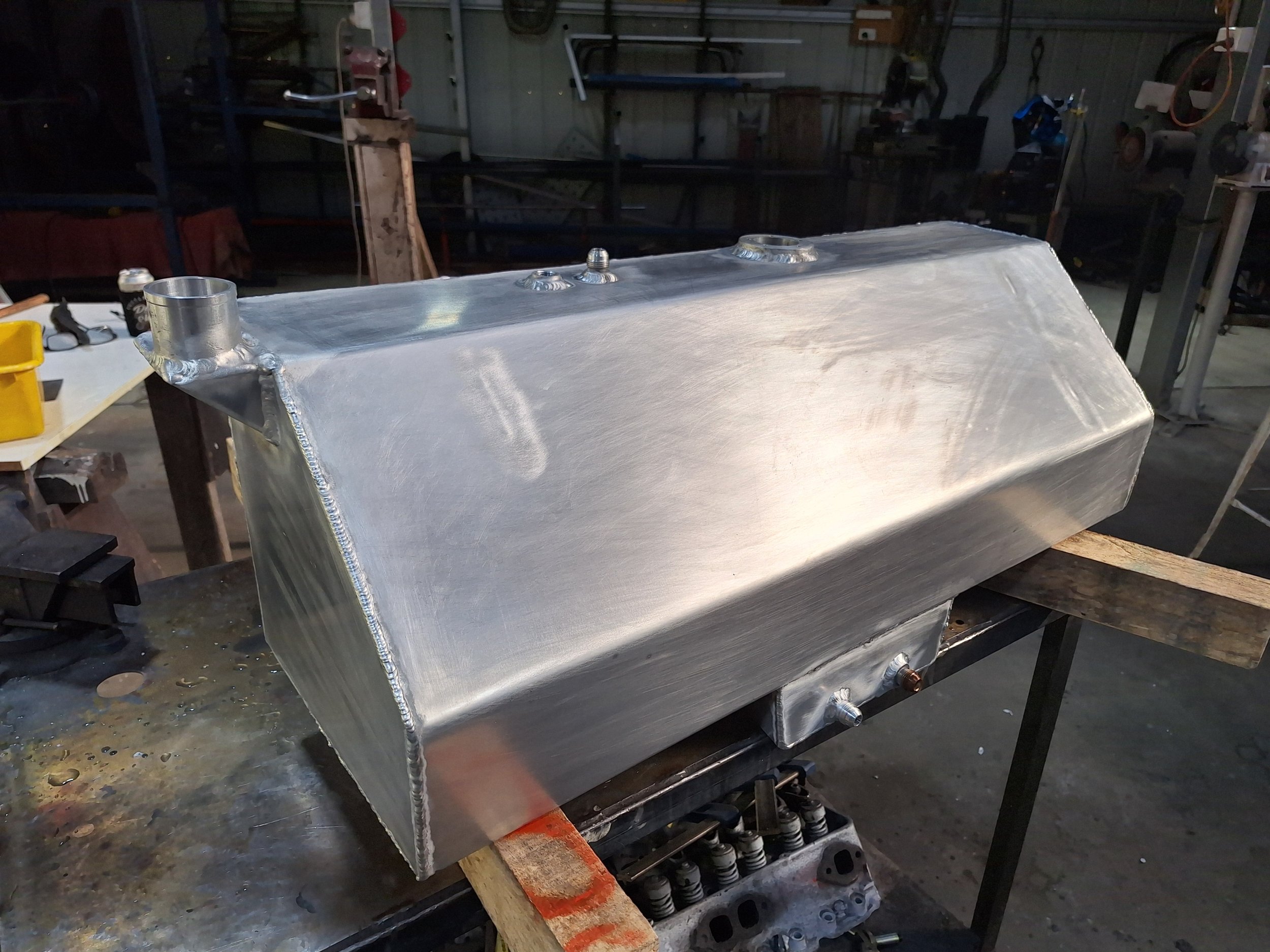

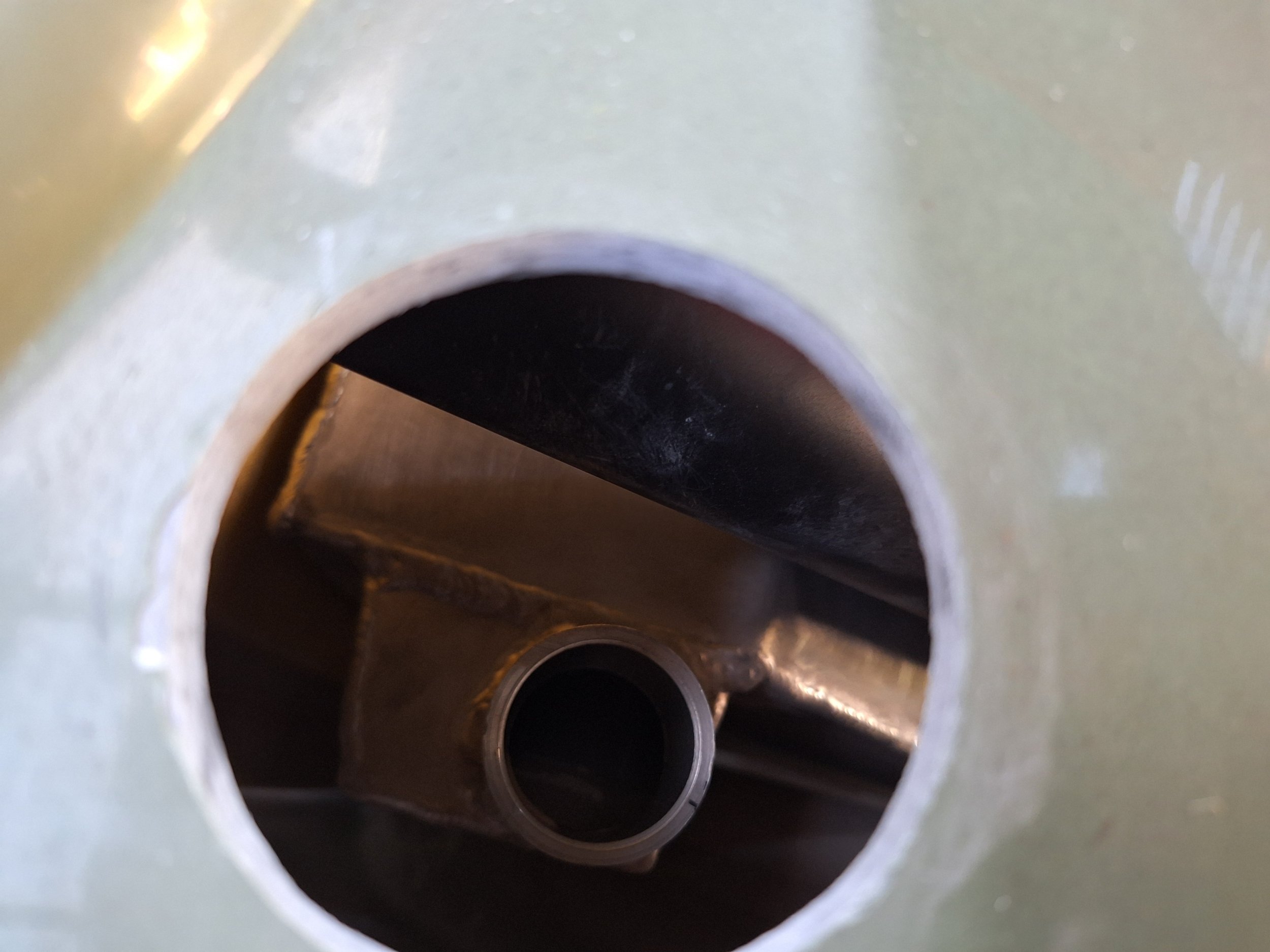

  26. grdra1
    Joined: May 20, 2013
    Posts: 680
    grdra1
    A few pics of todays progress, fabbed up tank baffles and machined fuel sender unit bung ( I paid $45.00. for a sender mount kit but ended up making my own as mount kit was ****ing useless ). I need to practice my alloy welding as its been a while, approx. 3-4 years since I welded aluminum. Glen 20251004_180731.jpg 20251004_180738.jpg 20251004_180745.jpg 20251004_180830.jpg 20251004_180836.jpg 20251004_180915.jpg 20251004_181013.jpg 20251004_181730.jpg 20251004_182929.jpg

  28. grdra1
    Posts: 680
    grdra1
    Thanks for reply, I used POR 15 for my 31 ch***is - I followed instructions to the letter with excellent results. I have decided to use aluminum so I don't have to use an inside coating, my 31 coupe has an aluminum tank and has been on the road for 5 years without issues, thanks again for your input. Glen

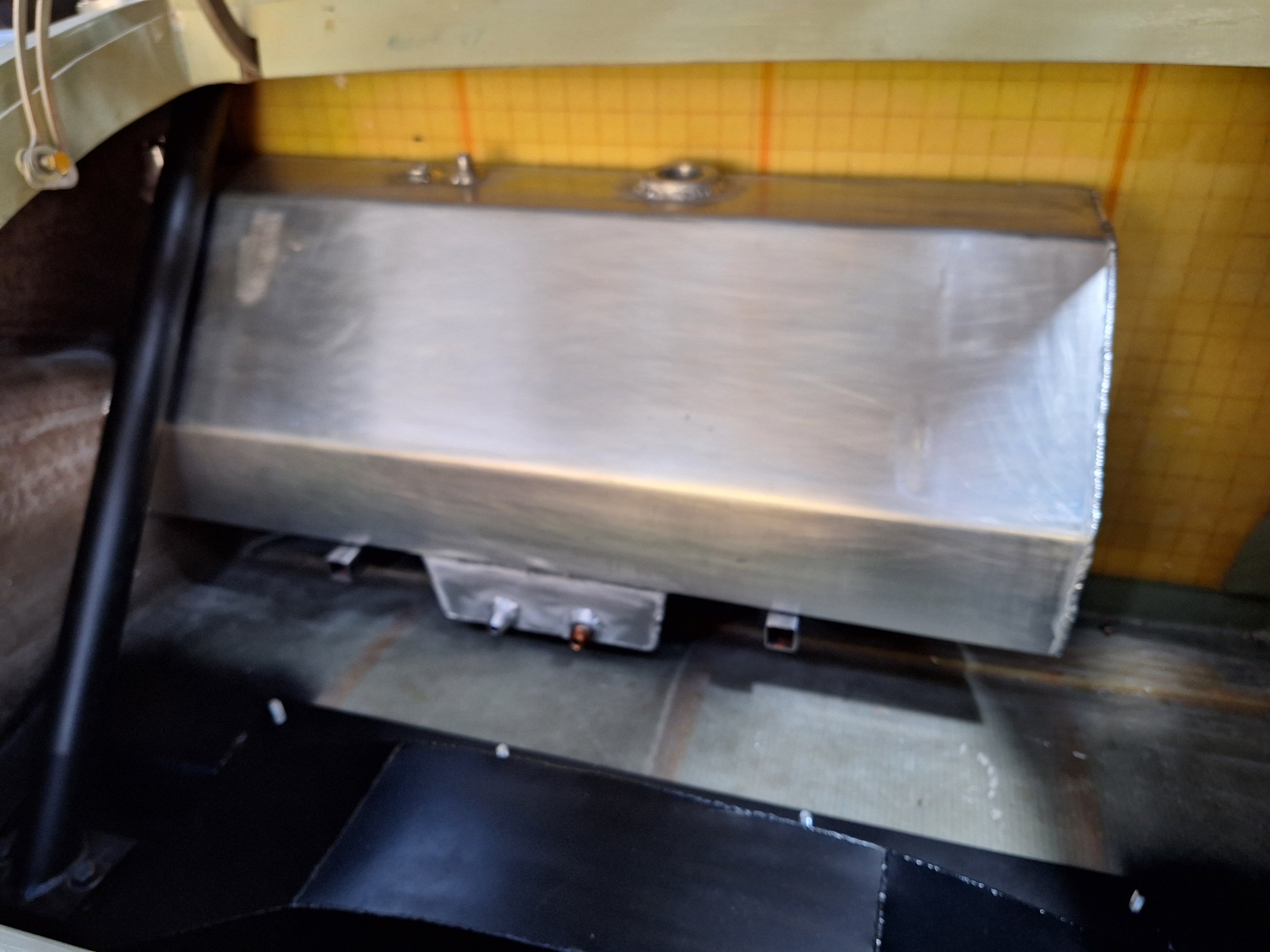

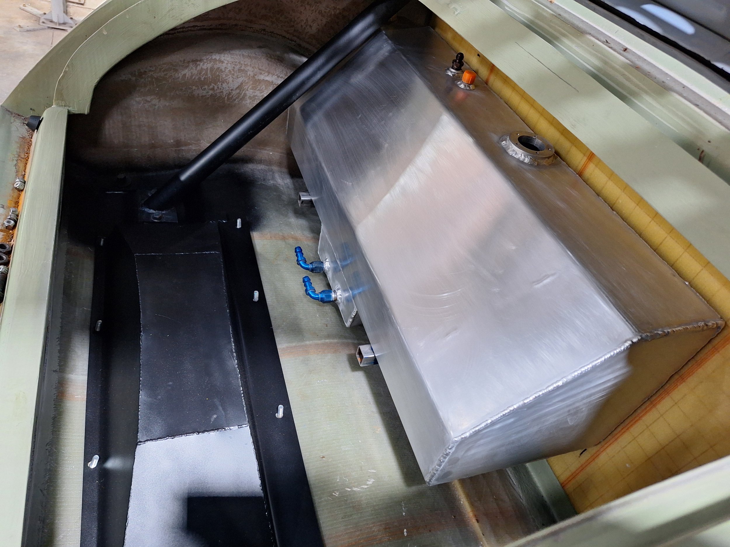

  29. grdra1
    Posts: 680
    grdra1
    A few pics of tank progress, welded tank today, happy with progress, still need to leak test and have certified. Glen 20251014_172248.jpg 20251014_172319.jpg 20251014_172328.jpg 20251014_172335.jpg 20251014_180505.jpg 20251014_180511.jpg 20251014_190523.jpg af5fe910-9f33-4a4f-a613-cd6eadf72e75.jpg
