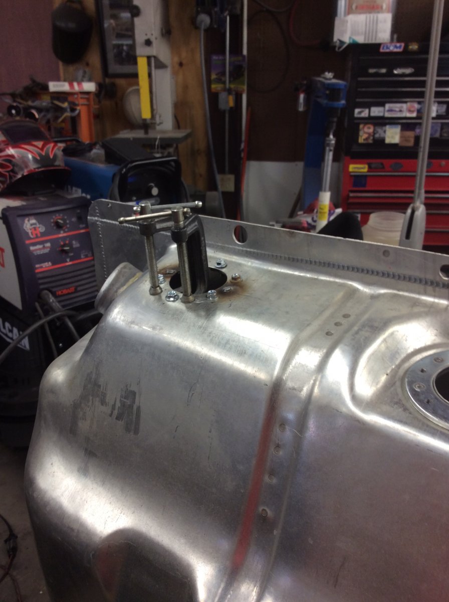

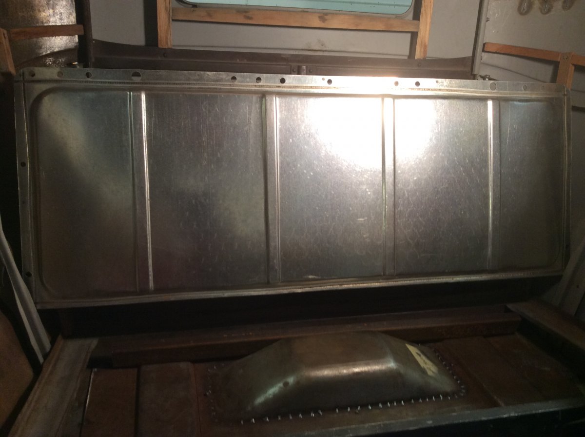

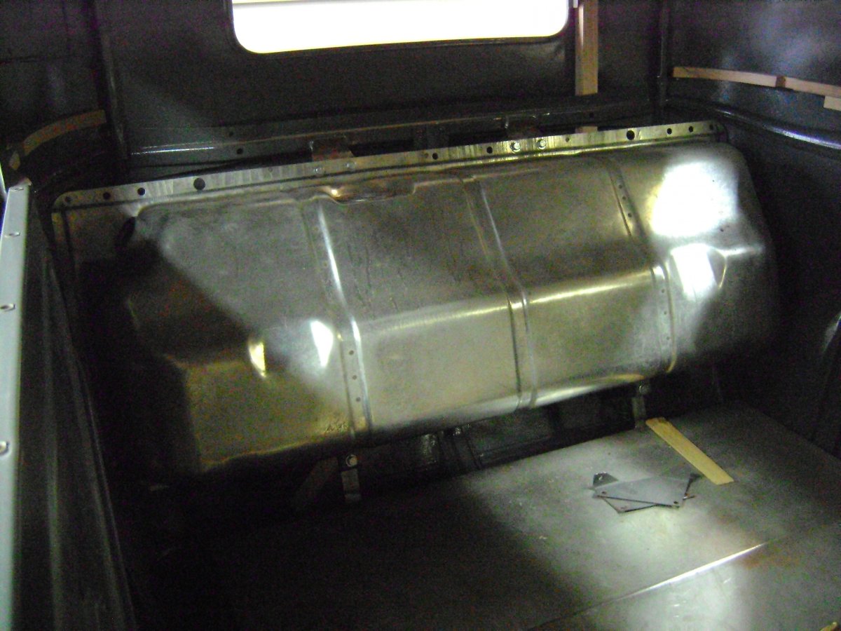

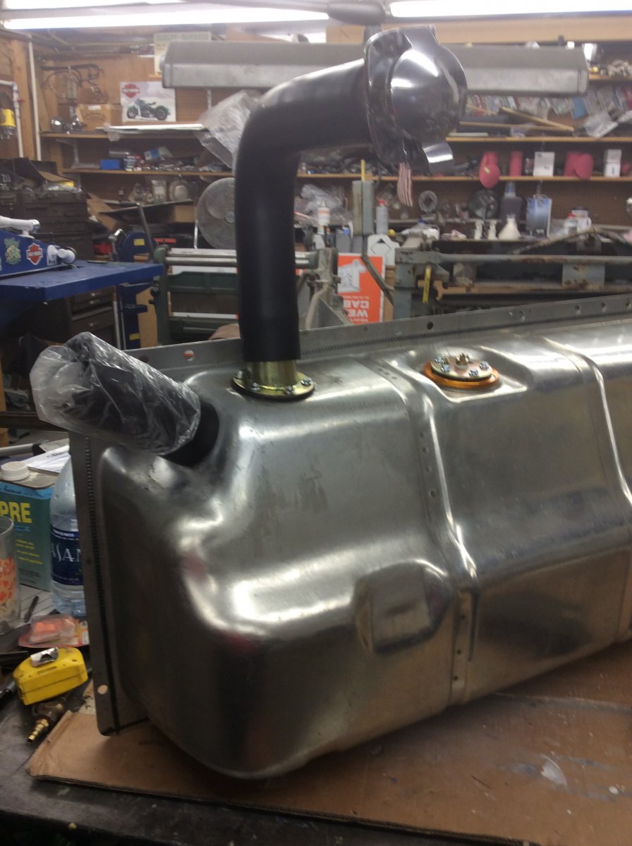

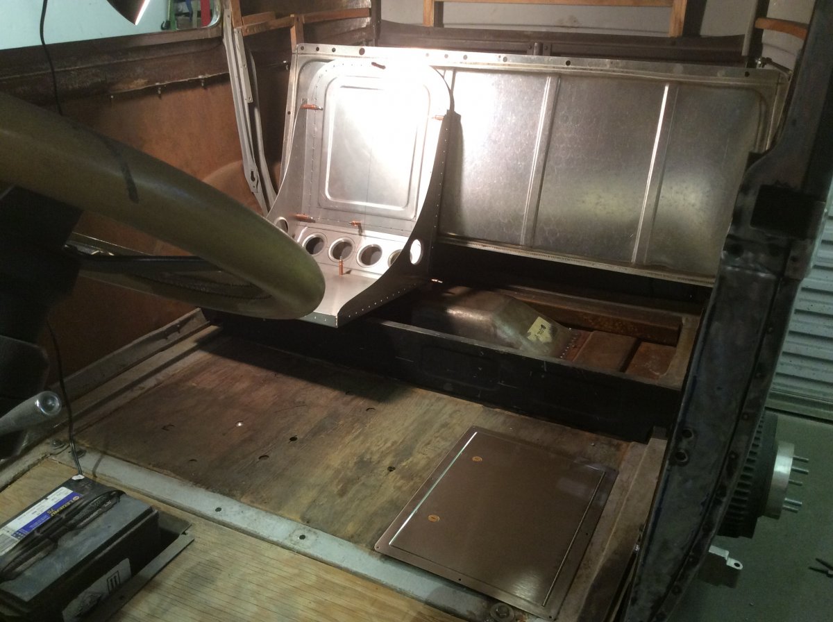

    Used a Ford pu tank . Fit nice . I changed the fill inlet and the hose it shows will be modified to a curve so I don’t have any blowback during filling . Mounting and such can be seen on tread below . Blue
