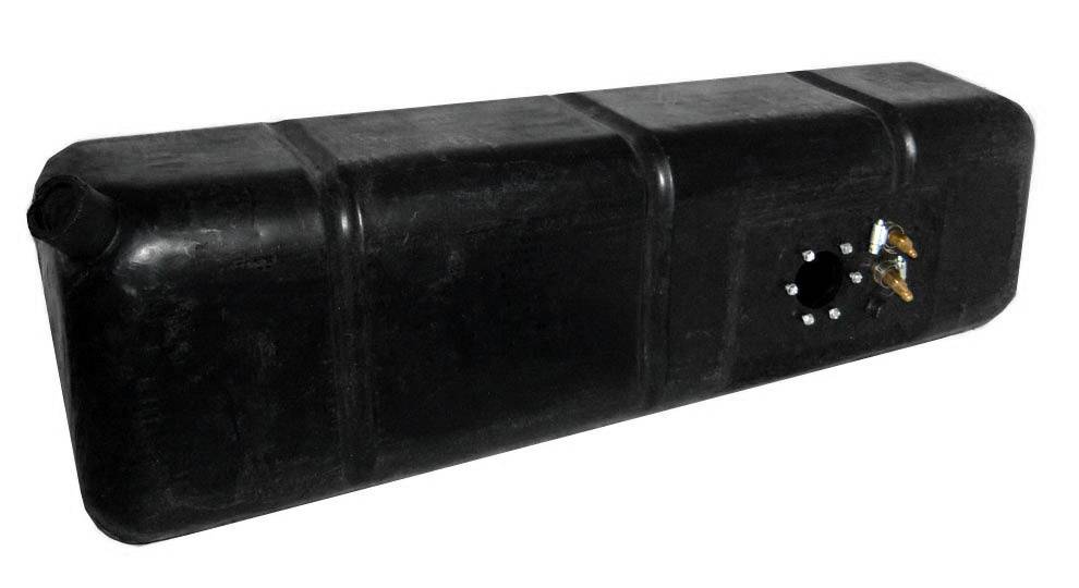

    Some vents have a rollover valve included in the design, like this one I installed in my RPU gas tank.
