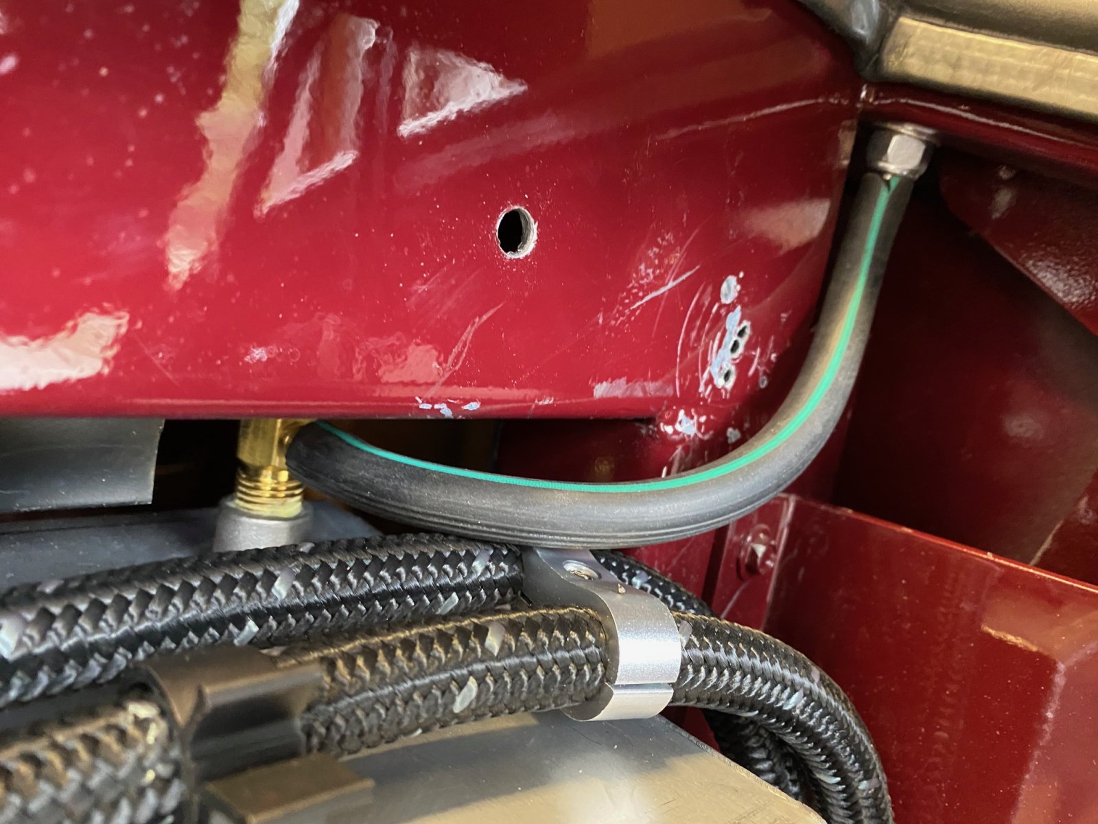

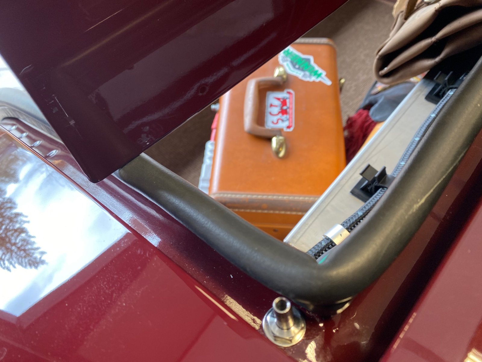

    I did mine a bit different in my roadster. I used a chrome vent that I bought from West Marine and drilled my rain gutter outside the weatherstrip on the trunk rail. That way the fumes would vent to the atmosphere and not in the car. Tank is behind the seat. the green striped hose is the vent.
    This the vent in the rain channel, looking down from outside the car.

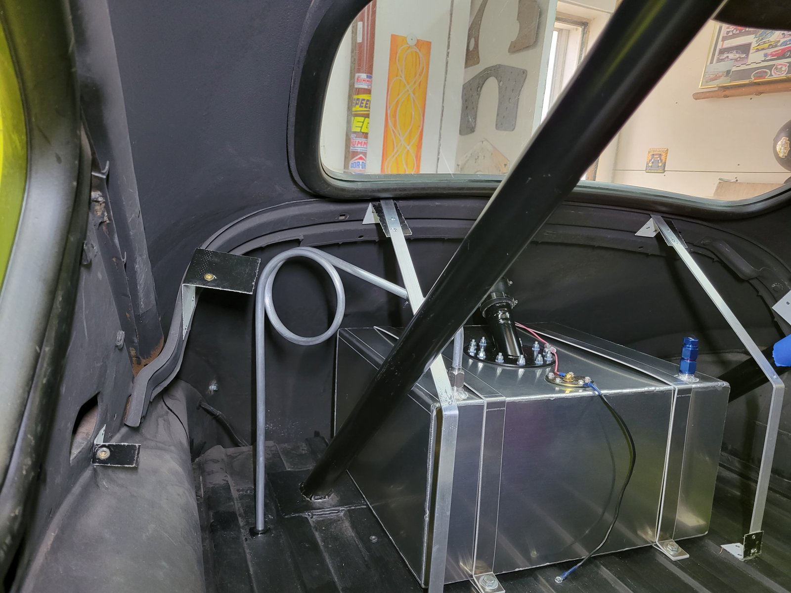

  6. I agree with the above. In your pictures, you appear to have a lot of space above the tank. Run your vent line UP from the tank, loop is several times, then have it go down through the floor. I would use steel line for the looping as the rubber line may collapse from all the loops. I'd draw a picture but the nurses took my crayons away ... I kept eating them o_O ... the crayons.
    Nothing wrong with making the vent line a combination of steel and rubber (actually, by "steel" I mean NicCop as it is so much easier to work with than straight steel).

    Put loops in it like the still has in the above picture, it takes way more fuel to reach the top, and the fuel runs right back to the tank when it cools back off leaving a clean empty line. Run it out the bottom, you don't want fuel vapors or liquids anywhere near your paint.
