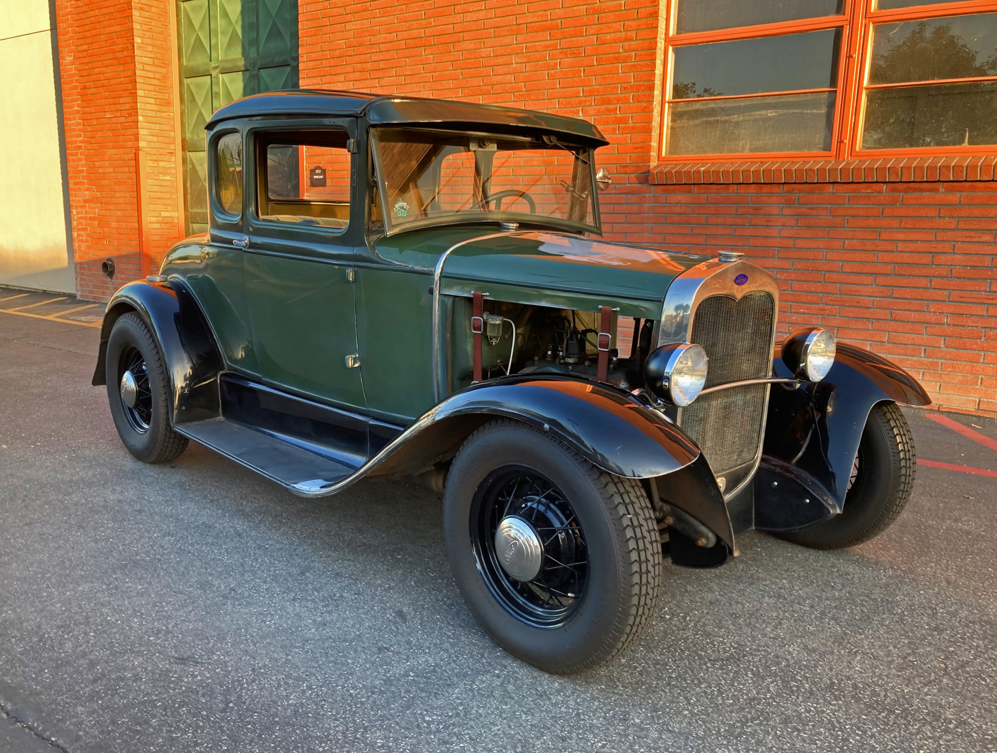

    Hi guys,
    I fell in love with the full fender style you see below and I want to identify the wheel/rim combination they are running. It looks like the rims are 18" 1932.
    Any feedback is highly appreciated. Same for leads to find a set of rims.
    Thanks, Phil
    460047041_3787565478172276_6763499417625114336_n.jpg 461542095_505254172393631_3333462558189130231_n.jpg 461542095_505254172393631_3333462558189130231_n.jpg

    There are three versions of those wheels, 32 Ford 18”, 33-34 Ford 17” and 35 Ford 16”. The 16” were the most popular. The example photos look to be 17 or 18 inch. The only issue with those is available tire selection. 18” are pricey and limited selection with the stock rim being I believe 3.5” wide. Bigger selection for 16” tires.

    Yes, I agree those look like 32 18”.

    Looks like 5.50x18 7.00x18 tires to me

    The Tudor on the left has the straight spoke 1935 Ford 16" wheels. 5.50 front and 7.00 rear tires. The Coupe on the right has the 1936 Kelsey Hayes 16" 40 bent spoke wheels. with 6.50 Excelsior radials. The Tudor has a reverse eye front spring. The reverse eye spring for the Coupe is in the garage awaiting winter installation.

    To the OP, and anyone else new to the Model A world, that’s a 1930 with 1932 grille and wheels.

    I found info about the green 5W coupe:
    Really nice older resto car then decided to do full on traditional Hot rodRicky Bobbys rod shop did the transformationThe car was a really nice no rust ever car no patches or fillerBrand new build on a 49 flatty with a T5 to back it up cruises at 75 no issueselectric fan and aluminum radiator40 Lincoln brakes and rearSo cal shocks and beam32 Ford Wires with all new Coker tires39 ford column with banjo steering wheel32 deluxe grille shell with 32 commercial lightsNo expenses spared no junk all new partsCheck out Ricky Bobbys builds they are the real dealThis car is driven not just trailered around if you want a real deal driver this is your carFeel free to call me 615-504-9834Matt HooperHonestly if you are really interested its easier to call for all the info

    isn`t that the perfect stance? Looks like 700-18 in the rear
