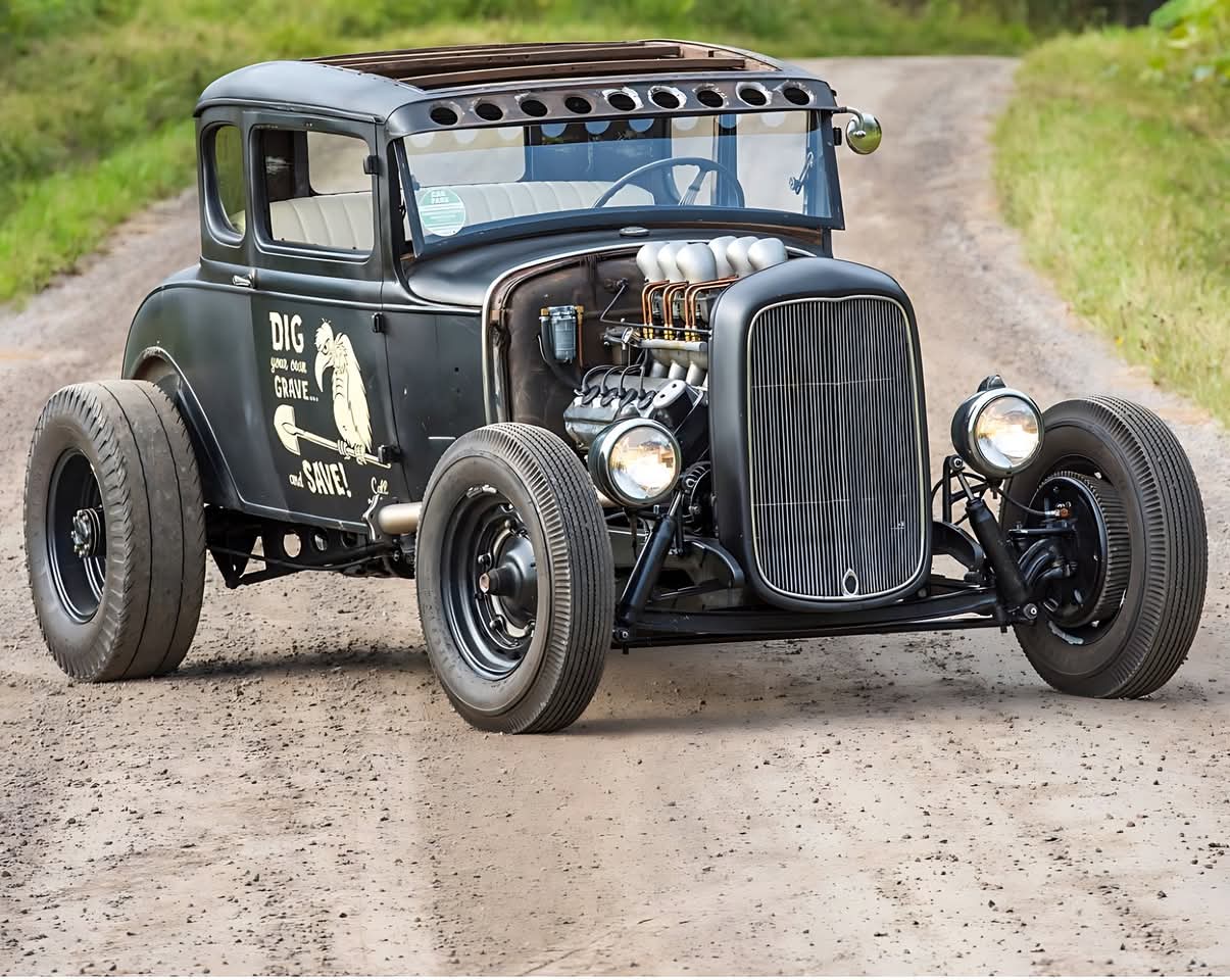

    .00000000000000000000000000000000FB_IMG_1742571657629.jpg The A I saw in the thread today .
    I copied it to my computer because it had a Hemi in a channeled A like I want to do ( 31 PU ) and it had a really cool industrial / g***er look to it with the floating rear end .
    I have seen 8 lug magnesium rims before that made me think it was on a floater in a dragster or other drag car

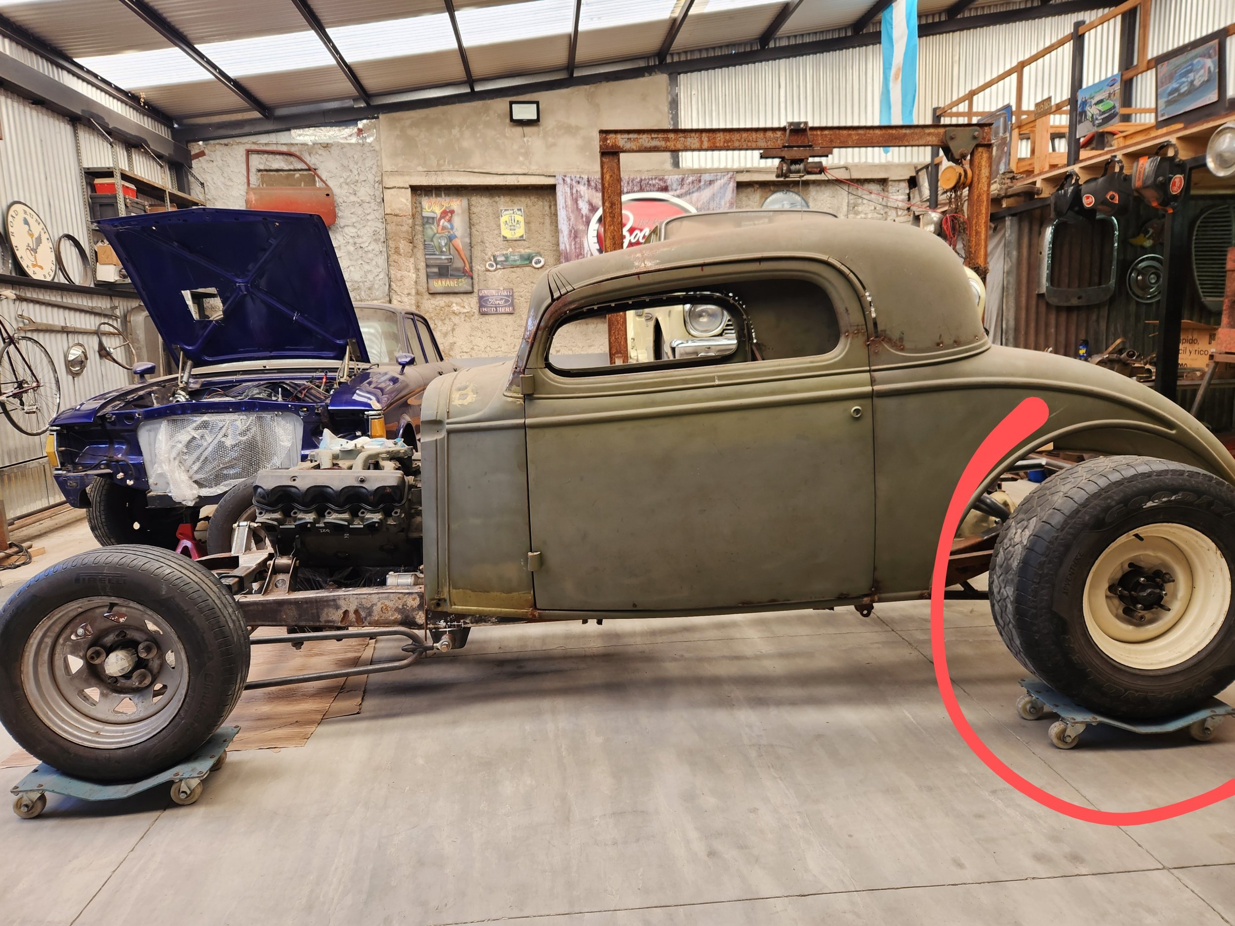

    And here is mine
    dwollam, Phillips and 1952henry like this.
