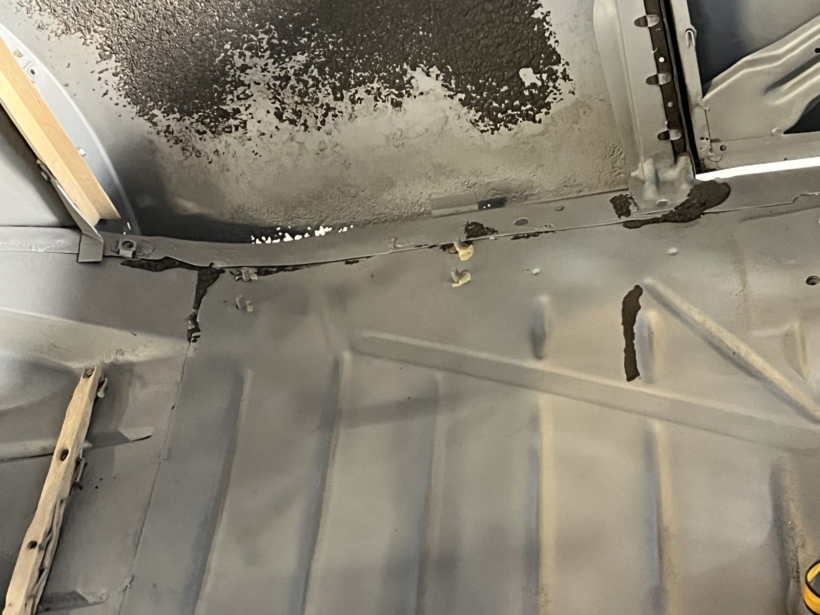

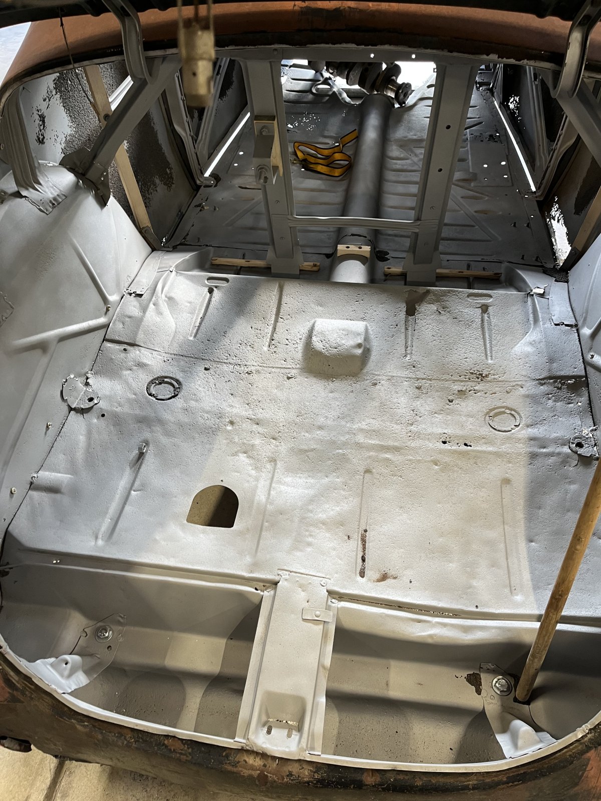

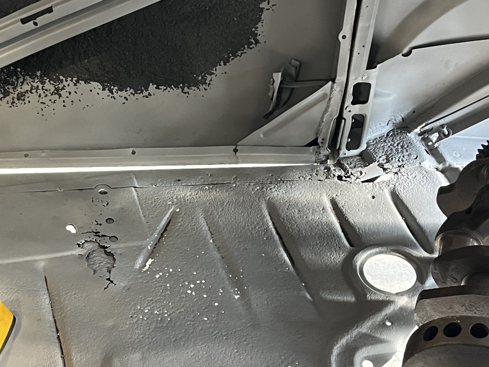

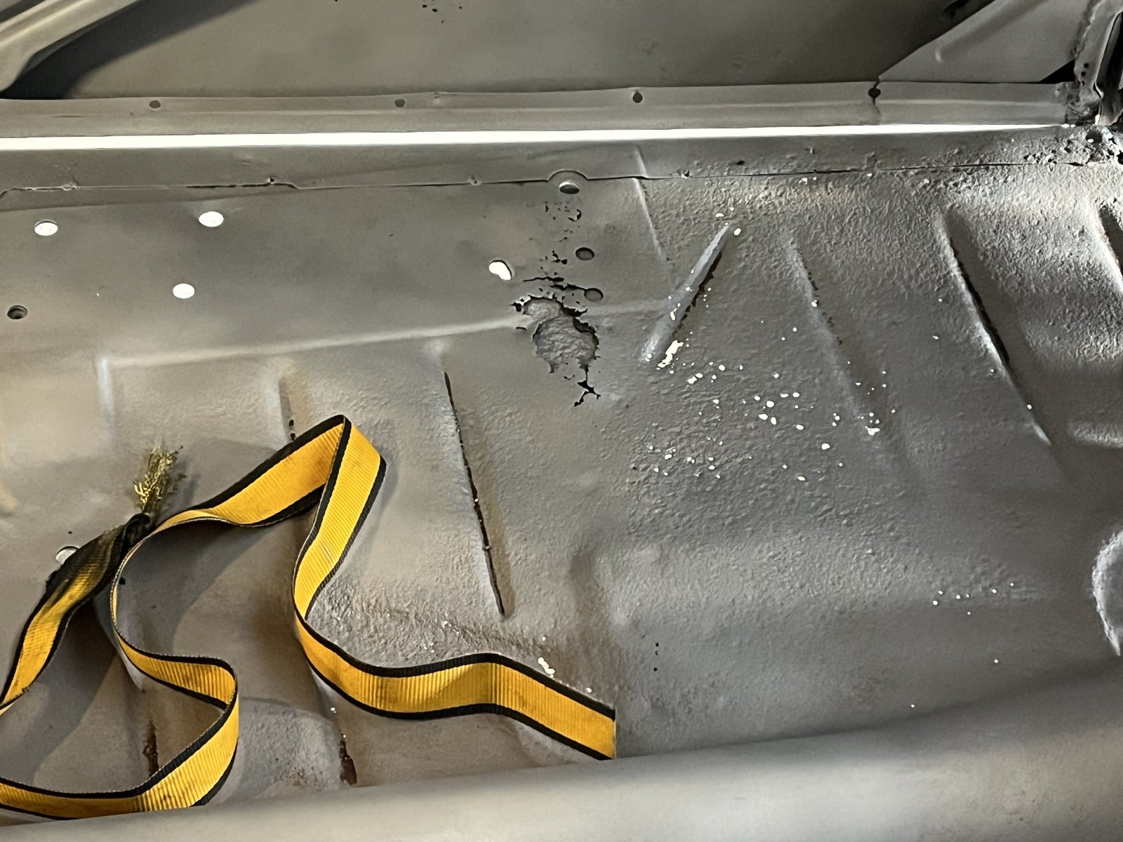

    I got my body back from the sandblaster today. The floor is definitely worse than I thought (but I expected that). Looks like I’m going to replace the full floor including the trunk. A few questions for those that have done this.
    1. Dennis carpenter floors any good? Looks like they have both (saves shipping).
    2. can I do the front first, then move to the back (or vice versa) for less bracing?
    3. how much bracing do I need to do? How do I brace it so that my braces aren’t in the way of dropping the new floor in?
    4. how do I ensure the holes like up with the frame when I’m done? Just a bunch of test fitting with the frame before I final weld it?
    I’ve done plenty of metal replacement on other cars so I get the gist. Just looking for tips on this specific car as it’s my first ford and full floor. Thanks!
    I’m also probably going to have to do the rear tail pan which I ***ume I would do last (to keep the structure good while doing floors).

    Great start. I would err on the safe side and brace the **** out of it. I have a buddy with a 67 Camaro that was patched up without bracing and it doesn't sit level to this day. Cheap insurance and you get to re-use all that 1x1 for years to come. Win, win!

    As BB said, but I will ad, also measure a million times to verify things are square etc. then brace. No point welding a floor into a crooked body.

    You can do the front first and then the trunk area. Check out my sedan build below and it shows how I did my full p***enger compartment floor and rocker change on my 39 using a *****in floor kit. Brace the hell out of it. It will move I. Ways you don’t expect.
    Also, the way the floor ***embly goes in is floors under rocker/subrail so keep that in mind. Also look carefully at your subrails. I replaced the subrails all the way back to the rear wheel well on mine at the same time as the floor so I was able to get the floor under the subrail/rocker and mark, drill and line all the mounting holes up before welding it all together

    First make sure the doors and trunk fit properly now. Personally I’d brace it crossways, then X’s both vertically and horizontally in the door area. Also same thing across the trunk opening. Then you can remove either the front half or rear half and drop the new panel on the frame, then set the body over to verify fit. You can weld through the spotweld holes that you drilled to remove the old floor.

    you guys ever see east cost rust.that floor is mint compared to what you deal with. i noticed your spare is on the left side so is mine most 40,s on on the right paule bradley makes the best floor he is hard to get but if you are lucky you might luck out. ps i would repair that floor it aint that bad & remember it gets covered when done

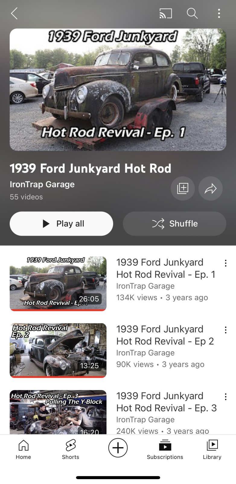

    @IronTrap has a great video on YouTube replacing the floors in the forgotten 39’ hotrod project I would ***ume it would be mostly the same procedure wise

    There’s a whole playlist of each car on their channel on you tube. I tried to link the playlist but it would t work. This is what you’re hunting for. Around episode 7 they brace the body and around episode 20-21 they replace the floors IMG_7354.jpeg
