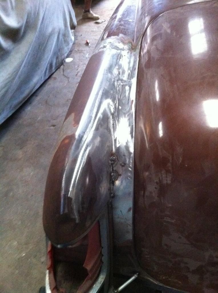

    Update, the top part of the 54 merc quarter/taillight is all welded in....
    There's a little bit of lead that has to be melted out so Manual can get a good weld in there
    You can see better with this pic how once rolled it will flow into the trunk area very well

    Great work so far, I like what you've done with the taillights/rear fender.

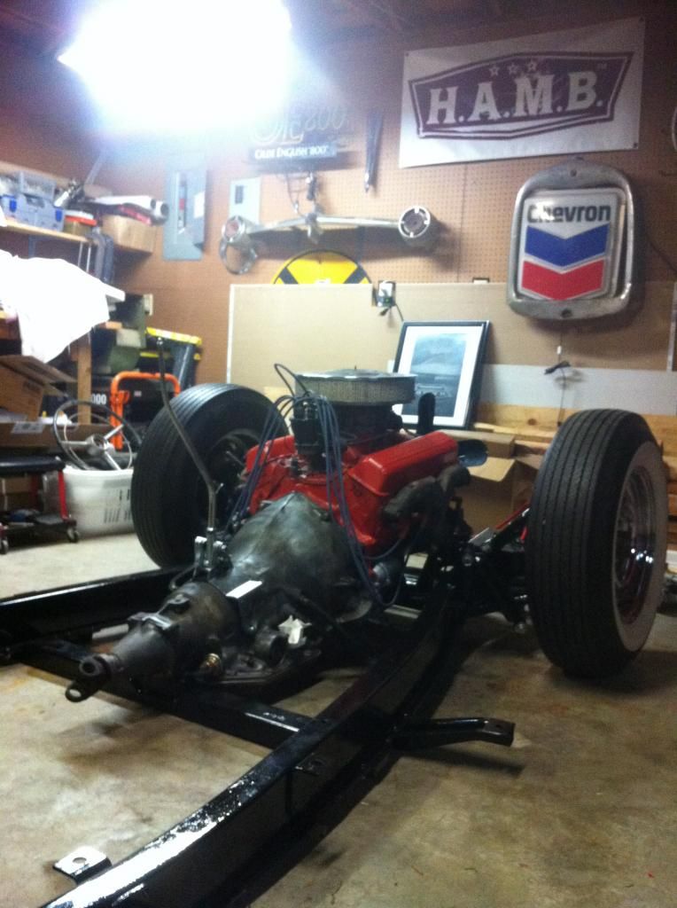

    Motor is in!!!!!!!!!!!!!!!

  18. greasebandit0801

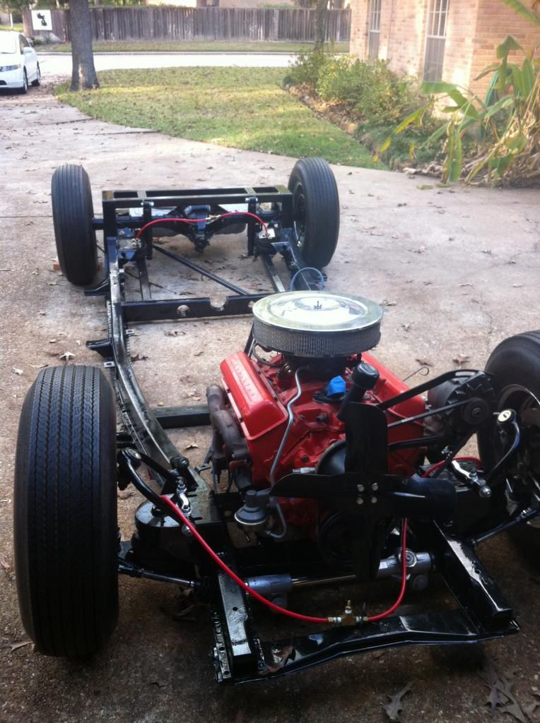

    Just wondering forgive me if I missed it in the thread but were did you buy you 2 link are those the same ekstensive metal works sell or did you fab those up ethere way set up looks good you must get some good lift in the rear cool ride thanks
  19. chaddilac
    Joined: Mar 21, 2006
    Posts: 14,090
    chaddilac
    Dang!! That frame looks awesome loaded up and all laid out!!!
    What rearend did you use?

    Thanks everyone, I originally did the 4 link setup but did not like the extensive fabrication needed inside the car. The 2 link setup came from Manuel and Roy, they run it on all their cars. Pm loco 52 ragtop on here, they are the ones who did it for me......

    Thanks, rear end is a 69 Camaro.

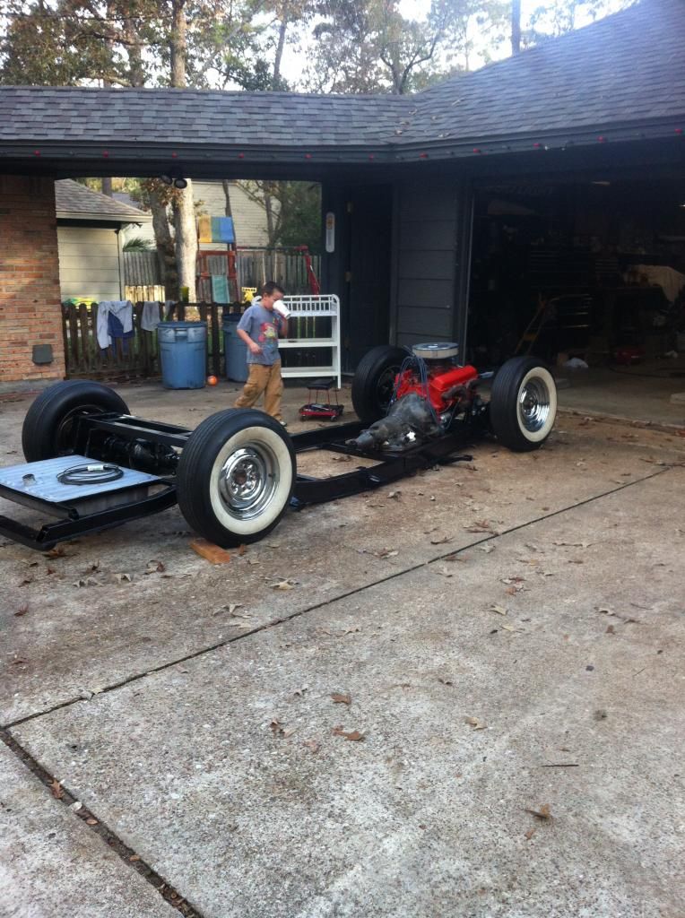

    I need to plumb the fuel line and then we will be putting the body back on the frame
    Thanks man...I've been planning what I will do for a while. It has gone through many changes in my mind, (just dropped, no chop, the list goes on and on), hopefully after everything is done it will set it apart from all the other 53/54's at the shows....

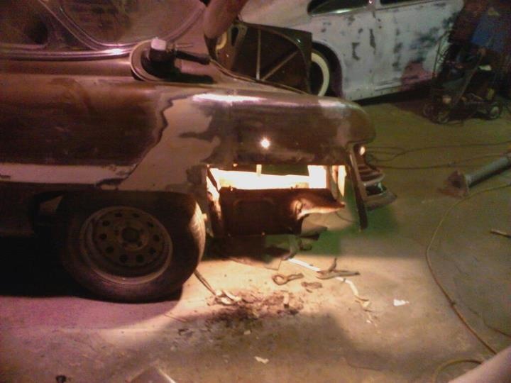

    Here's you some body mods.....
    Started fitting the ret of the panel in....

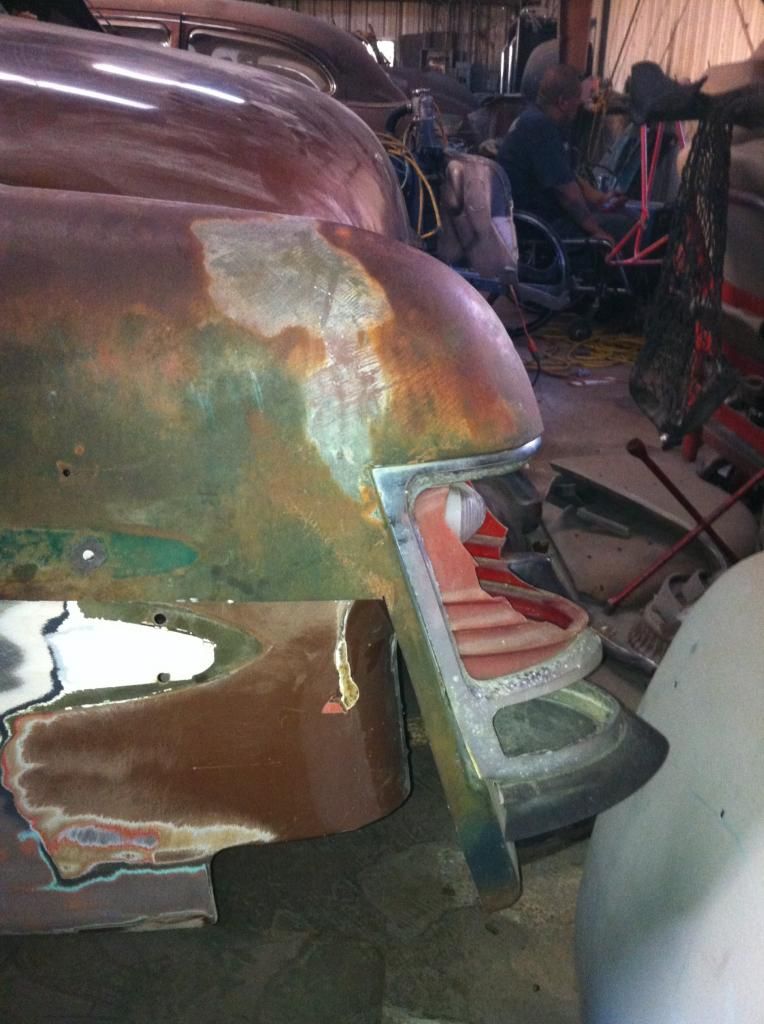

    From a distance
    What is really nice about this is the appearance of length it adds to the quarter. The top of the curve of the 54 merc quarter is fairly close to where the original tail light was located. With the added material on the bottom length is added to the quarter......More to come
