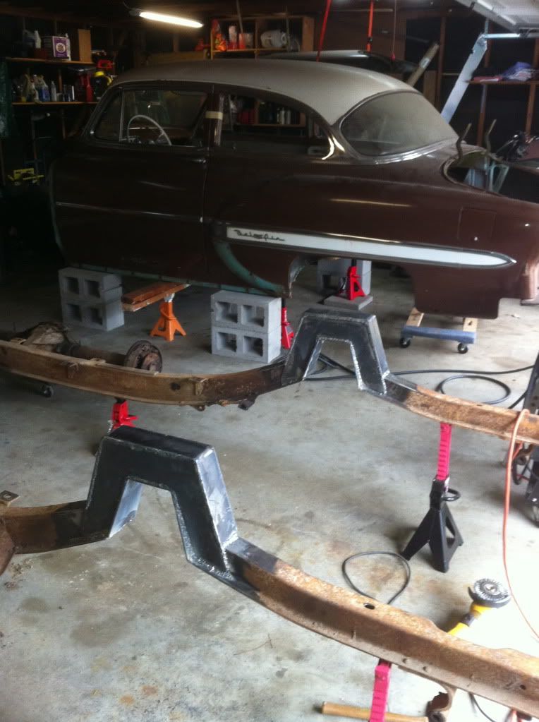

    Alright, here some updates...I started on the notch today
    Some mock up just to check things out
    welded the top part in, remember if your doing one of these this part has to be trimmed a little, at least mine did
    Ready to be welded to the frame

    My helper got home from school, so he got busy doing some cleaning on the frame while I welded the notch into place (he knows not to look in my direction while I'm welding)
    Notch welded in place

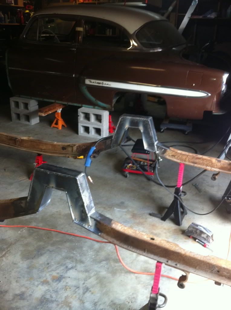

    Set the other side in today for welding up
    Welded in place now

    I was a little nervous when it came to this part, but what the hell go for it
    Tacked the bottom support in place

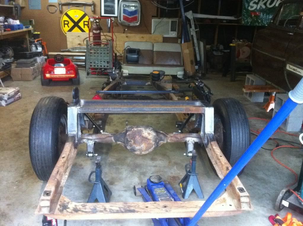

    Alright, didn't get anything done yesterday, so today I finished welding the notch in
    another shot from behind

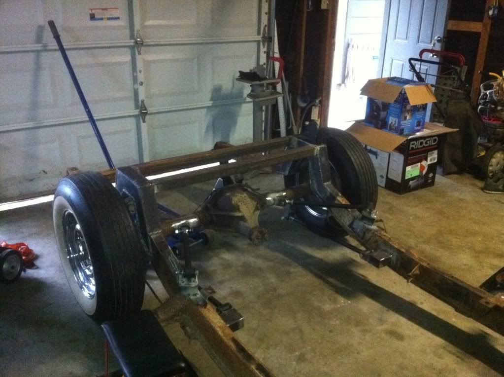

    This picture is from when I started setting the rear end in, it is now centered and ready to start getting the four link ready

    Alright got a few updates. Put the supports in between the notch, used some 2x2 square tubing.
    Put the bottom bars in place, and started laying out the top bars
