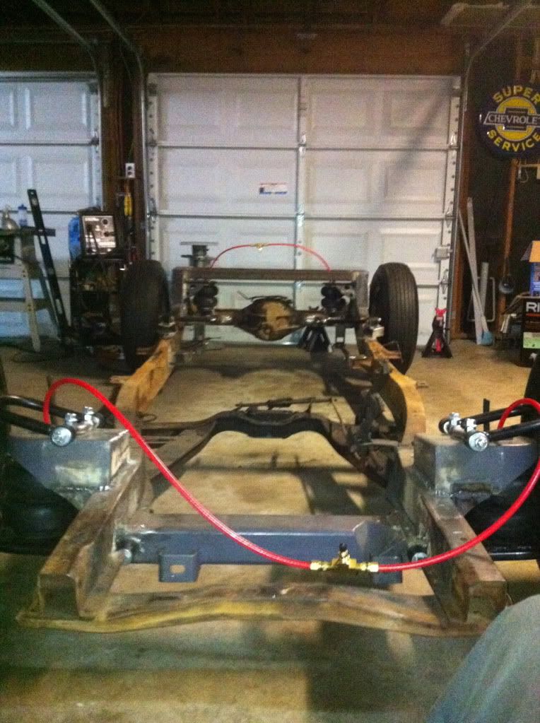

    real quick update, tacked welded the bag mounts in place and put the air line in to check everything out before final welding on the bag mounts. This picture is of it aired up
    And of course this one is aired out. The ****** crossmember is the first thing to hit, but that will change due to this area needed to be cut out and rebuilt

    Worked late last night. After I got the rear done I just had to ***emble the front just to check it out.
    Air out, resting on the ****** crossmember

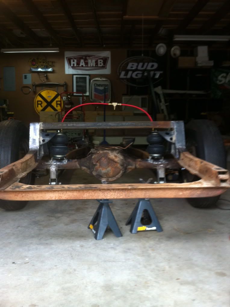

    This should be about ride height

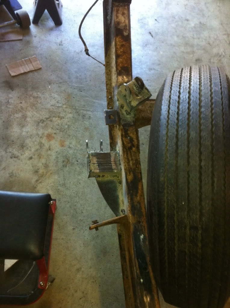

    Hi Eric, I'm laying out my notch in my '54 4 door and was wondering if I could bother you for a measurement? If so, in pic #1 below, the measurement from the CL of that body mount hole on top of the frame to the rear edge of the notch at where it meets the frame. It would be greatly appreciated if its not too much a h***le. -Brent

    Had a few set backs this week, but got a few things done
    Made some supports for the bottom brackets for the 4-link and the part to the frame

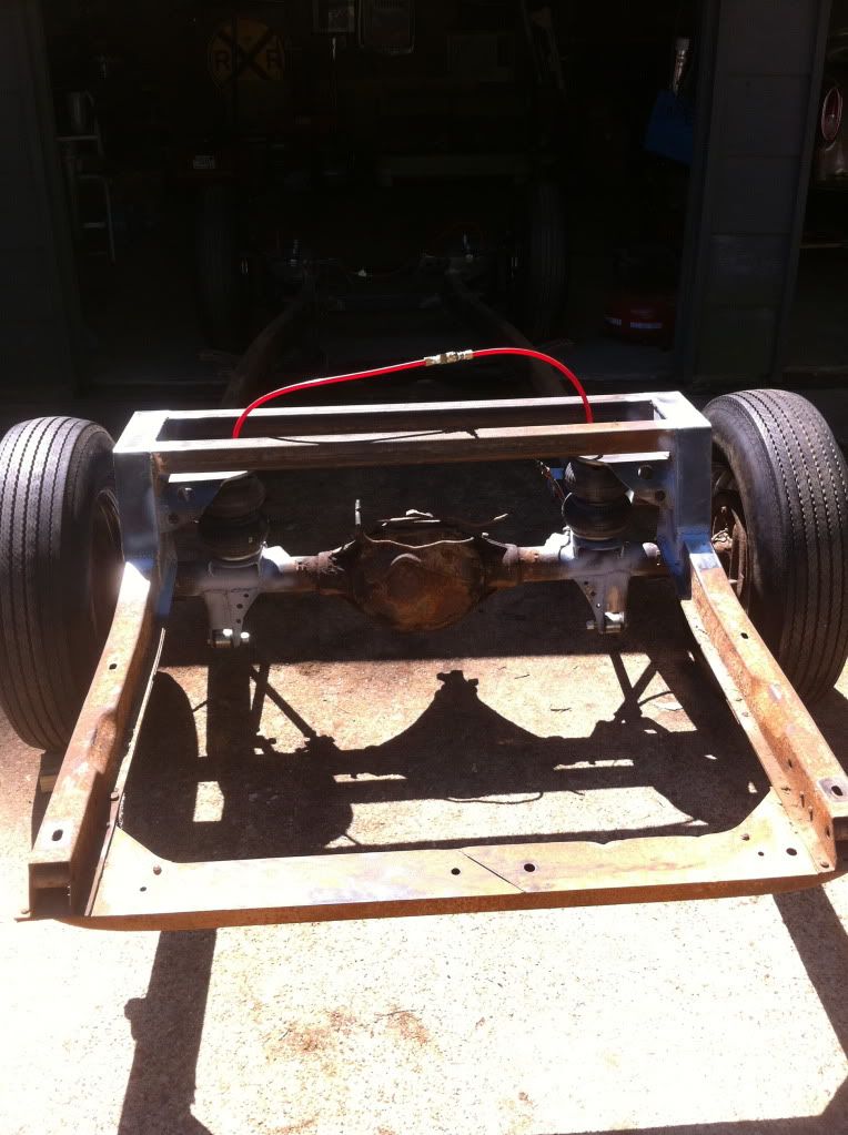

    Finished the welding on the rear, sprayed some rattle can primer on and put it back together

    mrconcdid
    from Florida
