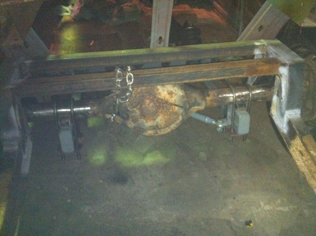

    Been lacking on the updates, my car is with some local guys Manual and Roger who are doing one hell of a job doing the necessary things to make it right. They repaired some of my welds so I started the Por-15 on the front....
    Something that bothered me about the 4 link setup was the amount that needs to be trimmed out of the floor and how much the rear seat has to be modified. So I got to looking at how they set up their cars and talked to a few of their club members and they have had no issues running a 2 link with a panhard bar and they way its looking no floor pan modification.....

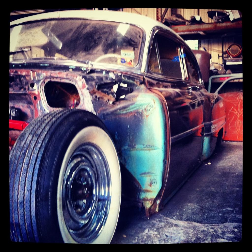

    Thanks Eric, here's some more.....don't you just love skirts ImageUploadedByTJJ1349998524.868183.jpg

    Thanks, the re-do on the rear end is all Manuel and Roy, it is now a two link with a panhard bar....I will post some more detailed photos of that when we separate the body from the frame again. Plan is get steering linkage done, then 54 merc bumper and taillight then separate the body. I'll wire wheel the frame, por-15 it, run brake & fuel lines, set the 327 & turbo 350 and then we will put the body back for the last time

    Alright here we go updates, we pulled the body back off the frame tonight for some welding then painting of it this weekend. Maybe you'll notice the 4 link is gone and is now a two link with a panhard bar
  23. eric54chevy
    Joined: Jun 3, 2009
    Posts: 988
    eric54chevy
    from TEXAS!
    With this setup, the motor is able to not ride so high. Still the front crossmember is the lowest point in the drop. The ****** crossmember is removed and a new one fabricated that is removable. So with all that the transmission tunnel needs no modification, front and rear seat do not need to be modified making life a hell of a lot easier. Lord I wish I would have done this in the first place.....
    I believe, I'd have to check with Manuel, but the rear end is set at 5 degrees down and once at ride height comes back to 0 degrees...
    Last pic until frame clean up and paint this weekend.....The gas tank bracing is fabricated and welded in

    Is your rear air bag set up just so you can (for lack of better words) play with the linkage and set up? Or is that how your going to run your rear bags, though that "T"? If so aren't you concerned about air exchanging from one bag to the other during turns?

    Like you said to play with it, the front has the same set up. It's just a cheap set up to make sure everything is functioning correct. It makes it easier when you need to move the car around.
