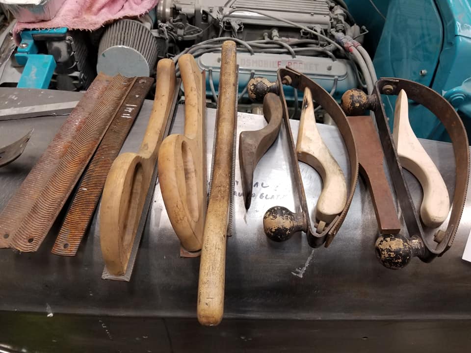

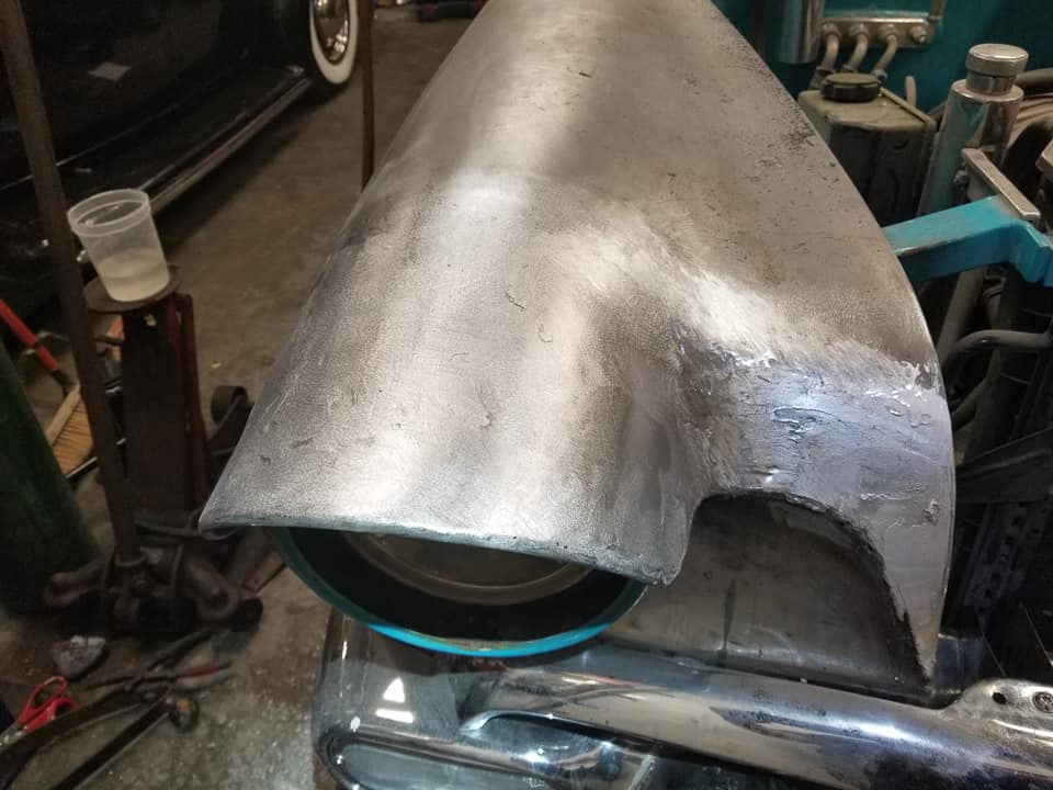

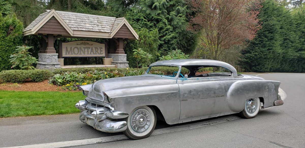

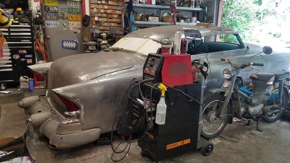

  1. Hello after being gone for over 5 years. Im back !! So Im about to spray an Epoxy primer over the body that has alot of lead on it. Is there anything that works better or worse as a DTM over lead. 93279849_10158108075832726_4741008656236019712_o.jpg 68324796_10157372734372726_4459978169985794048_o.jpg 34716285_10156370786527726_3488689071390195712_n.jpg 46446112_10156746399122726_6365188081527554048_n.jpg 46800580_10156763532802726_4601025883828912128_n.jpg 46453287_10156749015267726_1793111827756875776_n.jpg

    The shot in bare metal makes it stand out . :cool: I can appreciate your efforts.
