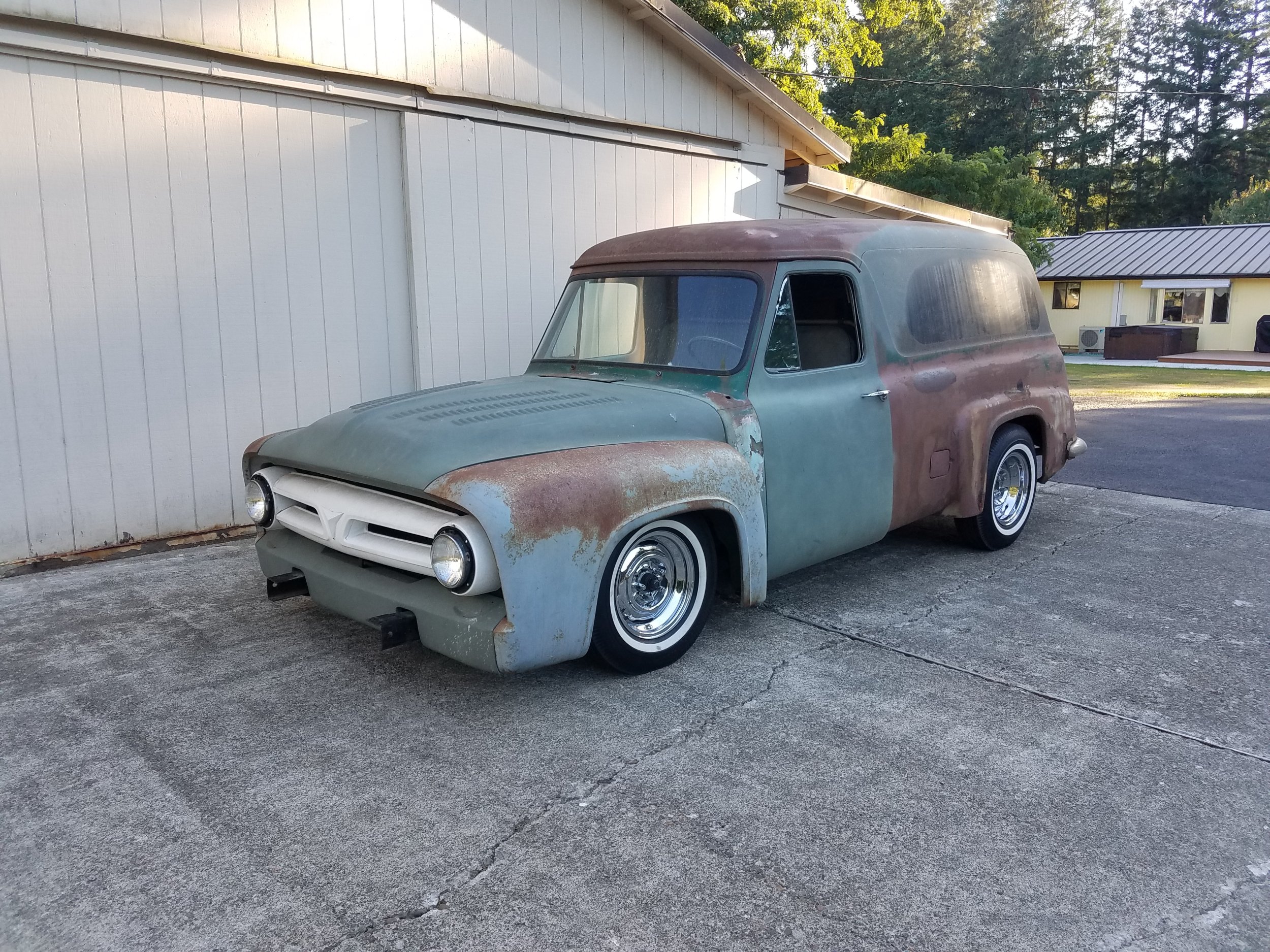

  6. There was a lot of different approaches to it back in the 70's. None worked very well. Believe it or not I actually was quite involved in the F-100 thing. I still have 2. Your not actually doing a tilt Hood, you're trying to tilt the complete front Sheetmetal. The front Bumper is a large obstacle to deal with. You can eliminate it, helps some. Lower valance and front crossmember is the next issue. Front fenders tucking under the Cab corner at the running board needs some surgery to make the lift go better. You can't (I couldn't) fully eliminate fender corner to cab (make that Paint) contact at some point. Once you get it open and want to do any work on the motor you have to remember to duck both going in and coming out. At some point you're going to use some Off-Color language. At the time both Street Rodder and Trucking magazines ran many how to articles. None were very helpful in total success but got you in over your head. My beliefs have always been what brought on all that Tilt stuff was the stock hood hinges were just a bitch to get adjusted right because most didn't know how to do them correctly. That started with guys not knowing the Correct way to open the hood to begin with. Personally, I like just a forward opening Hood like on my current 53 Pickup.
    This is not one of those Kits that also are a P.I.T.A. and leave you at the mercy of the Wind when it's in the Open position. The Hood on my 53 Panel opens the same direction and hinges the same, no gas ram assist.
    I know I wasn't much help, but I've been involved in about every direction of F-100 stuff there is out there and I have yet to be involved in a Good way to do it. Best of luck to ya.
  7. [​IMG]
    Look closely at this photo. Common practice with the fender modification. Looks like maybe some Teflon on the contact edge of fender to cowl. Now look just forward of the heater vent louvers. That's a strike point in the paint from closing the nose down. It just seems it can't be avoided.
    mad mikey and Bandit Billy like this.
  8. Also, I'd bet that's as far as that unit opens. Hardly worth the work involved.
