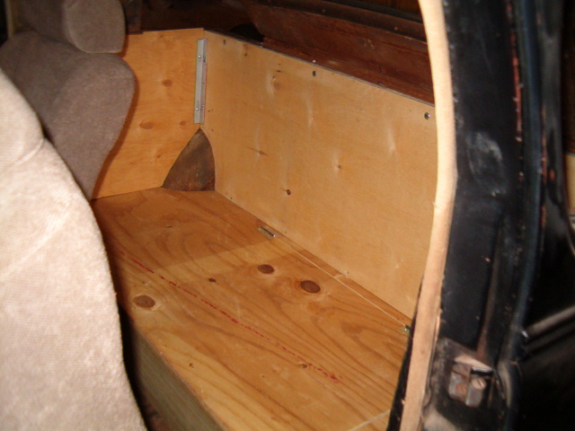

    Starting to finish out the floor and am going to make a solid rear firewall on my 37 Ford business coupe.. it was bare when I got it and the floor had to be completely re-engineered.... So I find lots of pictures of interiors, both stock and custom, from the front seats forward, but nothing behind the seat... Have no idea how it was originally done...
    So what has everyone done back there? Shelves, boxes, how the headliner ends in the back, etc...
    I would like to see examples of people's ingenuity!

    Put the seat in, that will help determine where you want to place the verticle part. Most coupes had a package tray that came from below the rear window to the rear of the seat in the most back position. Looks like there might be one of the original brackets just below the rear window in the 1st picture.

    Yea, there is part of what looks like a frame for a shelf, although it looks like it kind of goes downhill... Did the headliner go down to that brace, or to the body seam below the window?
    The corner where the headliner needs to tie in somewhere has me stumped...

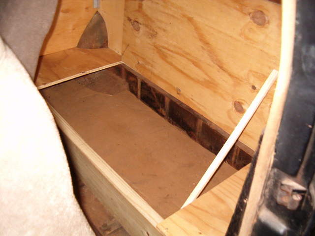

  10. ...here's how I did the rear area in my 37 Chev coupe, never finished it up any further, great storage area for jack, tools, etc.
