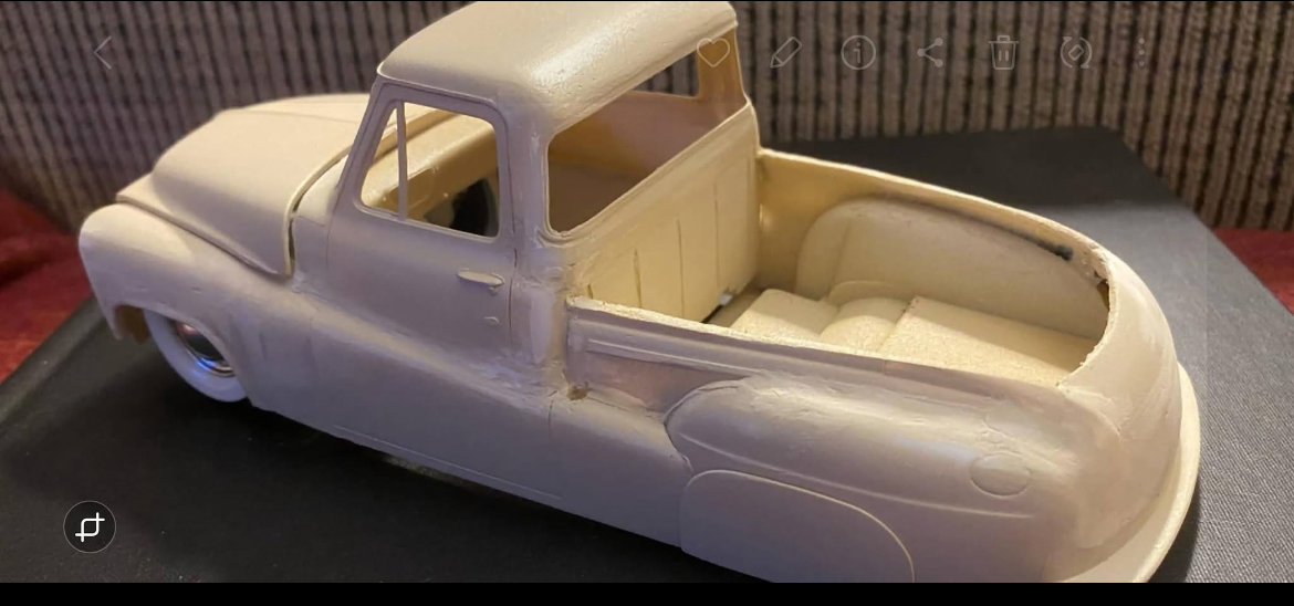

    Excited to see this. Here is a 48 i just picked up
    But keep the 46 nose

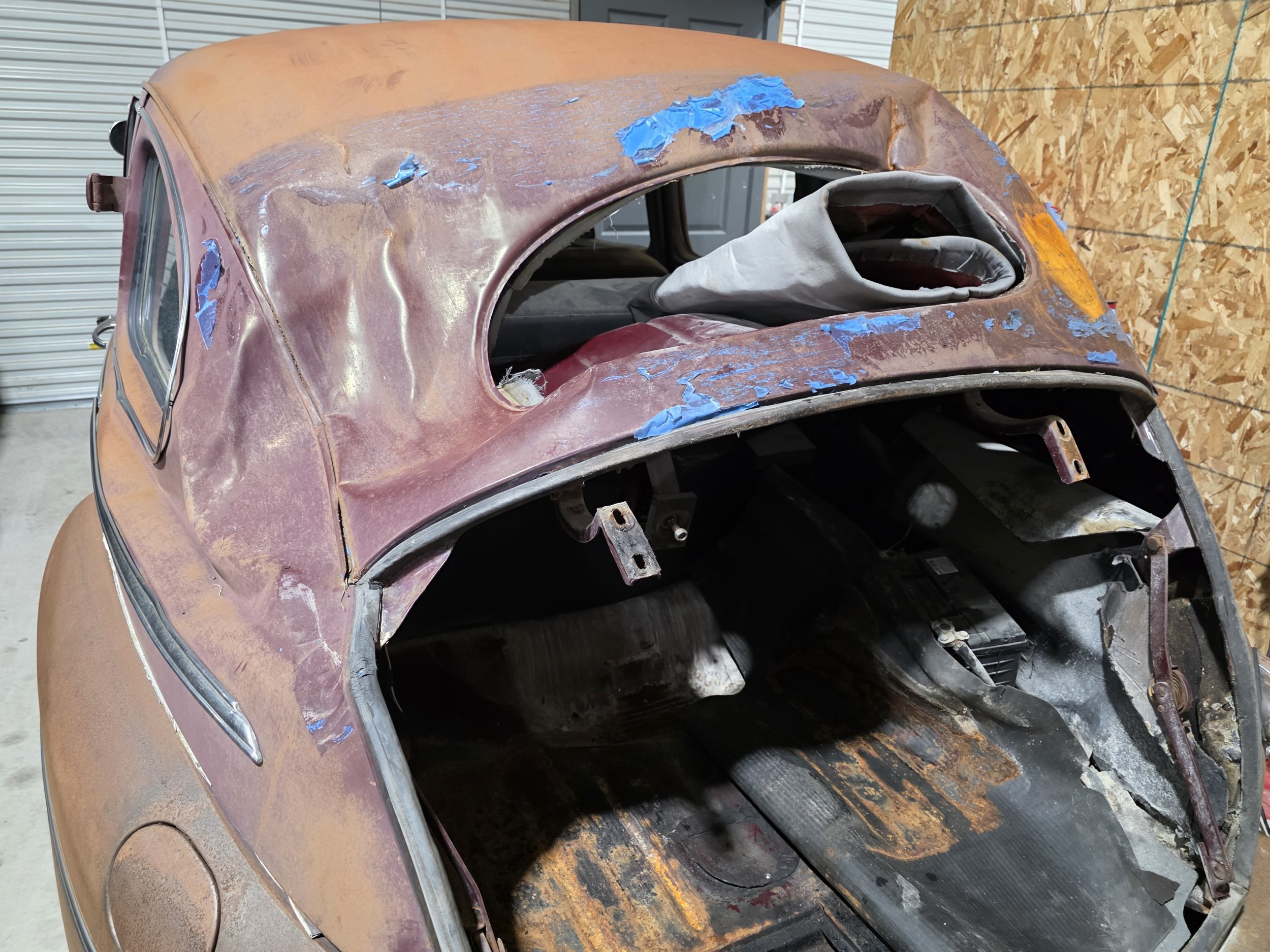

  17. WhatDidIDo
    Joined: Aug 15, 2025
    Posts: 9
    WhatDidIDo
    Cleaned out the tree and gl***, started doing 30 minutes of "work" with a hammer and hydraulic ram. I can at least open the rear door now.
    Before:
    After:
    May not look like much, but I am happy with the progress, here at Somethin Ain't Right Auto Body. Lots more to do, lots to learn. Thanks for the advice and ideas.

  18. Getter done
    That’s how they did it before
    And would use less than a half stick of lead

  19. Hnstray
    Joined: Aug 23, 2009
    Posts: 12,357
    Hnstray
    from Quincy, IL
    You have a good start on straightening!
    enloe, porkshop, Paul B and 4 others like this.
  20. 05snopro440
    Joined: Mar 15, 2011
    Posts: 3,498
    05snopro440
    Looks like a good start! Keep at it!
    porkshop, Paul B, Greenblade and 4 others like this.
  21. evintho
    Joined: May 28, 2007
    Posts: 2,616
    evintho
    That can be brought back into shape. You're on the right path and progress looks good. You can do this!
  22. Squablow
    Joined: Apr 26, 2005
    Posts: 19,045
    Squablow
    Even if you end up grafting a roof section in there (which I still think will be easier/more realistic), this is still a good idea to do first. Gotta get the door gaps right and things shifted into position before you start cutting, because cutting out the damaged area doesn't necessarily relieve the stresses on the metal and shift everything back into position.
  23. bobss396
    Joined: Aug 27, 2008
    Posts: 18,909
    bobss396
    I'd push it out some more. Check door gaps on both sides of the car. Get the trunk lid to open, close and latch.
    There will likely still be stresses you'll find once the damaged area gets cut loose. It may pay to tack in some braces across the back of the car.
  24. HOTRODNORSKIE
    Joined: Nov 29, 2011
    Posts: 755
    HOTRODNORSKIE
    Looks like you can start playing with fire heat it up and hammer away it would be nice to have a guide from another car though. As for the paintless comment I get people coming to me all the time with stuff like that on late model cars and tucks no **** can't make it up.
  25. 210superair
    Joined: Jun 23, 2020
    Posts: 2,681
    210superair
    from Michigan
    Man your update pics look pretty good to me, damn nice improvement. My first thought was the juice isn't worth the squeeze, but you're making me a believer.... Keep Goin!
  26. Being a shop owner most of my life I wouldn't be afraid of doing total repair as is. Best part is nobody has been after it with a Ballpeen or block of wood. Second Best is the deck lid looks undamaged at all, good for test fit as things come back in place. My opinion is no torch work needed at this time. Get a good read as to how it folded up. Rule 1 is first in last out. Even the drip rail will come back in line for you. Body graph, not in my book. At least not yet. What I see as a little challenge is the back window opening. Those kinks will test you unless you remove the inside channel at its spot welds and set it aside. That will let the roof skin come back around on its own. Double panels don't work well. Nothing I see needs to be cut or heated, just separate any inside double braces and work the Body skin alone then fit the deck lid. Once you like the gaps refit the inner braces and plug weld the spot welds back in place. This is a good learning experience but for a farm out shop job probably not a good place to spend your $$$$. I'll be watching.

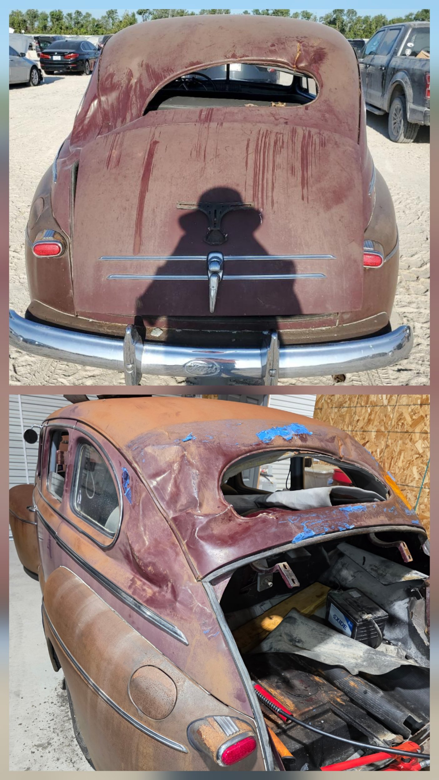

  28. WhatDidIDo
    Posts: 9
    WhatDidIDo
    Before and after, with another little bit of work over the weekend. I am hoping to get the structure pulled to near spec then introduce some heat into the equation and hammer and dolley.

  29. You gotta be smiling about now. Keep doing what you're doing but leave the Torch against the wall a little longer. Have you thought about removing the inner panel around the back window at all?
  30. RodStRace
    Joined: Dec 7, 2007
    Posts: 10,915
    RodStRace
    Avoid heat as long as possible. Metal has memory, and pushing it back it will try to return. Heat clears that memory, meaning you have to reshape without any help.
    You are a big chunk into getting it back.
