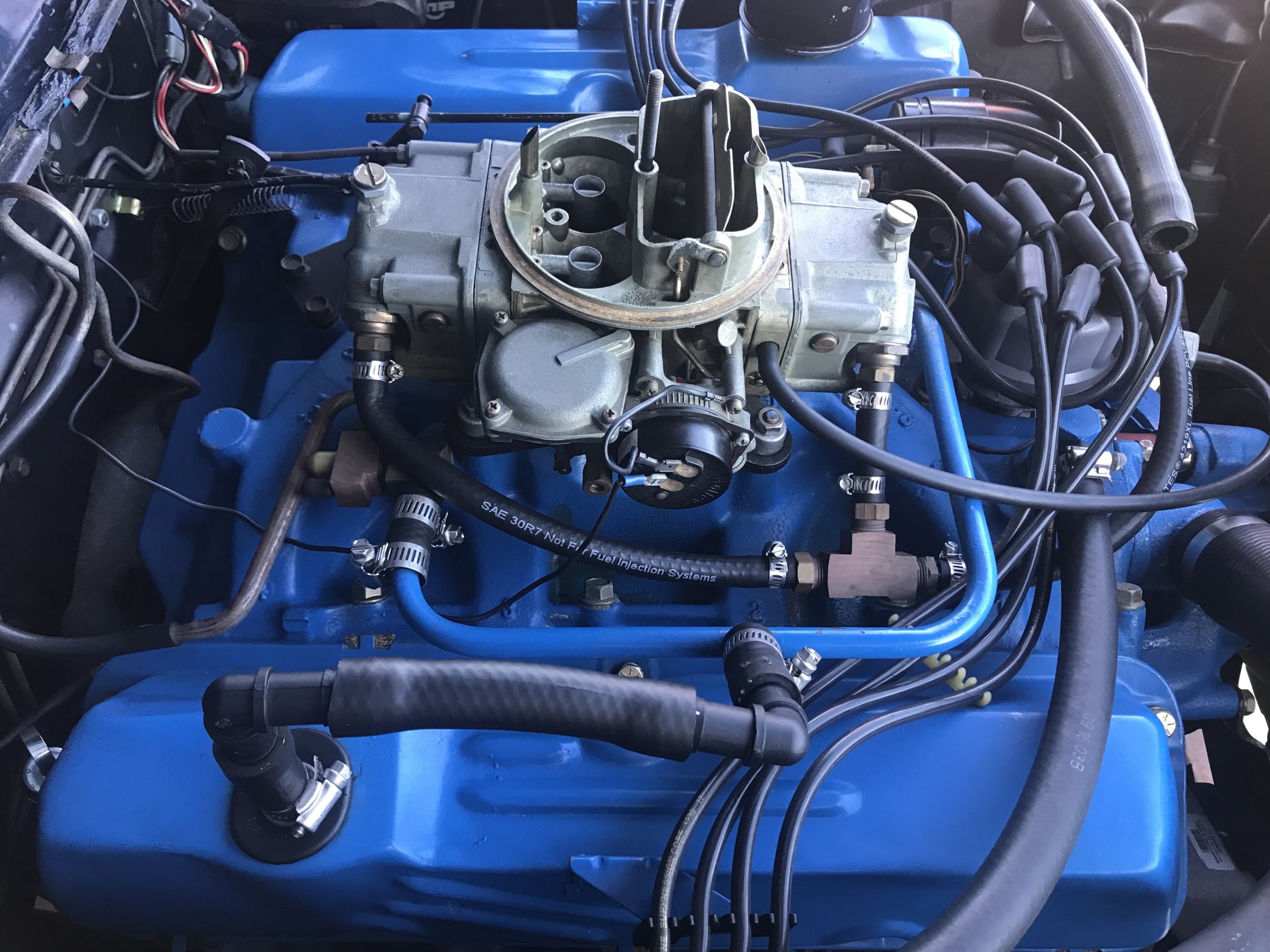

    Ummm.... You sure you want to run "ported vacuum" for your vacuum advance???? I'd try using full vacuum and see how the car performs....;)
    porkshop and bchctybob like this.
  3. bchctybob
    Joined: Sep 18, 2011
    Posts: 6,623
    bchctybob
    Good catch!! Honestly, I hadn’t noticed that. You’re right, I’ll have to try manifold vacuum. I haven’t looked to see what Ford did from the factory. I need to do a full tune work up on it, compression check, look at the plugs, check the timing. So far, I’ve only fiddled with the carb adjustments because it was idling very high when I got it. It seems lazy, like it’s retarded. Unfortunately, right now I have to work on it outdoors and it’s been raining a bunch so I haven’t messed with it. Just gathering parts and information mostly.
    Thanks for noticing that, I was focusing on getting rid of the rubber fuel lines and uncluttering the top of the engine.

    Posts: 854
    partssaloon
    You could move the heater hose connection to the water outlet and then use the manifold port for the temp. The heater isn't going to know the difference and what ever size you can find for the outlet port in the water outlet 3/8 or 1/2" you could ****** accordingly.
  5. bchctybob
    Posts: 6,623
    bchctybob
    Yep, I think that’s going to be the plan. I ordered a new thermostat housing and if it’s the right one, I’m going to modify it and attach the heater hose there. That will free up the port in the intake manifold for my temperature gauge.
    I ordered the Hi-Po 427 fuel filter and bracket, when it arrives the front of the engine will get a bit of upgrading with new fuel lines, return springs, temperature gauge, oil pressure gauge and a look at the vacuum lines for the transmission and vacuum advance.

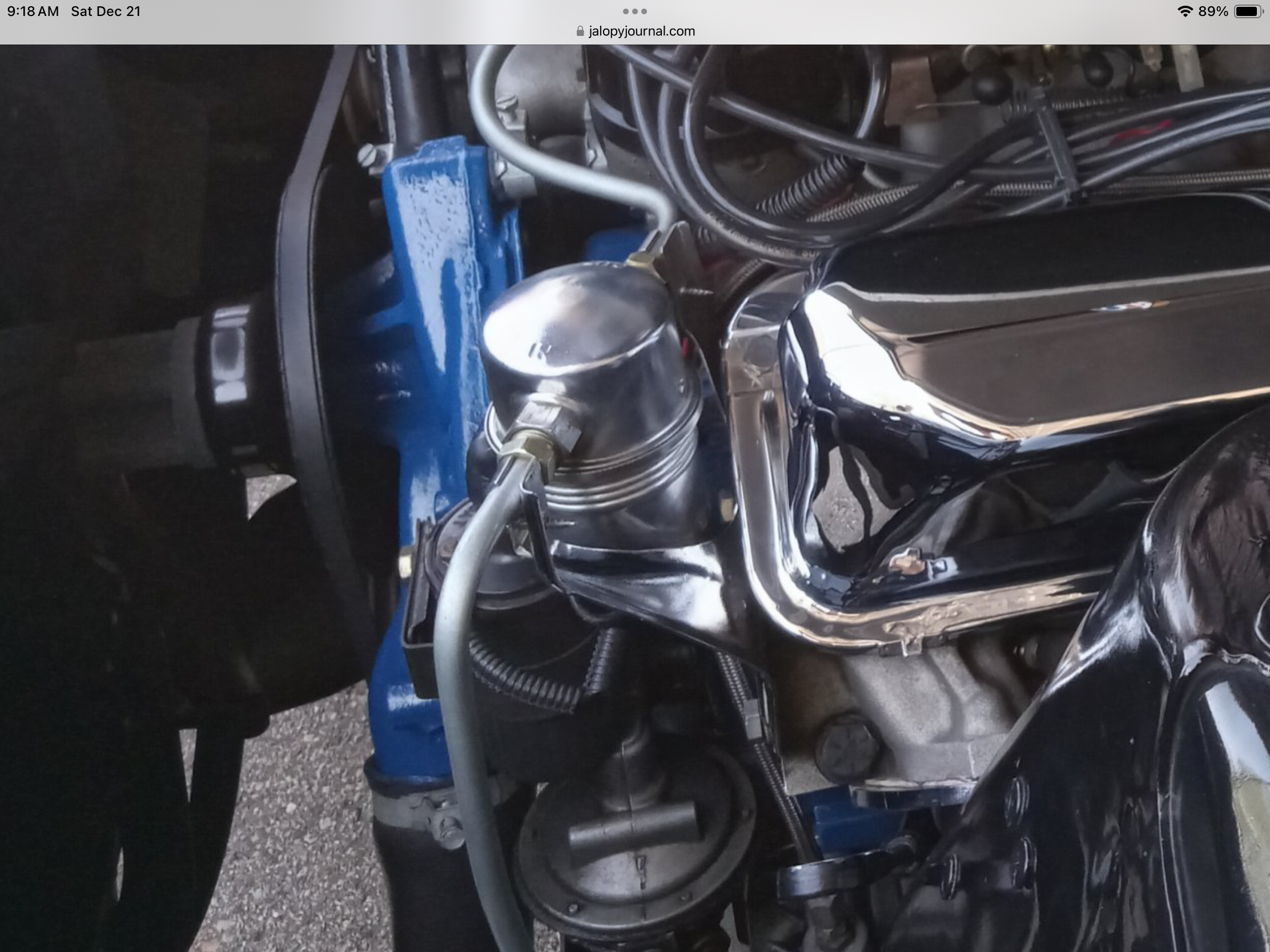

  8. Rodney Dangercar
    Joined: May 19, 2024
    Posts: 148
    Rodney Dangercar
    You will probably find that the modulator set screw will do this again. And again. And... I'm sure you get the idea by now! Once you get it dialed in I would do something to secure it so this doesn't happen again. Count the turns while unscrewing it, add a drop of Loc***e blue or just slightly crimp the modulator ****** (Yeah, baby!) to keep it in place.
    One other problem with the vacuum modulator is fuel condensate collecting down at the modulator, fouling it up. Once Ford discovered the problem they started routing the vacuum modulator line so that it rose above the carburetor and then down to the modulator, allowing collected condensate to be drawn back into the engine. Usually by mounting the line to the firewall and running it up and then down in later years. I made this to go behind my carb when I had a C4 in my Mustang.
    It's the loopy thing in the pic! Nice car and the FE in it rocks!
  9. bchctybob
    Posts: 6,623
    bchctybob
    Oooohh….. That explains the goofy vacuum line back against the firewall!! Thanks! I wonder why GM didn’t have issues with fuel condensate. I’ve never looped the vacuum modulator line in my life and I’ve never had a problem. I don’t recall seeing it on anything but Fords. Learn something new every day!
