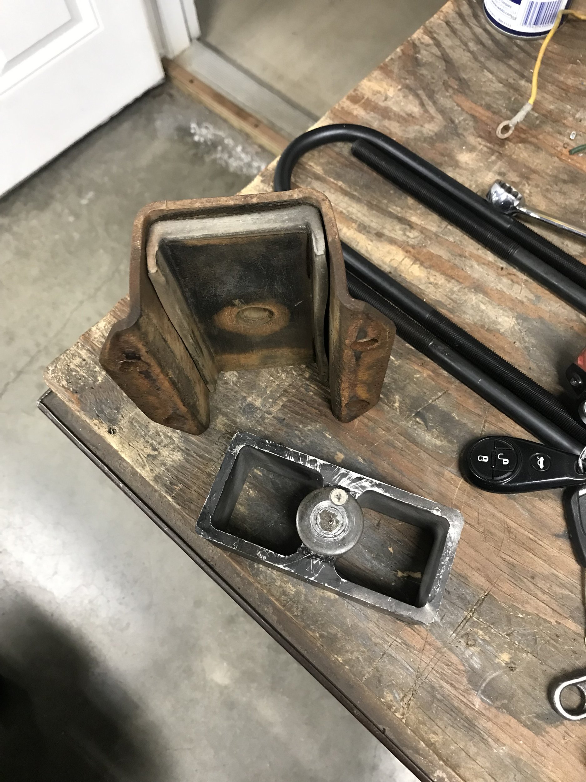

    Memories of working on ‘50s and ‘60s Fords are flooding back…. It turns out that the Ranchero rear springs are Ranchero only. Definitely different dimensionally than Mustangs and even Fairlanes. So getting lowering springs from conventional sources is pretty much off the table. So I dug out some 2” lowering blocks from upstairs and set about to install them. We have a local spring company that can make me some springs in the future but the blocks will do for now.
    When I removed the U-bolts I found that Ford uses a much different leaf spring center pin and the pads on the housing have about a 1 1/8” hole for the pin, much larger than the lowering block pins and holes. Ok. So I bore out the female side of the blocks to fit the springs and made some bushings to fit the blocks to the housing pads. I sorta wanted to keep the big rubber isolators but that just wasn’t happening. Everything went back together nicely and it’s noticeably lower. I’ll get a picture when the rain stops and I can take the covers off.

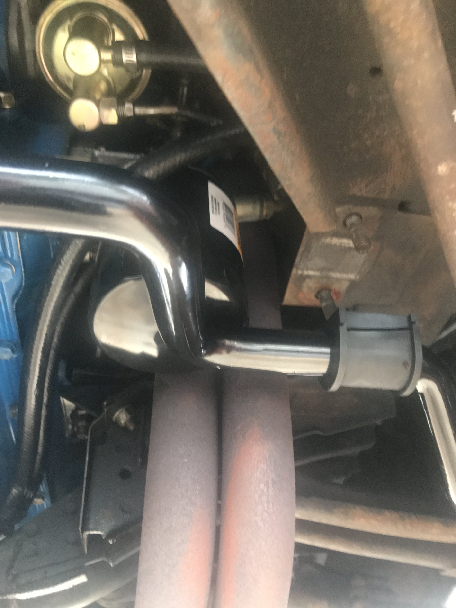

    My luck changed when I went to install the front sway bar. It obviously interfered with the oil filter but I thought that it might fit other than that so I went to the parts store and got a short filter. Well, that wasn’t enough. Even without the filter the bar is too narrow where it goes around the frame. Dang. The listing showed that it fit the Ranchero. It’s an Addco from Summit. Helwig and Scott Drake don’t have one that fits the Ranchero.
    Anybody got a Ranchero with a bigger sway bar on the front? Any other sources?

    While the wind rearranged the patio furniture and the rain took a much needed break, I bolted the sway bar in place and took some pictures and measurements.
    The top of the bar is only 2” below the gasket surface of the factory filter adapter.
    I found a filter byp*** plate on eBay that replaces the factory adapter and has two 1/2” pipe inlet/outlets straight out and bought it. I also ordered a Trans-Dapt relocation kit that uses the factory adapter and features an oil filter replacement fitting that exits at 90 degrees instead of straight down. So I have some parts to work with to get a nice installation. The weather should improve by the time it all gets here.
    I’m not thrilled to have to relocate the oil filter, more junk cluttering up the engine compartment, but these are the little diversions that I’ve learned to expect when I horse around with Fords. It’s still a great car and I’m excited to drive it lowered 2” and with new sway bars.

    The end loops are the same distance apart but the area for the frame bushings is just barely wide enough. The little factory bar took advantage of the space available and wasn’t close to anything. The new bar doesn’t follow exactly the same path. The straight part of the factory bar where the frame bushings go was much wider. The new one seems to have bends in slightly different places and is a little closer to the frame.
    So far that was the only company that said that their bar would fit a Ranchero. I have to admit that I’m not a big phone guy. I do internet searches from several angles and compile the info. So often theses days when I do call, I get a sales person with no practical knowledge of the parts they sell nor any possible applications outside of the product application data that they have. Some of the Mustang parts guys can give you a dissertation on Mustang applications but clam up when you mention Ranchero.
    I held the new bar down a little to see if I could make spacers to drop the frame bushings but it looks like it would take about 2 1/2” or bigger spacers. I’ll take another look when the weather improves. I was fortunate to get a few minutes this morning but it’s been raining and 18-36 mph winds most of the day. I can always return the kit to Summit if I don’t need it but I wanted to have everything on hand to get it back together. I’m getting good at returning sh!t since my steering wheel fiasco.

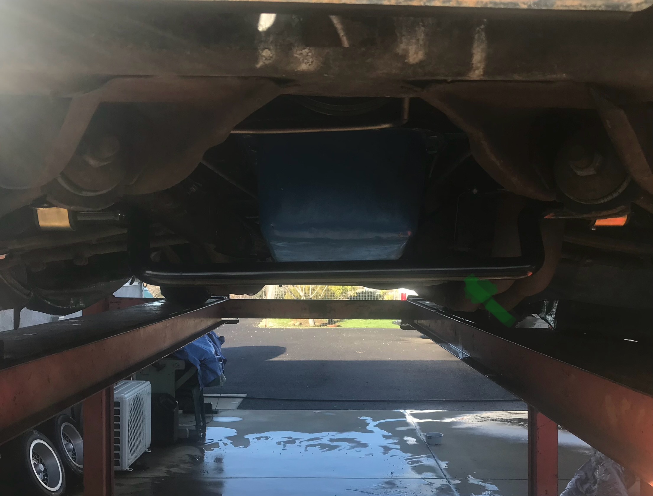

    Nice and clear today so I decided to try one last ditch idea concerning spacing the sway bar down to clear the oil filter. The reason I gave the idea the ki-bosh was because the dip in the center of the bar got too low with the 2” spacers required to clear the filter. But I hadn’t considered shortening the links to the lower A-arms to rotate it back up.
    This is the normal position, no spacer…. (See my lame green arrow)
    This is where the bar sits with the required 2” spacer. Substantially lower…..
    Shortening the links didn’t make much difference, it was still too low and looked goofy. Dang.

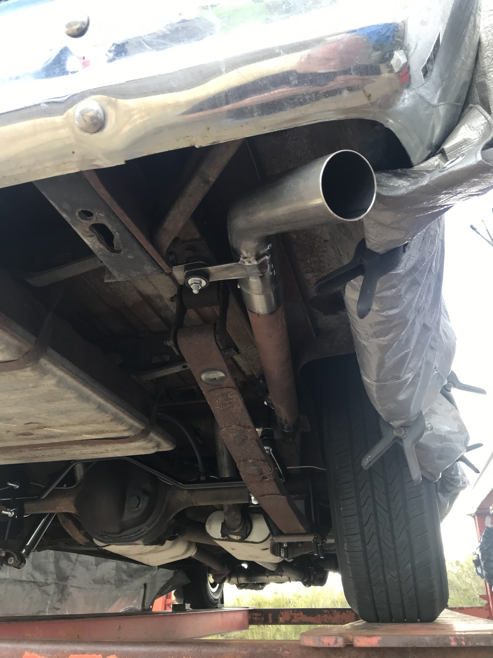

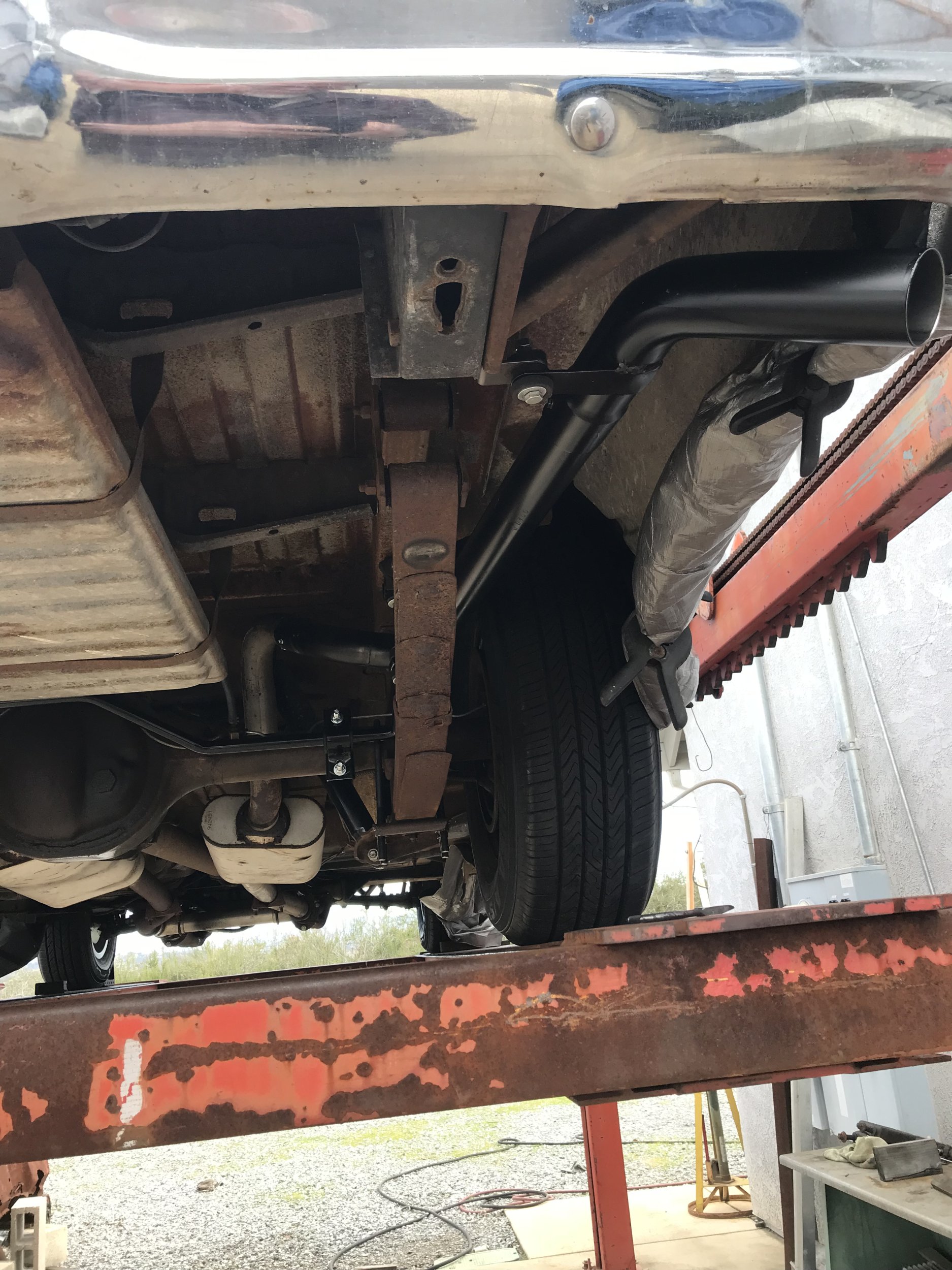

    I didn’t wait for the weather to clear up, I figured most of the tailpipe work was under the car out of the rain so what the heck. I made brackets to support the new tips where I wanted them to end up and clamped a 45 degree bend on each side. That gives me a target to go for with the rest of the pipe. I got one side cut, trimmed and tacked together and the parts for the other side roughed out. Kind of a pain marking it, taking it in the shop, cutting it, taking it back out, marking it, back in the shop,tacking the parts together, taking them back out and checking it be sure they are right. Getting my steps in. Usually I roll my welder out there but not in the rain. With one side figured out, I called it a day.
    This morning I welded up the first side and reinstalled it. I fitted the pieces of the other side, tacked it together and welded it up. With both sides in place I figured out the necessary support brackets and got them welded on.
    I wanted the outlets to be all the way in the back. I decided on the extreme corners with the outlets pointing down and out. (Note the nice weather today!)
    There is a good chance that this will all be temporary, I’m looking at several nice stainless exhaust system kits. The trouble is, as usual, they are listed for Fairlanes but not Rancheros. Maybe the Rancheros and station wagons have a longer wheelbase? More research needed.
    I took photos, cleaned up and went in for a late lunch and some much needed hot coffee. I still need to scuff everything up and shoot some black heat paint on it. I didn’t have enough in stock to do it today.
    Here’s what I got so far, all stuff I had in stock upstairs.
    It would have been easier if the fuel tank was centered, I could have run both pipes inside of the springs. Oh well, this way the tips are out in the corners. Maybe that’s why they don’t list Rancheros with the regular Fairlanes.

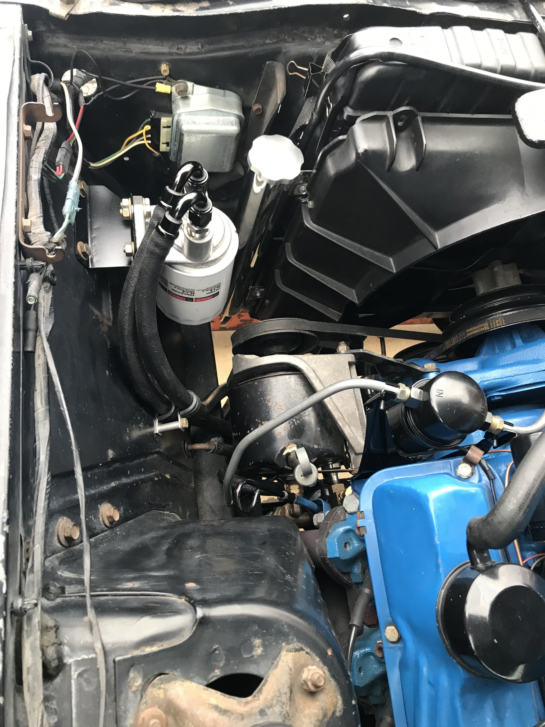

    I got my Trans-Dapt oil filter relocation kit and the main fitting that screws on in place of the oil filter fits great. It includes modern push-lock hose and fittings, way better than transmission fluid hose and hose clamps. I didn’t like the bracket for the filter, it’s too “cheap die-cast” looking for me. I used an old one I had. I also added four 1/2”pipe to -8AN fittings and 120 degree push-loc fittings to make everything flow together nicely and make it easier to service.
    C7F58CBC-BD4B-4DDC-B121-BFA685144111.jpeg 52C6B1D7-4D0E-4335-BB73-52D0B1720489.jpeg

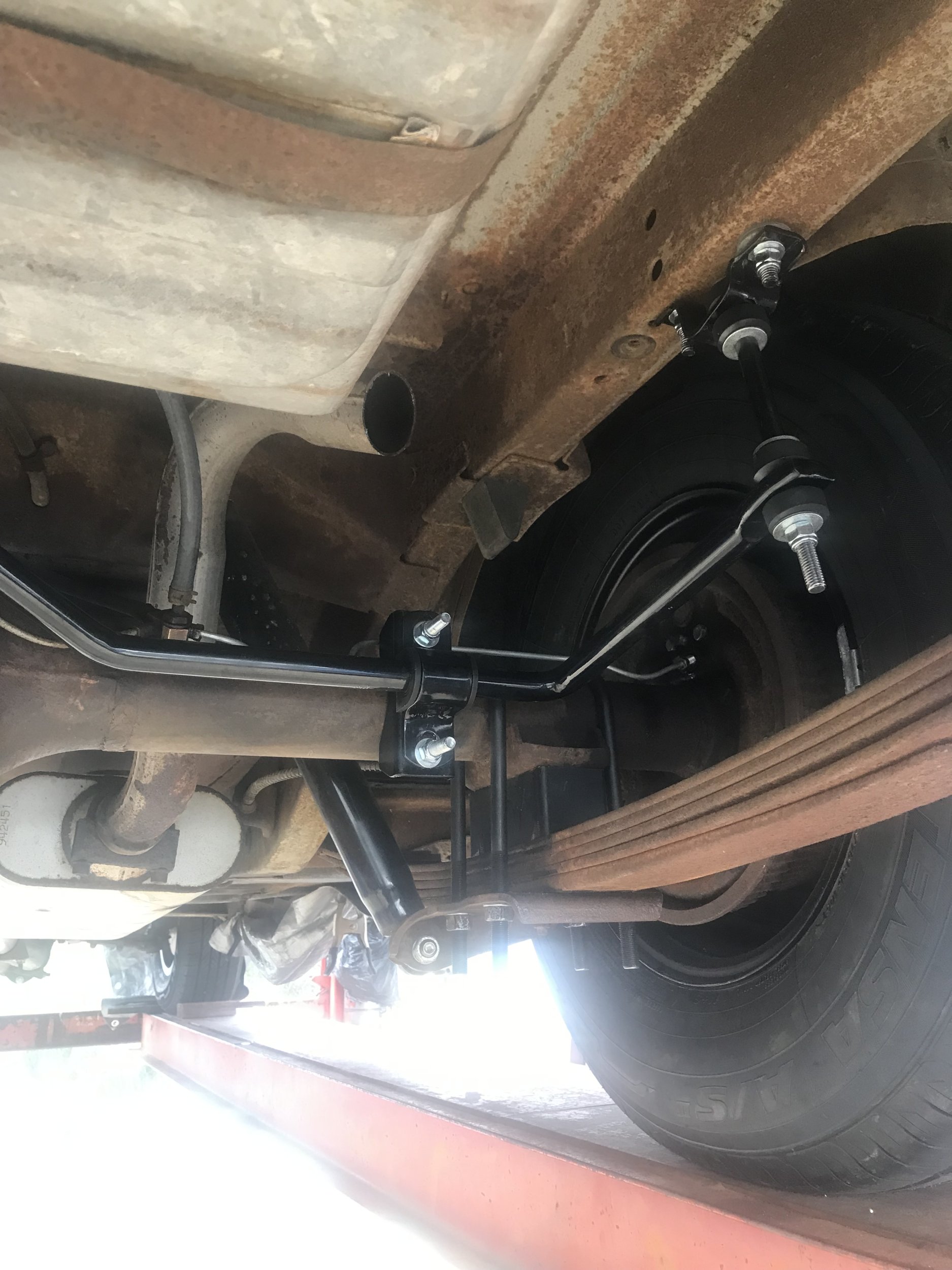

    It took me three tries to get everything to stop leaking but I got it, finally. The sway bar is installed and everything’s ****oned up.
    Now, if the weather holds, a test drive ….
  29. bchctybob
    Joined: Sep 18, 2011
    Posts: 6,614
    bchctybob
    The test drive was very satisfying. The old truck feels firm and stable, no more wallowing around on our windy roads. It reacts with steering input but doesn’t overreact like before. I like the look with the rear lowered 2”, it tucks the tires up in the fenders better. And with the new tailpipes, it’s quieter. I can hear a little wind noise around the doors now. And I hear an axle bearing….
    My work was rewarded, I liked it before, I like it even more now. Next up, new axle bearings.
