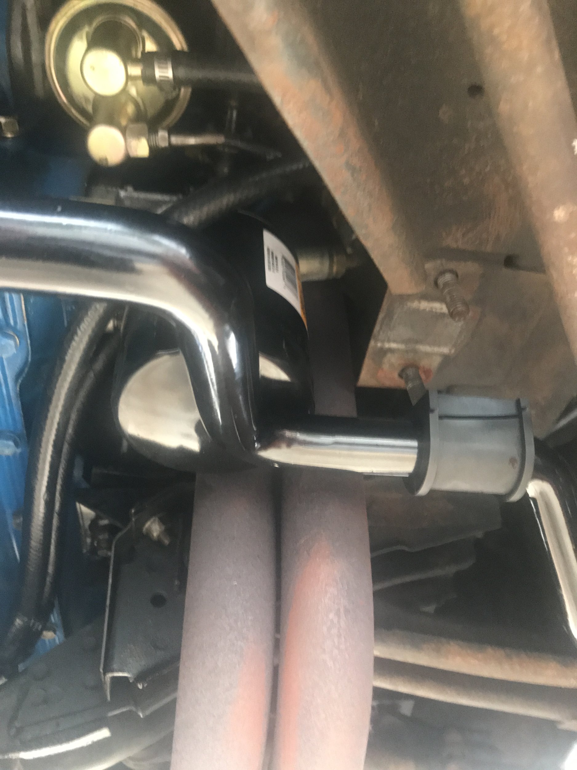

    Thanks. It’s easy to change the filter too, have to have a little catch tray under it though or it gets messy.
    There’s only about 1/2” between the tire and the front edge of the wheel opening but plenty of room everywhere else. If the wheel had another 1/2”-1” of backspace I could go even bigger, but no need to.

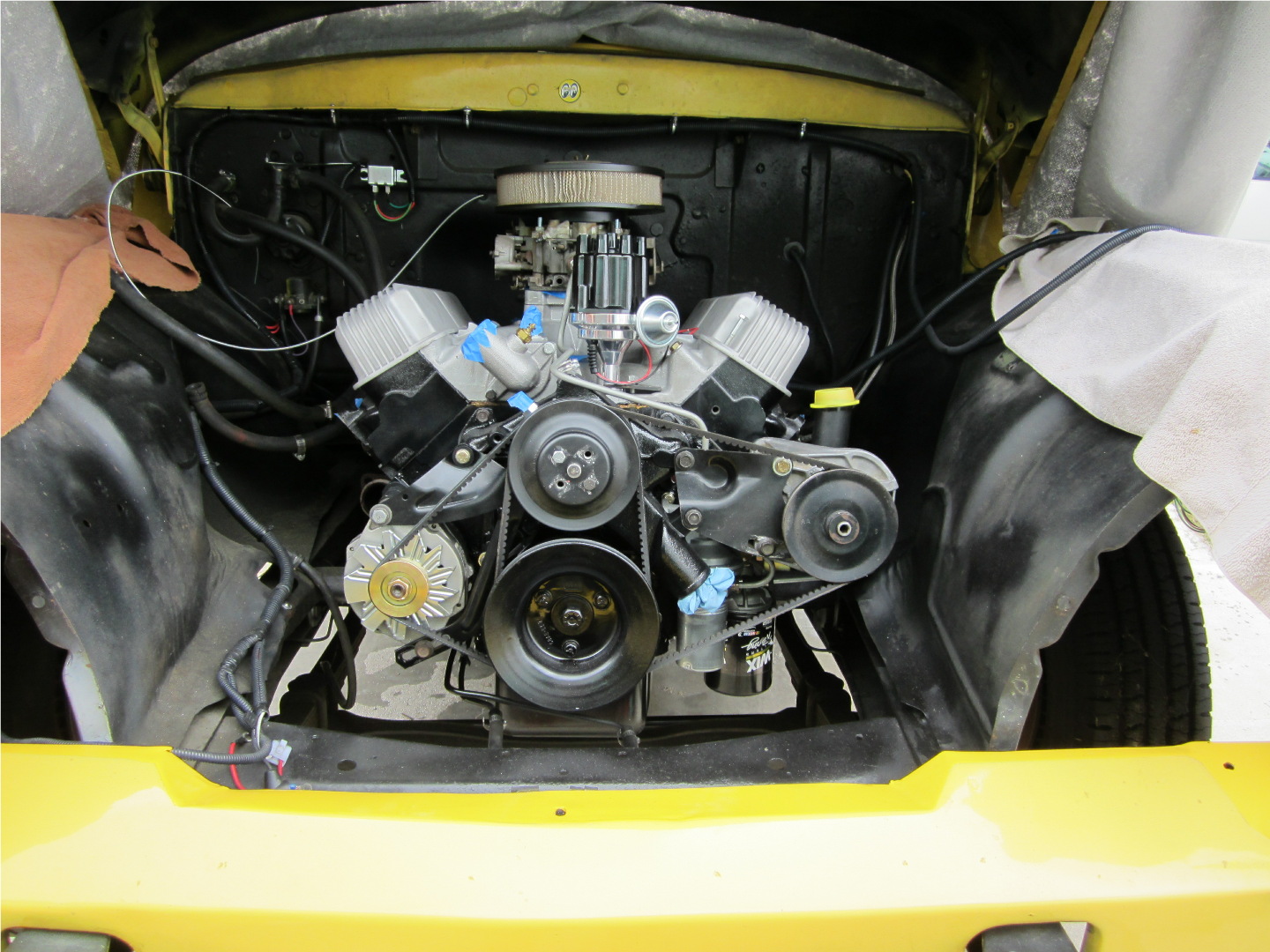

  14. I used a Heidts p/s regulator I got at a swapmeet for my one and only venture into the FE void. My '54 panel truck had a 390 and a C6, here's some random pics. 10 si alt with Tbird brackets and a S/W sending unit in the t-stat housing.

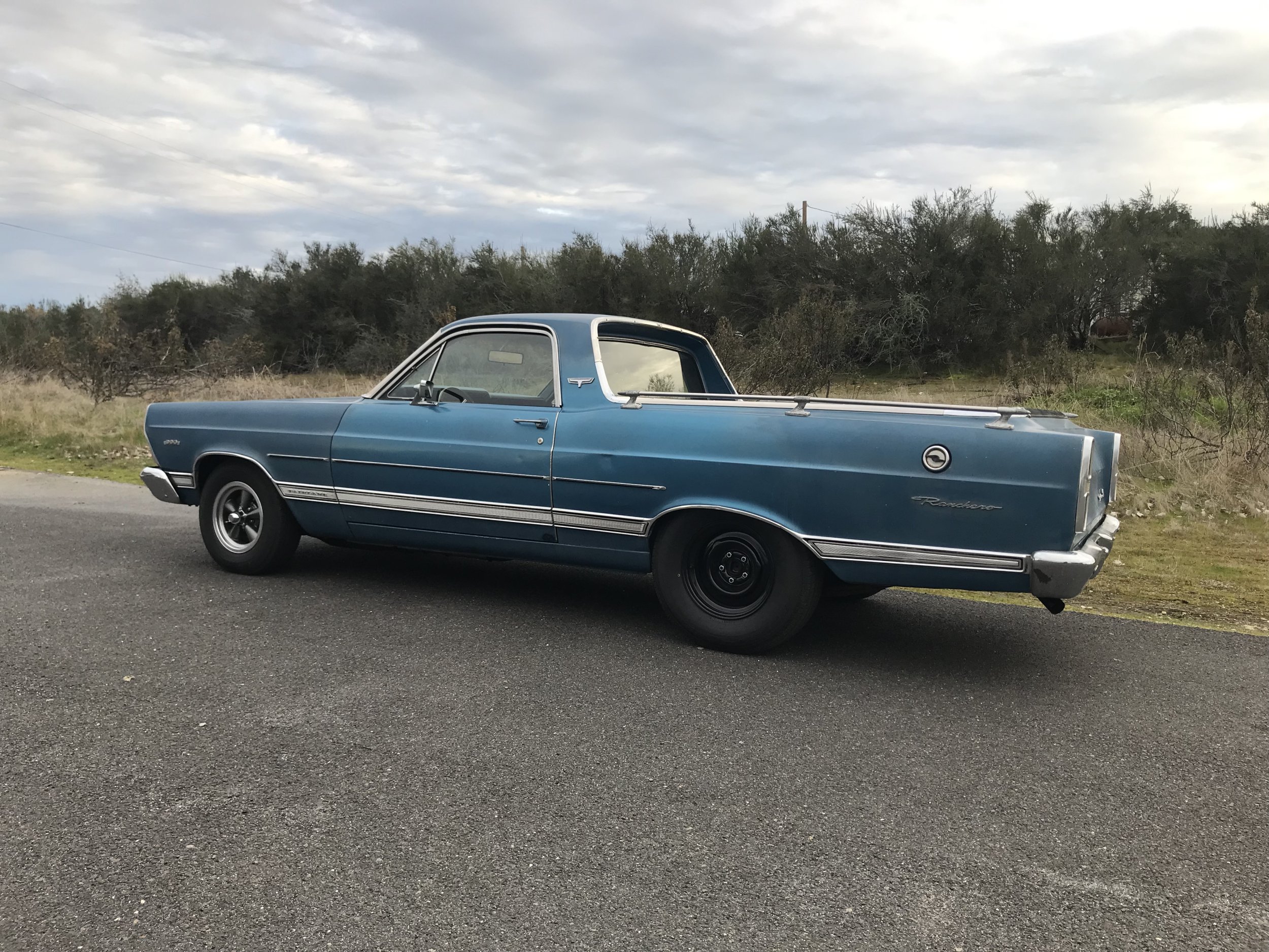

    The Ranchero has been running and driving fine lately. It still seems pretty lazy “off the line” for a big block car though. It has the standard 3.25 ratio in it now. My taller rear tires probably don’t help. It feels like it needs 3.50 or 3.70 gears. That would mean going to an overdrive transmission though if I want it to be comfortable on the highway. I put a non-computer AOD behind the 302 in my Falcon years ago and was happy with it. What are folks using behind FEs for a basic street OD trans these days?

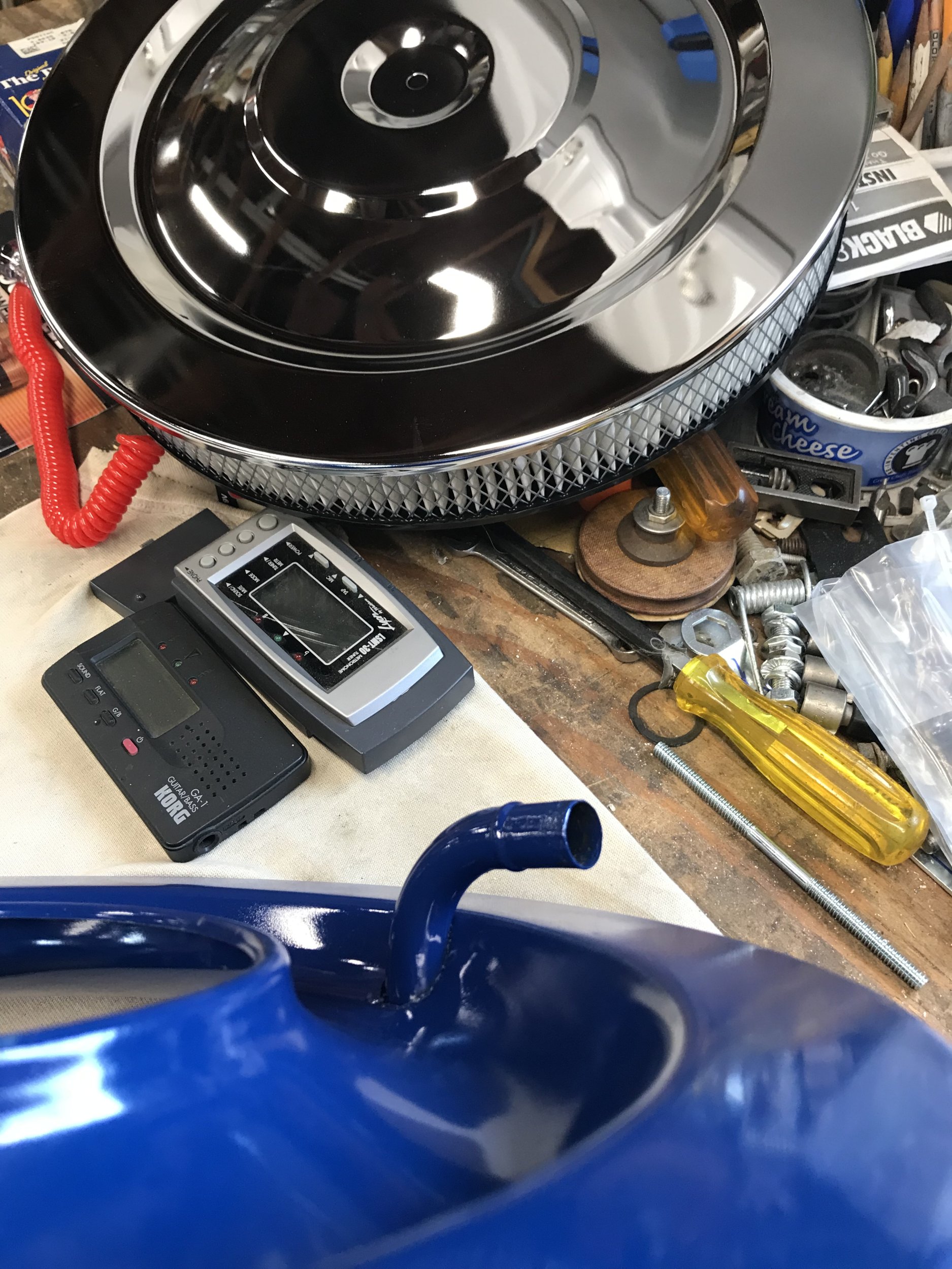

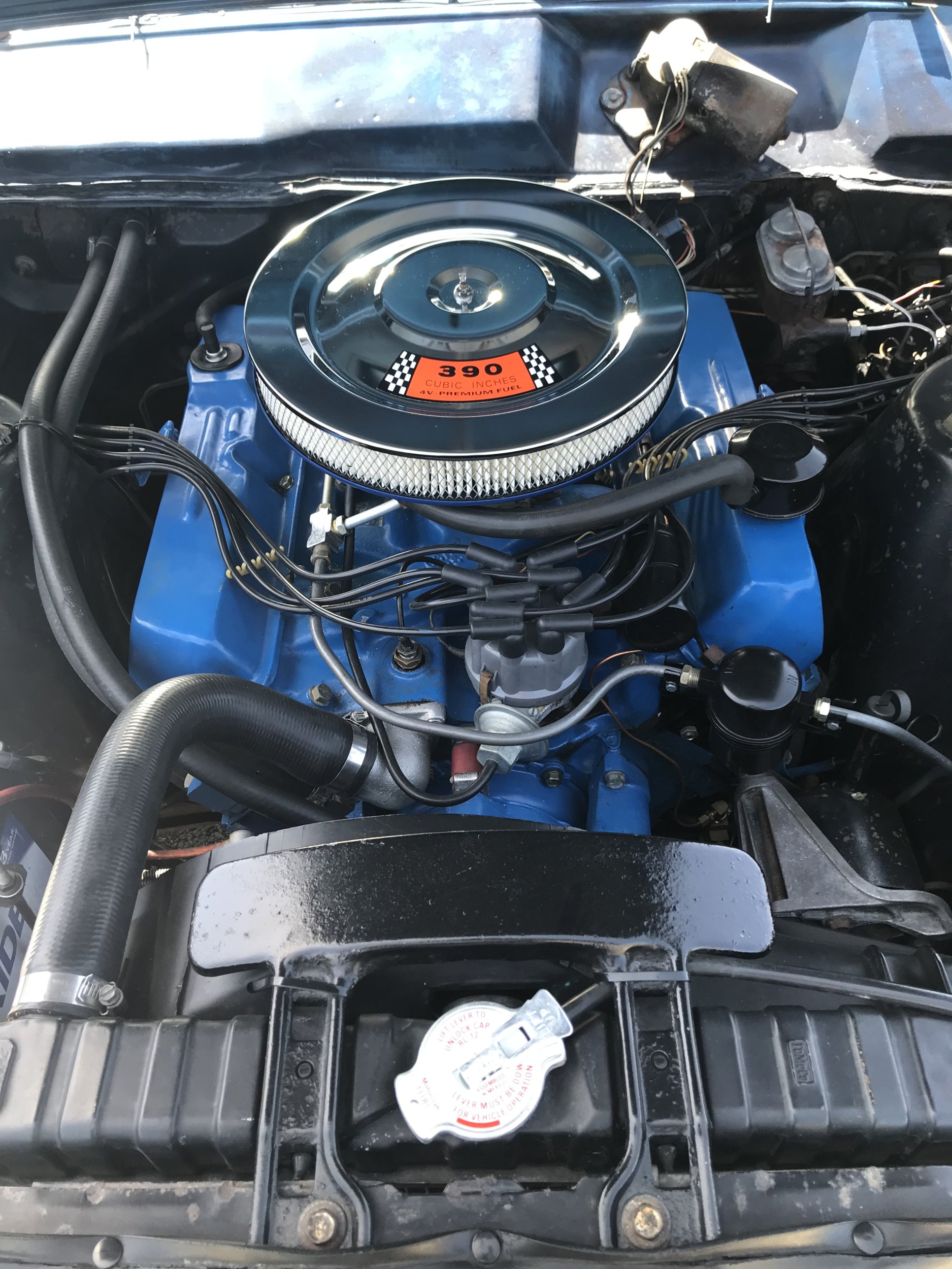

    I wanted to pretty up the engine compartment a little so I ordered a Mustang style chrome air cleaner. I’m wondering if the open element will improve the performance a little as well. They provided a straight plastic fitting for the PCV hose but that wouldn’t work with my dual feed Holley. I had an elbow in my junk box that was just right. I placed it so I can use the same hose on either the stock air cleaner or the new one and welded it to the base.
    I’m thinking of having the top of my factory air cleaner chromed and modifying it to look like the factory high performance version. If this one stays on for long I’ll add a better filter element.
    Just picking away at some little things. I also ordered a shift improver kit for the C6. I sat and studied the parts and instructions, it seems straightforward so I’ll tackle that project as soon as I feel like wallowing in ATF.
