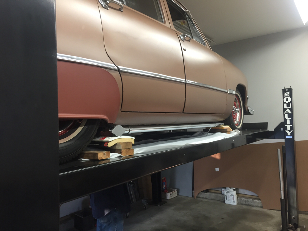

    ImageUploadedByH.A.M.B.1429706907.084329.jpg ImageUploadedByH.A.M.B.1429706917.352979.jpg
    Making progress.
  11. How much space do you have between the rocker & the ground? And lake pipe to the ground? Just curious how your car compares to mine. Looks good so far

    The pipe is probably 4 or 5 inches off the ground. All I know is it's higher off the ground than I have suspension travel. I just have to be careful around curbs and speed bumps. I'll find out what I actually have for space later.

    ImageUploadedByH.A.M.B.1429832588.246451.jpg ImageUploadedByH.A.M.B.1429832599.350415.jpg
    They're in. Next is actual exhaust.
